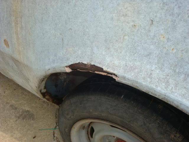

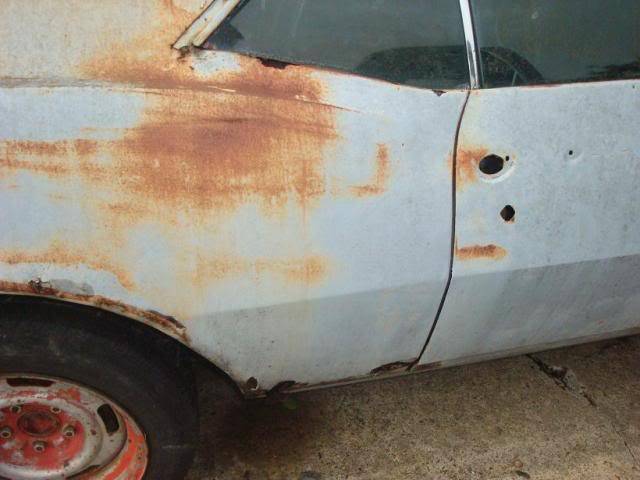

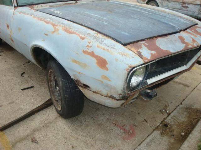

      I picked up a 68 Camaro over the weekend that has had alot of crappy work. We are going to end up replacing almost all the body panels anyways so I was thinking about just buying all 69 fenders, quarters, doors, front end. Is there anything behind the bodypanels that will not allow me to switch to the 69 parts? Is it best to try and keep some of the stock bodypanels for fitment or just go ahead and replace everything?

      Looks alot like my '68 when I got it. Outside of all external panels you would also, at the very least, need the 69 outer wheel houses. if you're needing to do a quarter, you'll likely need them anyway.
      With that said, I'll be the first to ask why. You will totally kill your resale. Potentially in both value and time to sell. '69 guys won't want it because it's not a true '69. '68's wouldn't be interested due to appearance.
      If you're that dead set on a '69, I would wait until I found one. if you're able to do all the panel replacement you can easily find a clapped out shell relatively cheap.
