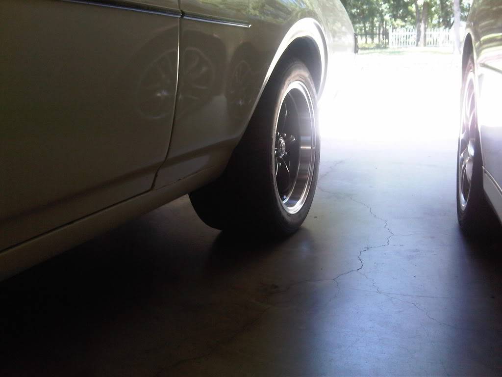

      they are nitto nt555s. They measure 12" wide.
      These pics are with the new springs

      did you think of shaving the lip of the wheel well a bit?
      Feb 2008
      Texas
      302
      yeah I did. That probably would have fixed it. I like the new springs better though, a lot stiffer than the eibachs. The new ones are global west. Oh and having the rear raised more makes the tires look wider.
