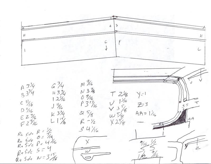

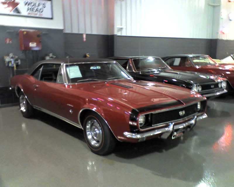

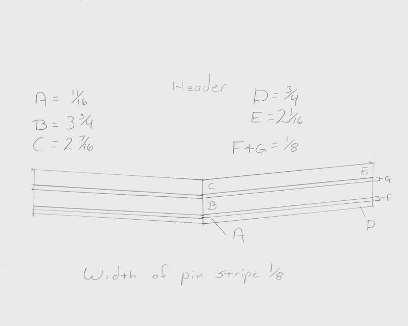

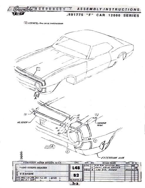

      I don't know about you, but the stripe sheet from the build book, I find a little lacking. I went to Skillmans Classic Cars where they have an actual untouched 1967 Camaro SS, and I did actual measurements at all points, or at least enough so you can do the stripes yourself. Did you ever notice when you go to a show, Every SS has stripes that are all their own.
      This is an actual Untouched car. You have got to love it for information.
      I have sketched as best as I can on site, I also included the actual rough sketch with measurements. Please ask if there is any questions.

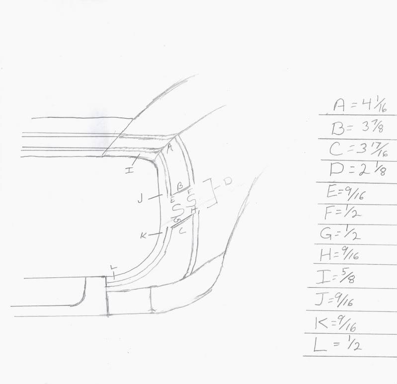

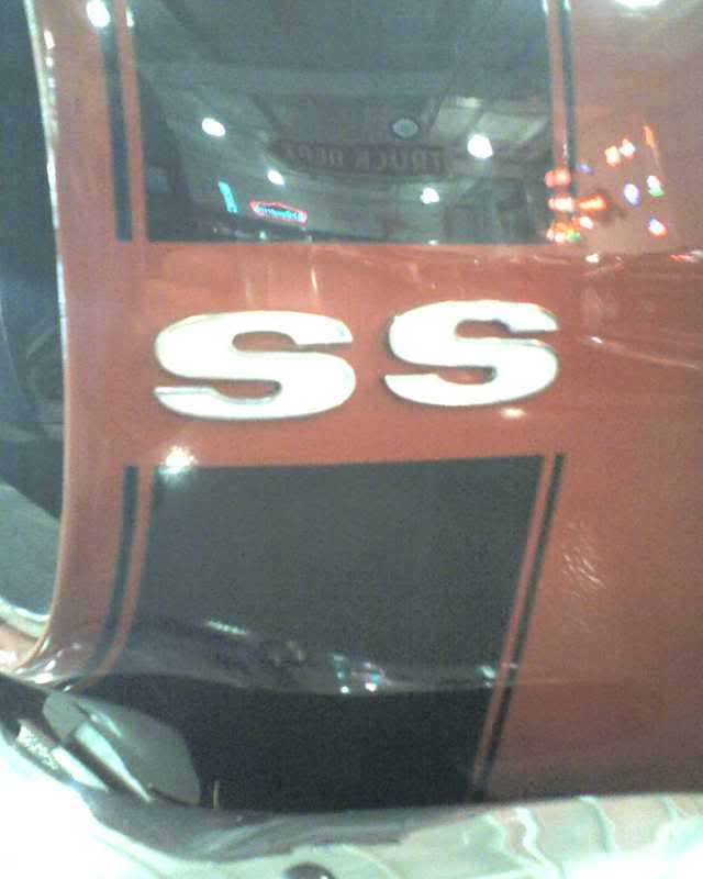

      Looking at the stripe around the SS
      the gap over the front S is 9/16
      the gap under the front S is 1/2
      The gap over the second S is 1/2
      the gap under the second S is 9/16
      The opening for the SS is 2 1/8 front and back between pin stripes and between Main Stripe.
      If you get a chance, You have to go to see this. It is a Secret spot in Indiana that is a car show in itself. You can enter without a ticket or invitation. Free Car Show every day. You can also see it on line by clicking the link below and use the arrow to go through Ray Skillman's private collection.
