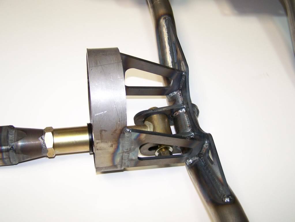

      What keeps that forward torque arm bolt from eating up that slotted hole as it slides around?

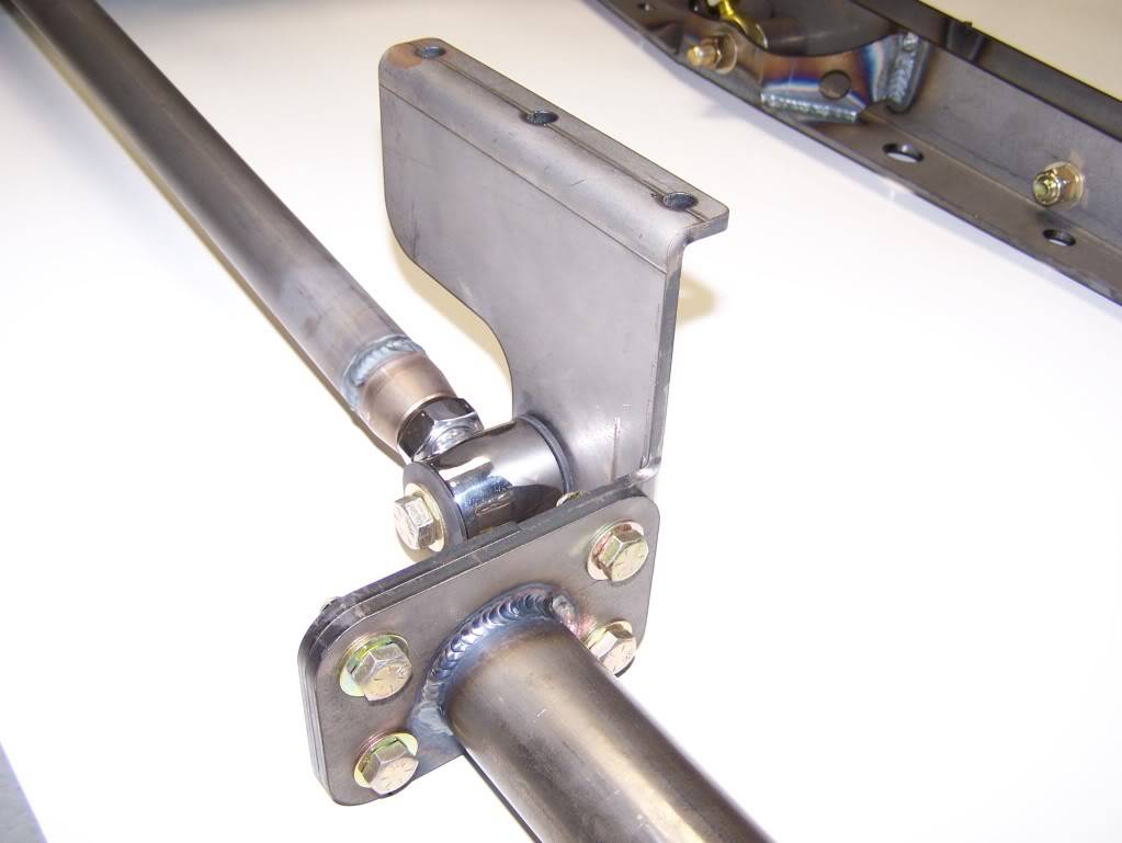

      Is the LCA chassis mount in single shear?
      Batesville, IN
      908
      Quote Originally Posted by falcon65 View Post
      Good question. The only thing that I can think is that it uses the inner side of the leaf spring mount on the car, but not sure.
      I'll have Sal chime in on this one.

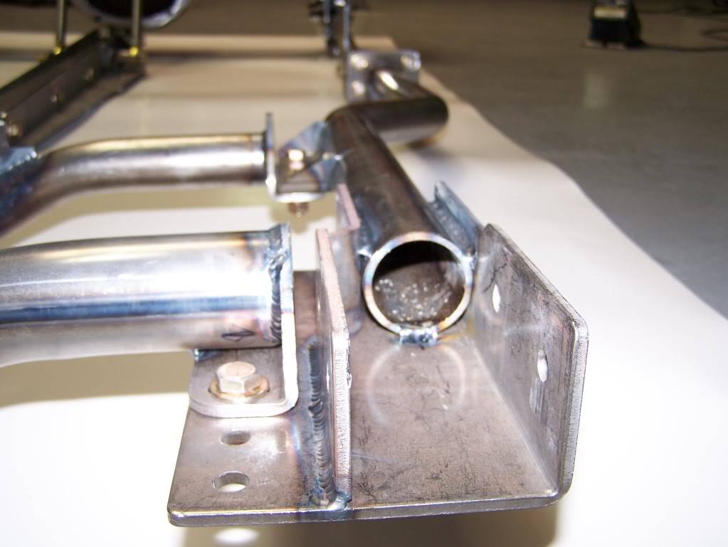

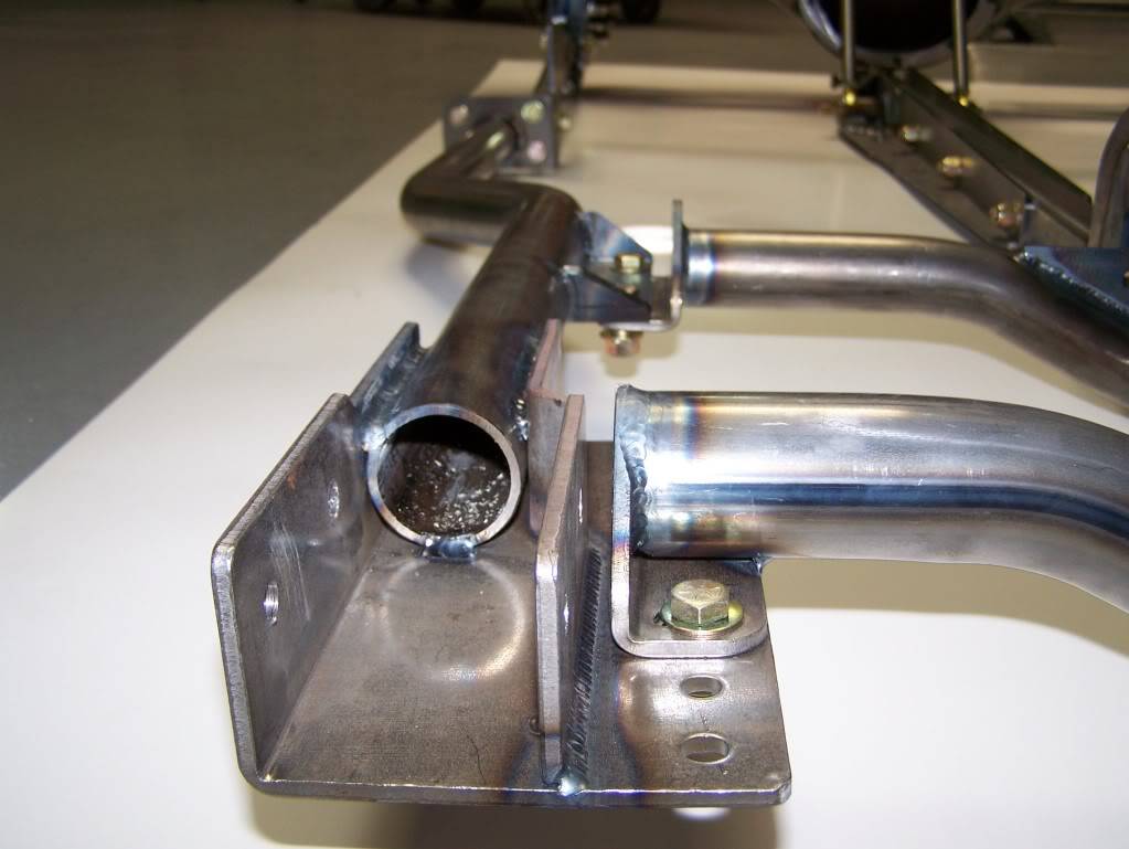

      Hi Here some answers to some of the question that are posted
      1 Torque Arm slider adjustment on crossmember
      The slot was designed for wheel base adjustmentS. with the 1/2" bolt and 1.280" slot that leaves about 5/8" adjustment to center the wheels.
      2. The telescoping slider end has 1 1/4" of travel . When we cycled the suspension from full droop to full bump the slider only moved .200". The arm itself is a lever trying to go up. The two side bars do not allow the rearend to come forward anymore than the .200" plus the small amount of deflection in the bushings.
      3. The lower bars are in double shear brackets up front. We used half of the stock spring hanger and made a bolt on bracket to support the opposite side. The subframe connectors are mounted directly in front supporting any forces coming from the two lower bars.
      -Sal

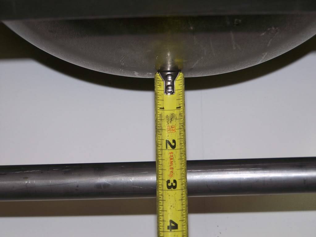

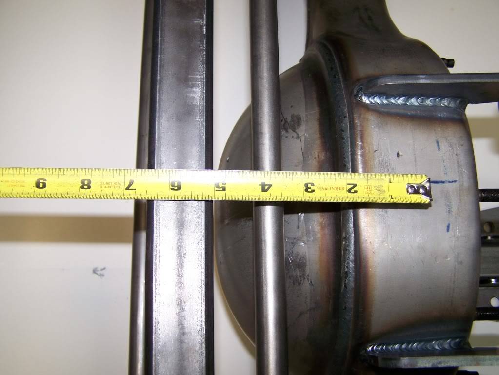

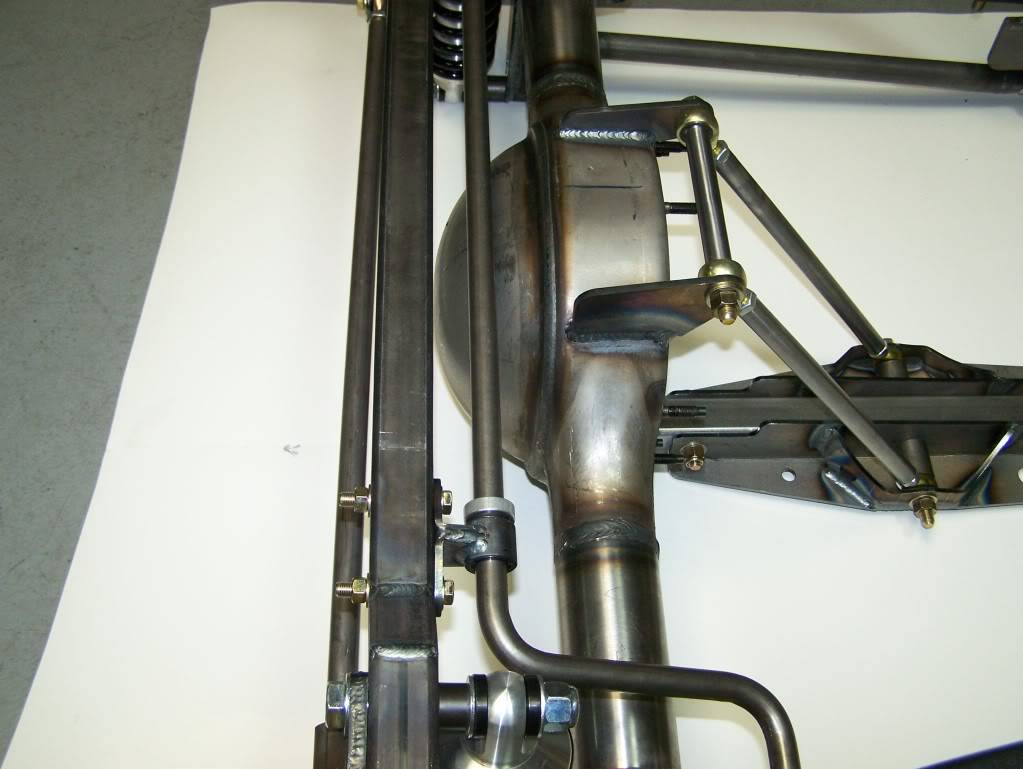

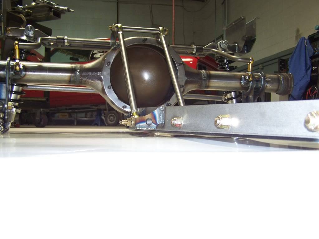

      Some guys on Steve's Nova Site had some concerns about stock gas tank clearance so I took some more pics.
      The rear most point of the kit is the panhard bar but it hangs below the tank even at full compression. The coilover crossmember was the only concern when making enough clearance for the tank and there is plenty. :yes:
      This measurement is from the axle centerline to the back of the coilover crossmember.
      This is from the back of the pumpkin to the panhard bar. I had to lean the camera angle back a little but it was right at 3"
