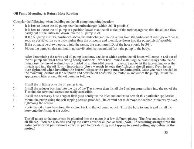

      Here is the oil pump page out of the STS instructions. Hope this helps. Let me know if you need any other sections...
      Phillip

      Thanks fgor the instructions.
      the pump will be just near the turbo, with a short 10-AN line, under the oil outlet level of the turbo.
      Did anybody had problems or experience with vacuum being made by the pump and damaging a turbo? could it not cause damage to the bearing?

      If i read those instructions correctly, there is a 3 psi switch on the inlet of the pump. If this is for the pump relay, the pump wouldn't come on unless there is atleast 3 psi on the inlet. there would not be a vacuum on the turbo as the pump would shut off at anything lower than 3 psi. Does this sound right?

      Is that possibly the warning switch? I know the system has a warning to let you know if you have lost oil pressure to the turbos...

      Or a warning switch, in case the pump does not work, in order not to fill the turbo with oil and send it in the intake?

      I think this makes the most sense. i didnt realize they had a warning light.
