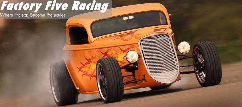

      I'm kinda liking the 33 Hot Rod....

      Quote Originally Posted by RSX302 View Post
      Agreed.
