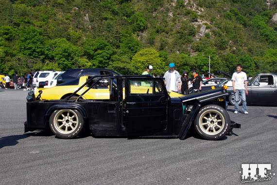

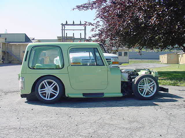

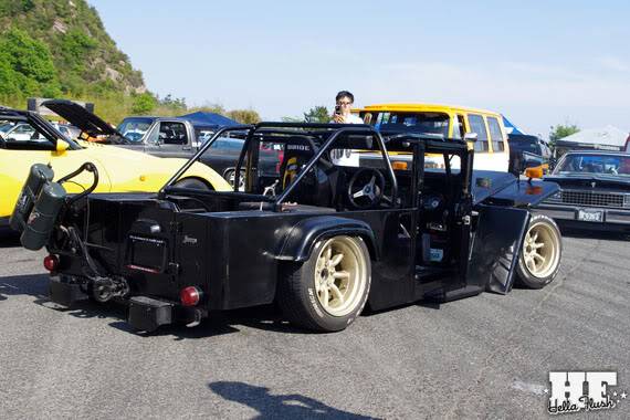

      This what I'm talkin about........
      http://www.youtube.com/watch?v=AmKIC...eature=related
      Another fine example
      http://www.youtube.com/watch?v=JAuRv...eature=related
      A couple more for your veiwing pleasures
      http://www.youtube.com/watch?v=Vwe5t...eature=related
      http://www.youtube.com/watch?v=xVL1N...eature=related
