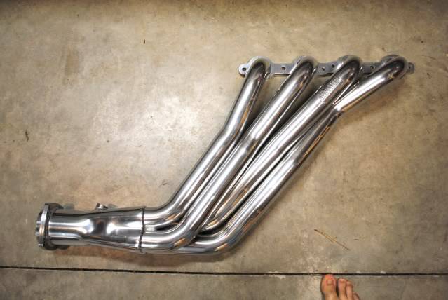

      I may be able to get a discount running for a group purchase on the dynatech headers. It is in the works to see if I can get 10-15 sets made in stainless. A price has yet to be set for the stainless version. If anyone is interested PM me...

      I will save all PM's and try and keep track of the people that are interested. I am still waiting for the final ok on the stainless version. They will be made exactly the same as the ceramic coated in the thread and will clear the manual clutch unlike most others. I will keep everyone updated as soon as I hear something!!

      I have a set of Hookers that are Jet-hot ceramic coated in/out that I used on my 69 that I'll sell for $400
      Used for less than 200 miles. If interested drop me a pm and I'll send pics.
      I used ATS mounts and Hooker plates.
