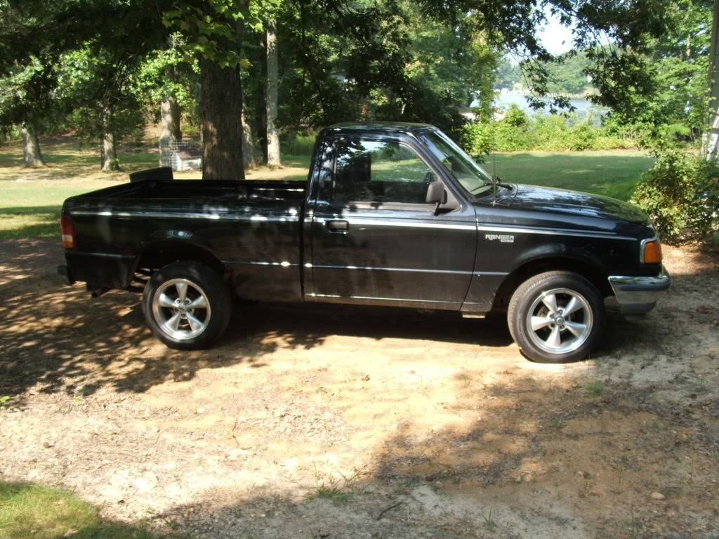

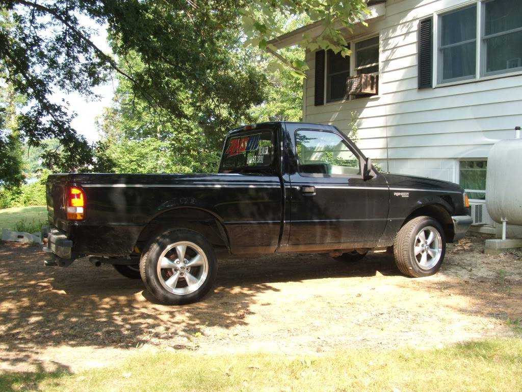

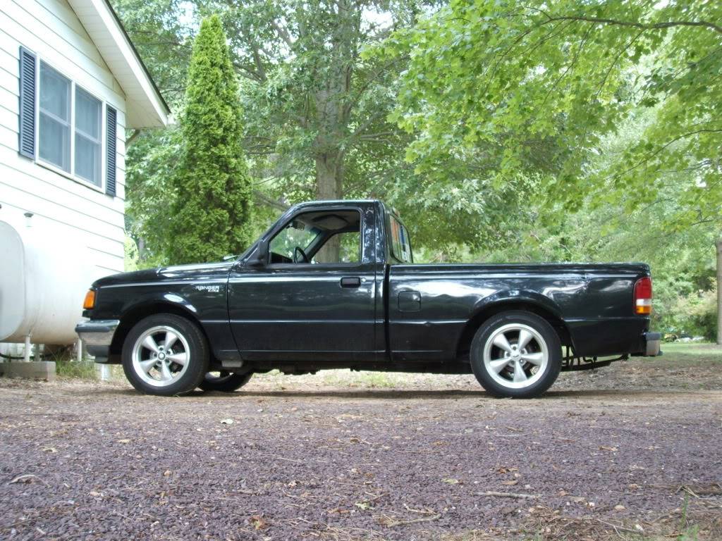

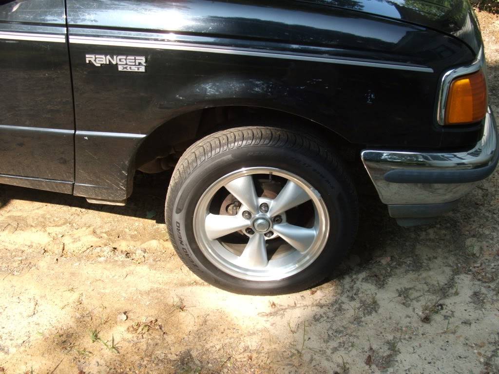

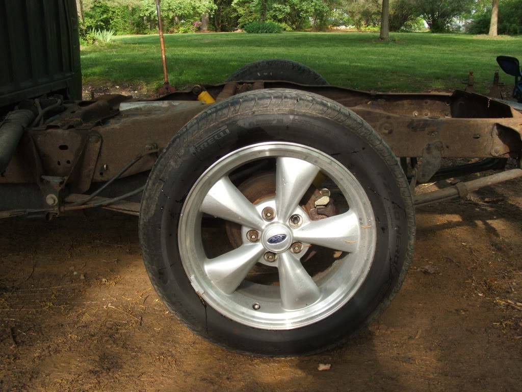

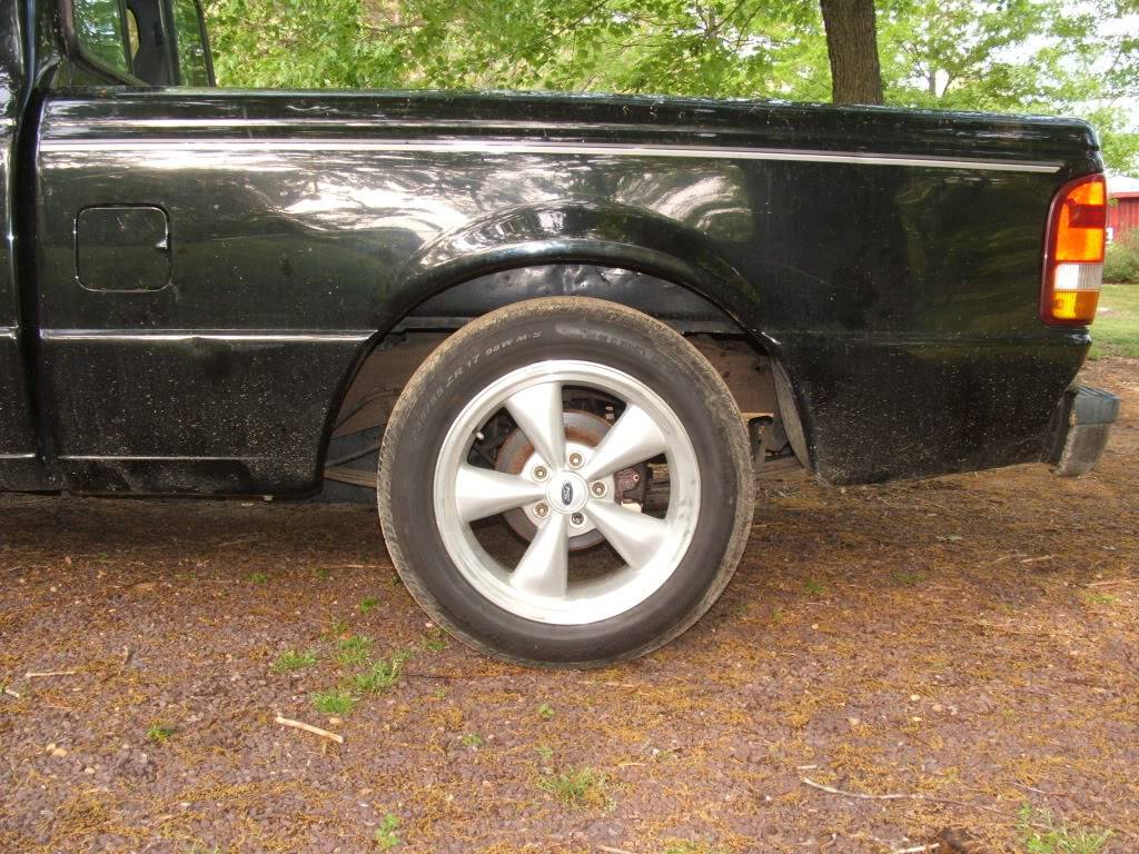

      Wheel pics, I think it makes the truck look like it's on stilts so lowering is in the near future. I haven't done any suspension mods yet but soon.

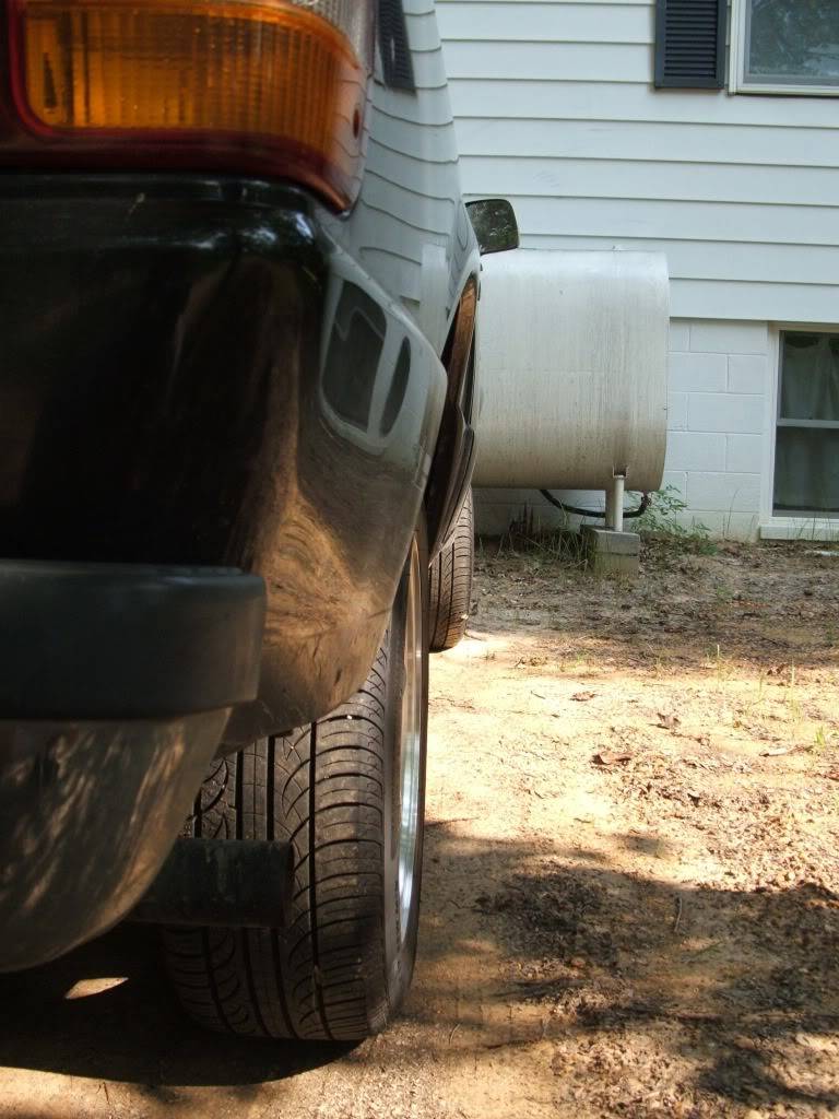

      This is how far they sit in, I think they would be better about 1"-1 1/4" out. It will also let me install my front cap and should solve my rubbing problem.
      The explorer wheels I picked up for a song;
      Birmingham, AL
      3,355
      Looks good. The Explorer wheel looks pretty cool too. That wouldn't have been on my radar.

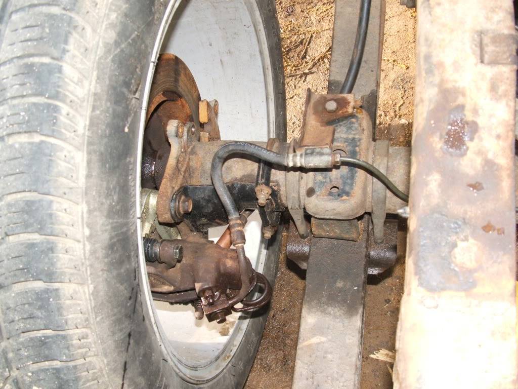

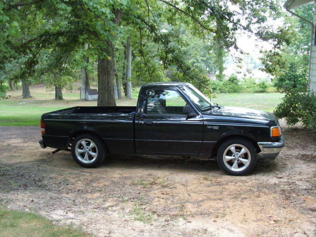

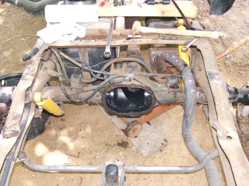

      Got the thing lowered. The flip kit in the rear turned out to be a bear and was not fun. Really made me think twice about continuing the build it was so bad. I have about 10 hours in the flip kit alone. All four leaf spring bolts were rusted together. The rear two came out after about an hour each of working on them. the front two I managed to ring off about an inch in the sleeve with a 4 foot pipe/breaker bar. The right side I manage to pound out with a full size sledge. The left side I ended up having to cut the nut off and pull the spring, tried to get what was left of the bolt out on the bench but ended up drilling the rubber in the bushing out and getting a new bushing. I was worried that the bushing would be hell trying to get in but I put it in the freezer overnight and it slid right in. I just took a coil and a half off the front springs. It should equate to a 2" drop, the max you can get an alignment on with the ibeam suspension. Dropped beams are next as it sits an inch low in the ass of the truck. Pictures of the stance now below. I think it looks much better and am pleased now with the tire height even though it throws my speedo off by a couple mph. I'm still not crazy about the wheel design but it will do until I can get a nice set of billets in the future.
      I ended up selling my mustang axles for $100 but shipping ate up almost $30 so after the dust settled I made just under $70 on them. I still need to get some wheel spacers to correct the offset on the mustang wheels. I need to get my rear disc conversion done and then I'm not sure which way to go. Are there any other easy handling mods? Are 12" brakes front and rear going to make that big of a difference? Or should I now focus on more power?

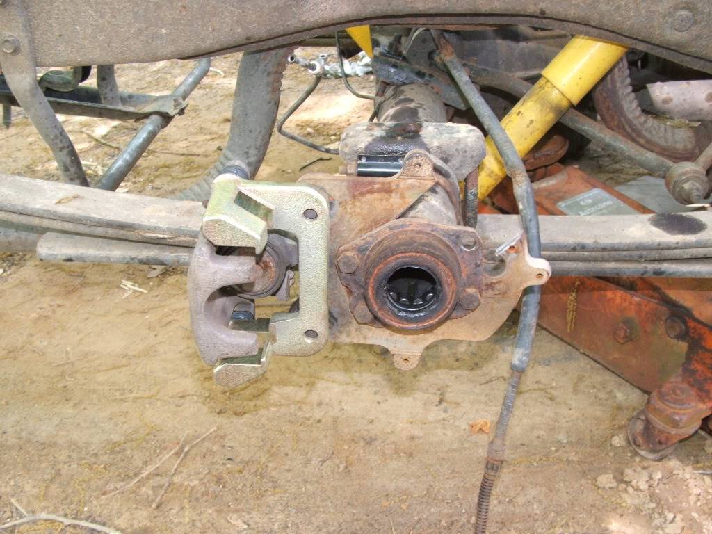

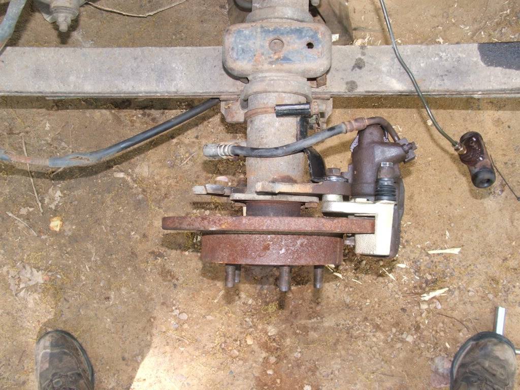

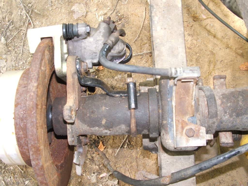

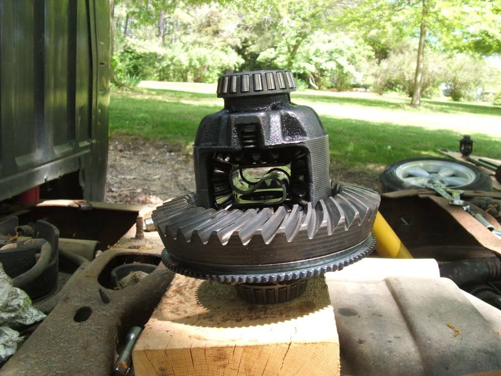

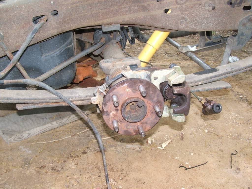

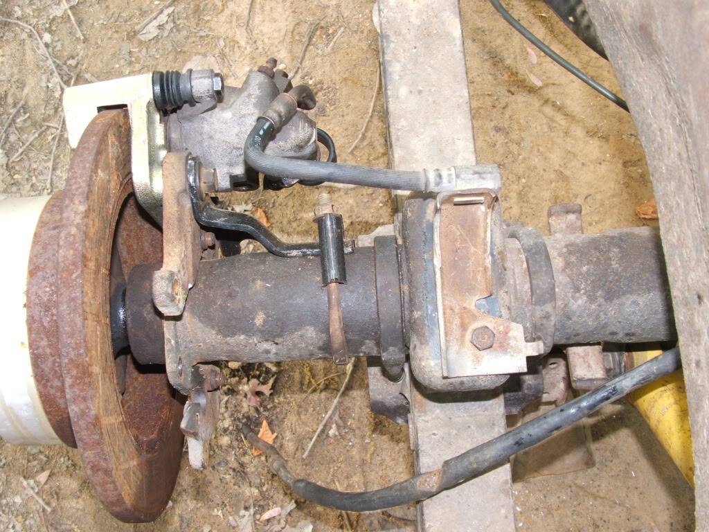

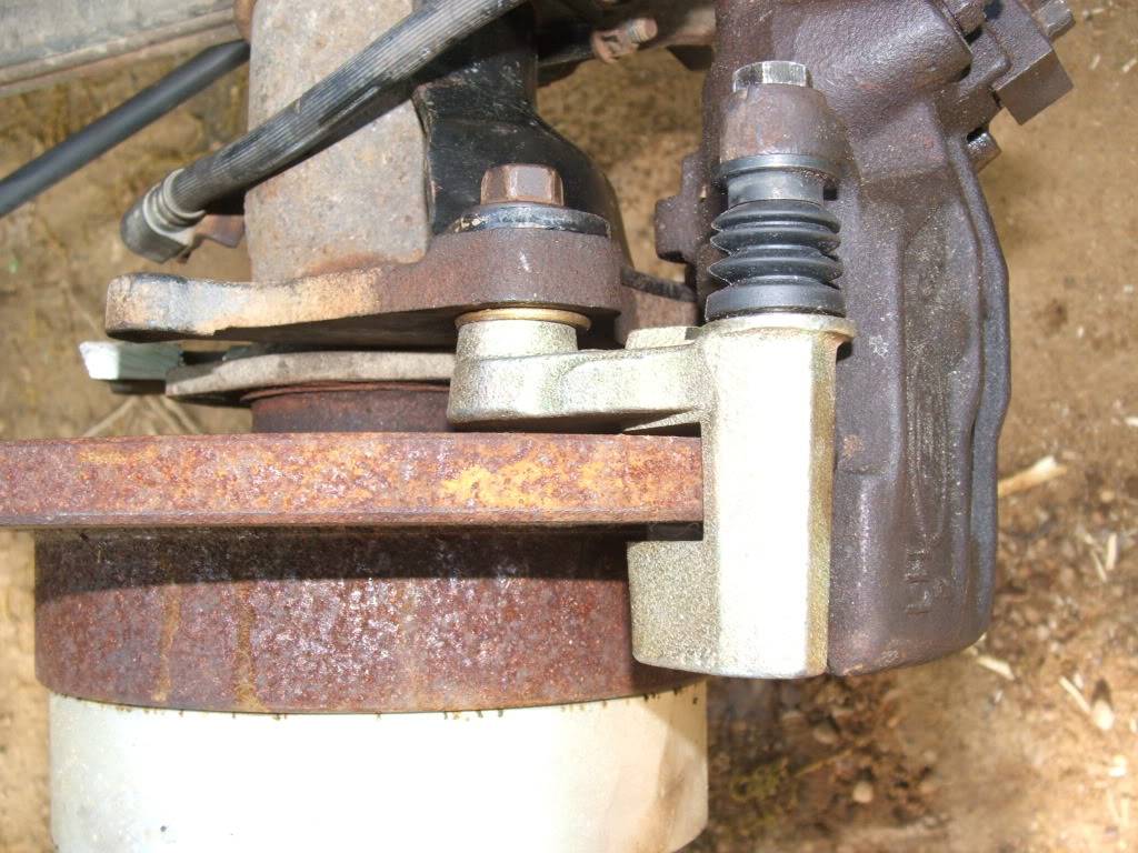

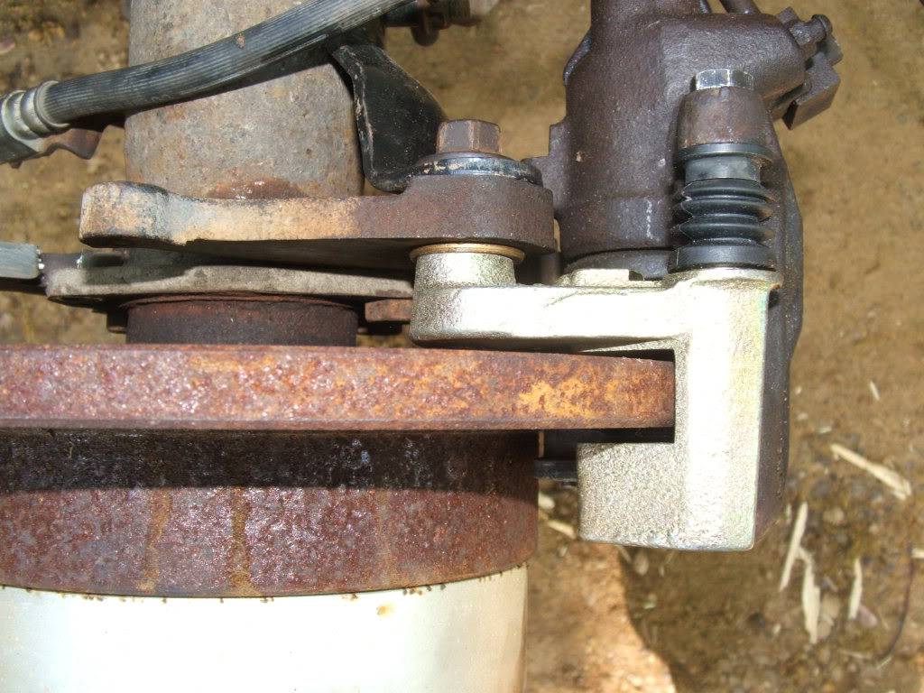

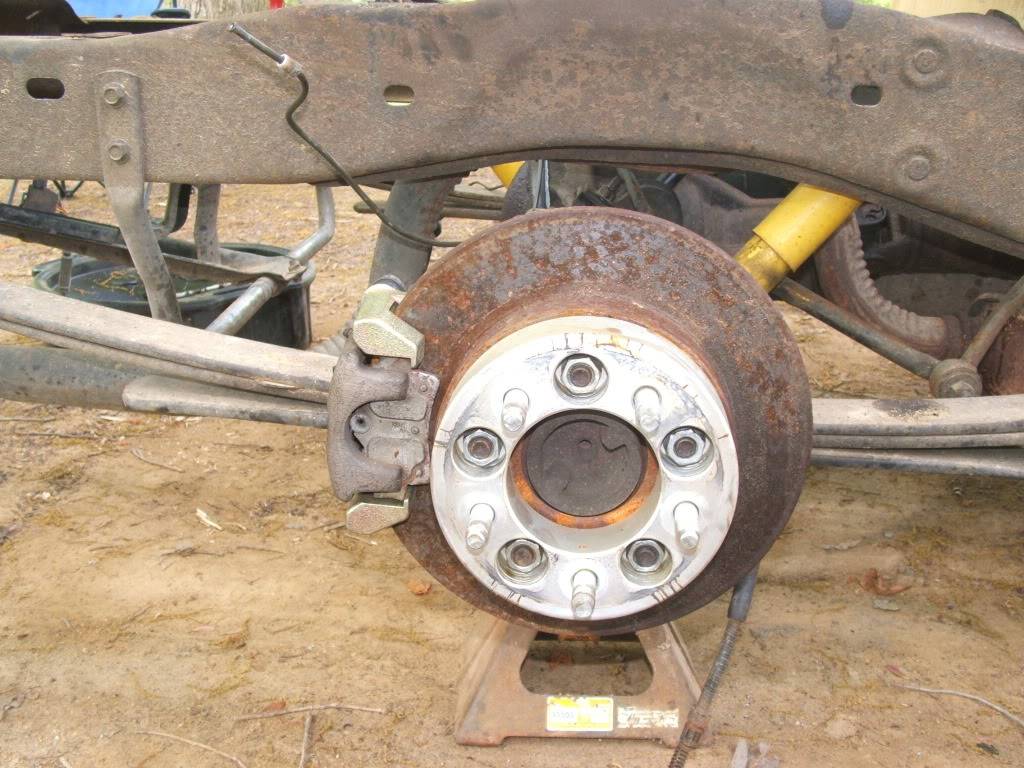

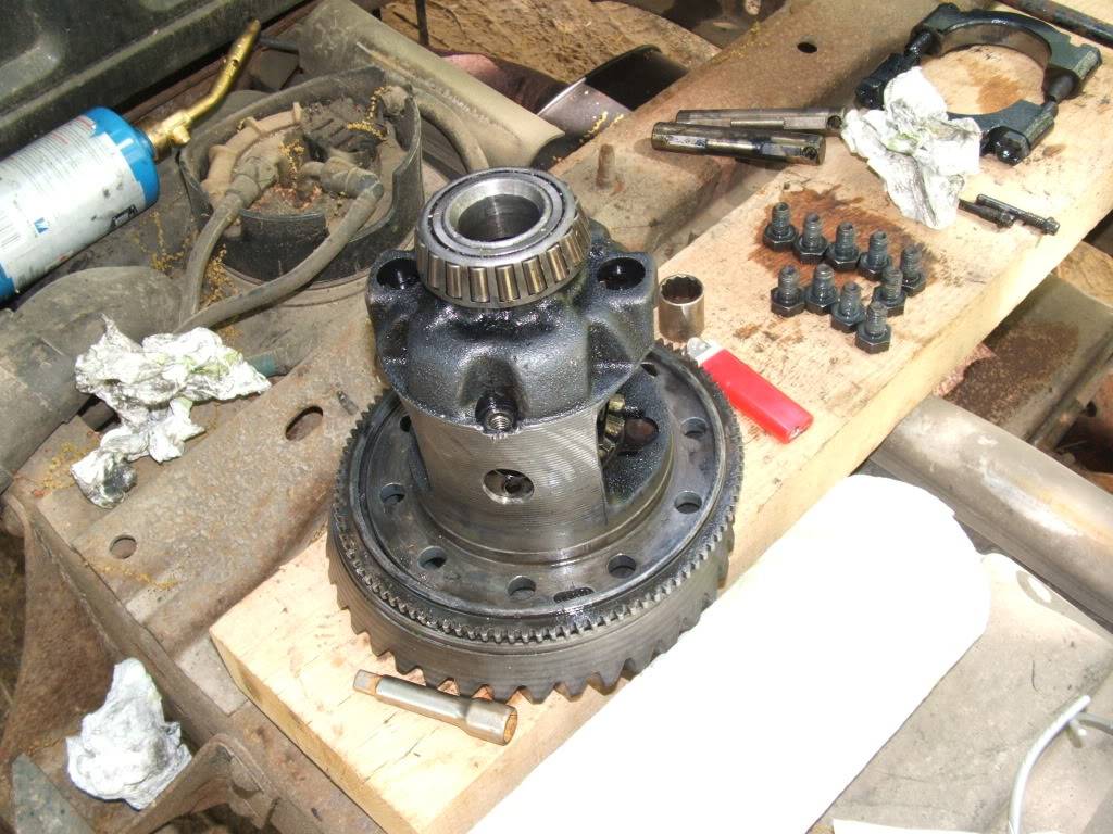

      Lets see, been a while since I updated. I have gotten 1 1/2" wheel spacers to correct the offset of the GT wheels. I think the increase in track width helped stability. I finally got my rear disc swap done, don't have to worry about the drums locking up anymore. Also installed a trac lok at the same time. That improved driveability quite a bit. Wet weather is no longer an issue. The anti lock exciter ring gave me hell and ate up most of my day, but finally got it back on there. I also found that my sway bar was hitting the rear housing. Took my grinder and cut off wheel and lopped the ear it was hitting off. Also changed diff fluid. Picked up some cal vu mirrors in the last couple months. Next upgrade is front brakes. As you can see I work on junk in the dirt. So to recap I spent $125 on the mustang rear. I sold the axles for a profit of $70 and the housing for $25. I still have a 8.8 trac lok diff I should be able to get $100 for. I spent $65 on the used diff i put in. So I pretty much break even. I do have about $30 or so in brake and diff fluid.
