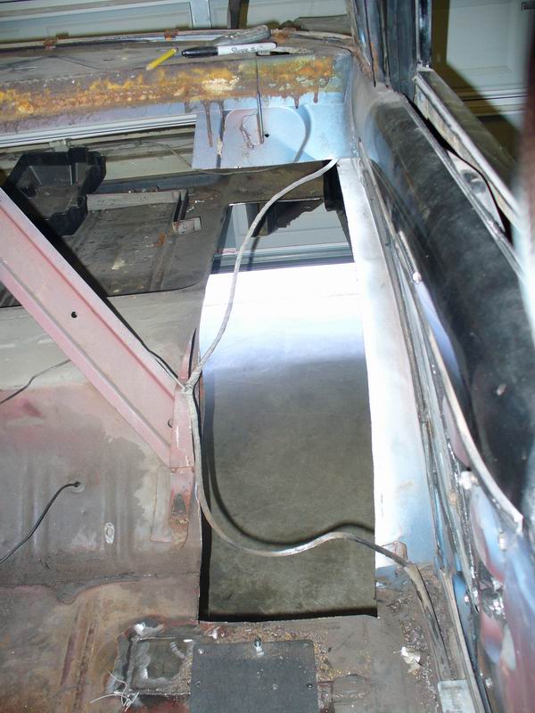

      Finally finishing up the mini tub and rear suspension. Just still kicking around the idea of making the 4link a 3link as well. That way i can switch between the two as needed. Here is some pics for ya

      Did you move those rear frame rails in?
      How much rear tire you putting back there?

      Yes, i moved the rear frame over about 1.5" and add 3" to each tub! after measuring the insides of the tubs i decided to cut the outer wheel wheel an square it up. In all i have about 13.5" in each tub! I plan on running 335's, or as big as i can get.
