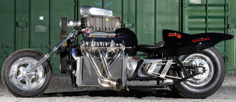

      Dual BOV's just for flow? Or are they set up at your peak pressure and a back-up just over your desired peak?
      UK London
      527
      Quote Originally Posted by ArtosDracon View Post
      Well spotted Artos. The dual Procharger BOV's are just acting as BOV's.
      The dual Tial waste gates are acting as you described. Controlled by an AMS1000 they will limit max boost regardless of RPM. This will enable me to drive it on the street, on the race track and at high speed with tuning above and beyond that offered by changing the gears in the gear drive. (No pulleys)...

      Wow, a rather elaborate set-up. Should do the job nicely though. The wastegates are just venting to atmosphere then?
      Yep...It should enable more street hook than mini tubs, the MSD 7531 or manual throttle control...After all 700hp Busa's hook thru a much smaller contact patch with far less weight using the same set up!!!...
      Of course I didn't have to put mine under the seat!!!
      Using technology borrowed from the fastest street bikes on a car is a lot better than slower street bikes using older car technology on a bike!!!
