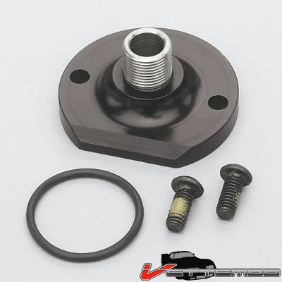

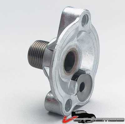

      Here is the bypass or "relief valve" I was talking about...
      I found a very good explanation of how/why it works written by TwinTurbo:
      You have to realize that it's not the system pressure of 15psi that opens it but a pressure DIFFERENTIAL of that over the filter. Basically a pressure drop due to cold/thick oil, a clogged up filter......
      Everything is relative so even with a 15psi spring setting on the relieve valve, it only opens when one side has 15 psi less than the other side, whether this is 30 vs 15psi, 50 vs 35, 80 vs 65...blah blah blah...doesn't matter.
      The oil filter is NOT on a side loop, it only is if you forget the hidden plug in the rear vertical passage. The oil filter adapter only bypasses to keep the filter from bursting. I have always replaced the spin on adapters with non bypassing ones and used either large case filters or a System 1 mesh filter. Never had a problem. Especially with the System 1 filter it takes a ton of pressure to burst that thing. So, if you have a pressure drop of more than 12-15psi over the filter, that's when the bypass opens.
      The bypass valve in the PUMP is what bypasses the oil back to the sump to regulate max. system pressure. If that one opens the oil gets routed back into the sump via the relief port.
      Going to try and block it off tomorrow and see what happens
