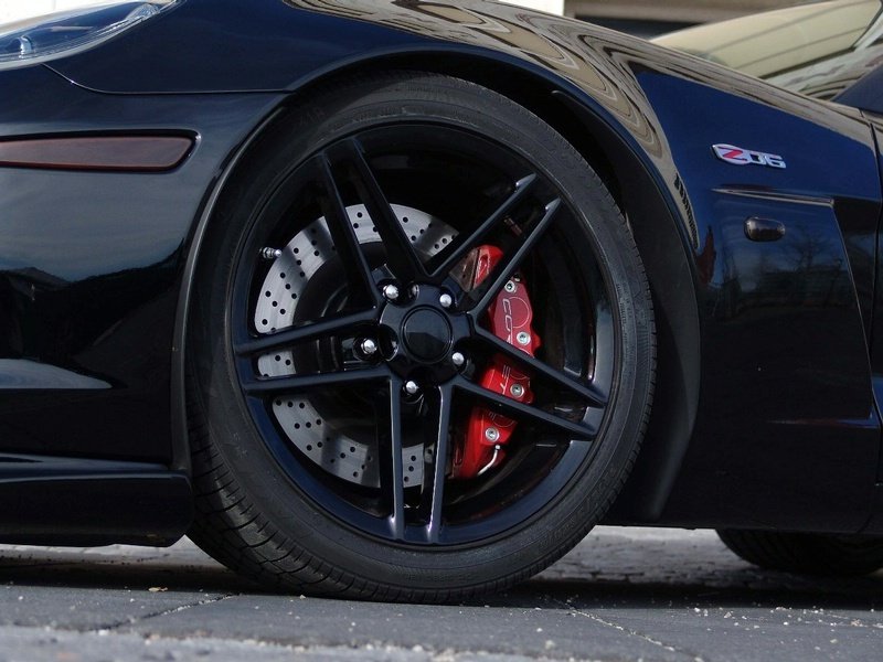

      San Antonio, TX
      1,635
      I saw one of these Z06 Black editions recently, and I thought it looked killer. If you're going to murder it out, go all the way.

      Quote Originally Posted by mc84_zz4 View Post
      JMHO
      Your paint looks enviably deep.
      heh, my paint looks deep?
      Yeah, the only super black/black combo I've seen is on newish vettes. They seem to be the only crowd that will venture into the uncharted abyss of a completely murdered out vehicle.
      Are those glossy? They look like somewhere in between glossy and matte.
      San Antonio, TX
      1,635
      Here's another pic of the same car, they used gloss finish on them..

      Apr 2010
      364
      Wow, that's not sexy at all
      That's it, I'll probably end up going with the glossy black. Thanks for posting up that photo.
