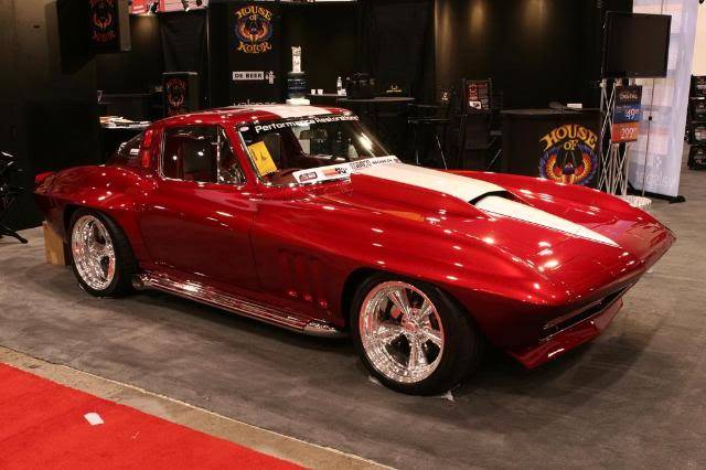

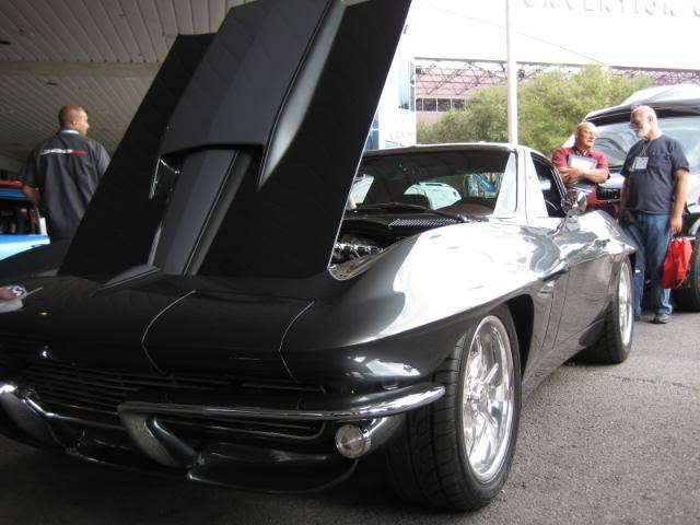

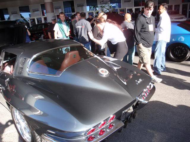

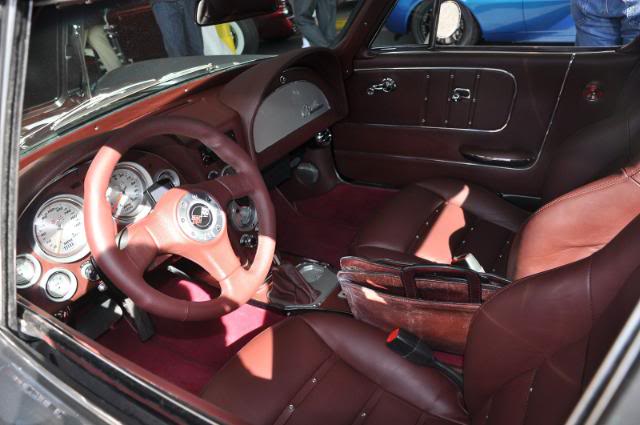

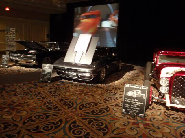

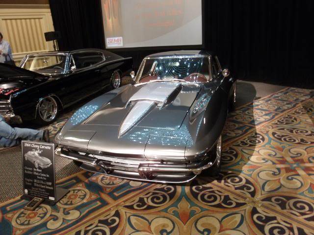

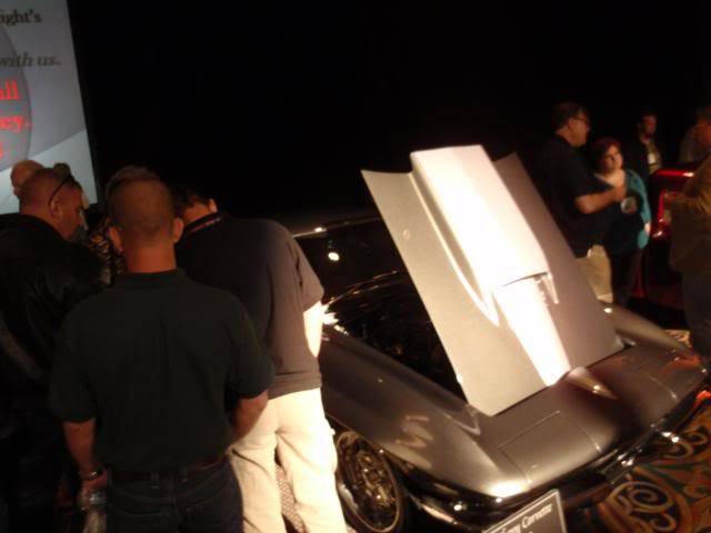

      Some picture of car taken just before leaving for SEMA and at the show. Apologize or the quality of some of the pictures that I took due to low light conditions and fact that my hands shake faster than camera stabilization can overcome they are blurry.
      Interior at SEMA, no center arm rest due to lack of time before show. Now has a center arm rest and carpet has been changed out to one in same color family as leater used.
      The young man with the glasses is who did all the bodywork.
      Some of you may recognize Jon Kosmoski, founder of House of Kolor in below picture. He stopped by to check out car on the way from his hotel to convention center on Monday (setup day) while we were waiting to be called to take car in. B-rod or Custom owner Larry Burchett is the other one in picture. Jon paid him and his son a hugh complement on the car's design, paint and bodywork. The picture below it should tell you why. Wide body C2 Vette in it was either in House of Color booth in 2010 or 2011.
      I just was barly got a quick shot of young lady taking pictures of car on her lunch break. Why I took it is because she was a Booth girl that took the time to take a look at car and thought enough of it to take pictures to show to her friends or family. She must be one of Barry's Car Crazy Ladies. You just got to love them...LOL

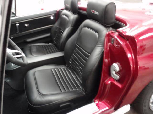

      Great job on the car. Paint looks great. I have a few questions about your build and advise for a new build we have currently started. 67 convertible with SRIII chassis, C6 suspension.

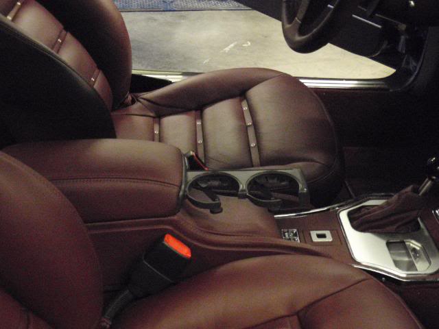

      What seats did you use for your convertible build?
      The seats in my 66 are 2008 C6 corvette seats, backs cut down and 67 headrests installed, and bottoms redone to look like 67. If I had to do over, I would have left the C6 seat bottoms along just upholstered them in pattern as 67.

      Center Console with armrest and cup holders?
      The center console was made by Steve Holcome Knoxville, TN who did the rest of the interior. The lid with the cup holders came from a console sold by Volunteer Vet in Knoxville, TN I supplied him. The lid may be from a 1998 Volvo model from some pictures I was shown by another Corvette Forum member.

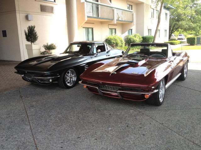

      66 and 64 at hotel in Nashville for Goodguys Show. Ken and Barbie. 66 stock male body and the 64 has been transgendered into a female by giving it curves like a woman.

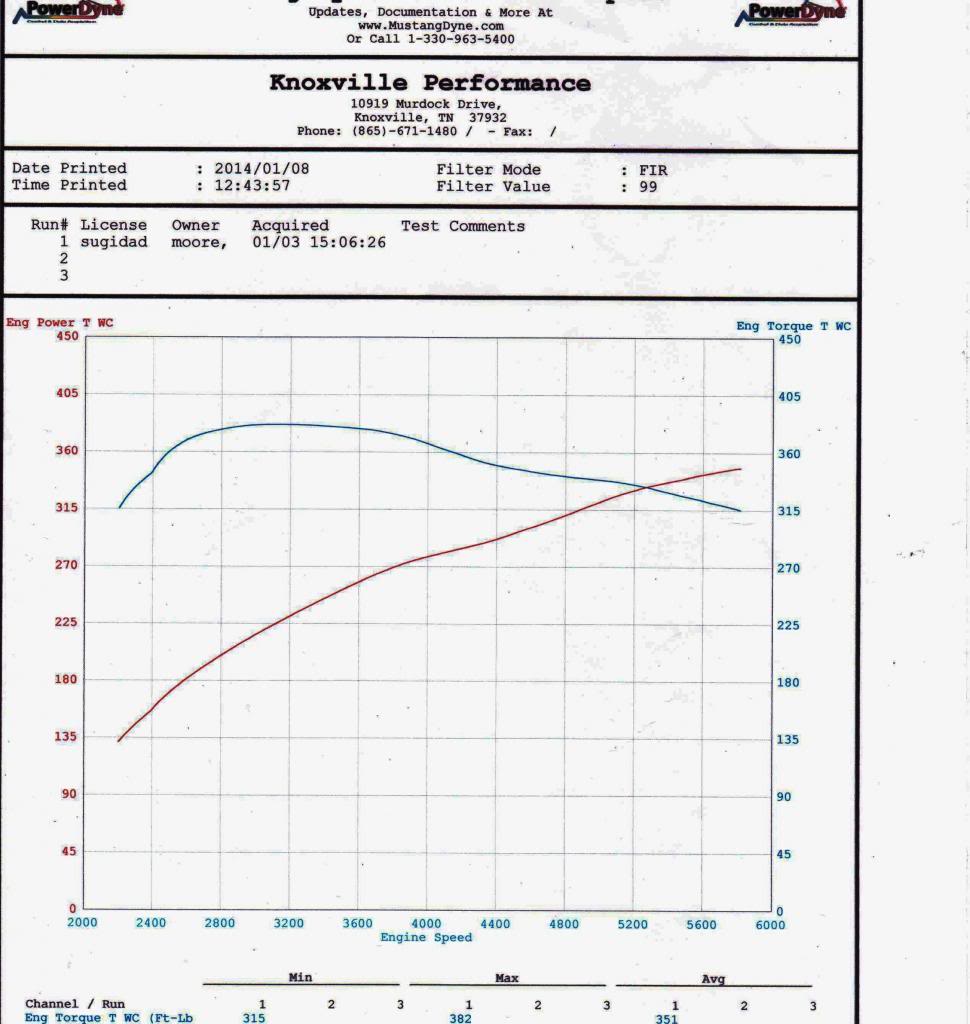

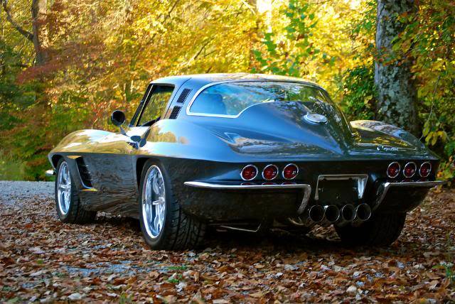

      Update on LS3 480 HP Hot Cam performance in 1/4 mile.
      At LS Fest I got to take car down the strip. 12.03 ET, 117.93 MPH, 1.96 60' foot time. Lack of Traction was not part of problem with 60' time. Didn't even spin the tires, but bent the rear end torque arm on 1st run, and a little more on second one because of how well car hooked up. By the way, car has 50/50 weight distribution. With fuel as run, it's 129 lbs heavier on rear. Approximate weight with driver was 3625-3650 lbs.
      Because car was so close to running in 11's I've decided to try and get car in the 11.2 to 11.5 range even if I can't get 60' time in the 1.6 range but stay in 1.9's instead. Converter is stalled at 2800 RPM for a reason and I want have it restalled just to try and get 60' time down.
      Below is what happened by swapping LS2 MAf out with LS3 style one. Notice how that change TQ curve. Notice also that at 5225 RPM peak TQ and HP were are nearly the same. Peak HP stayed at 360 and peaked at same RPM as before change. That means I need to modify intake air tube so that the two 3.0" tubes merge to feed 4.0" tube feeding throttlebody or change out tubes for 4.0" ones. Will be a coupe of months before I can work on getting that done.
      Before MAF change.
      After MAF change.

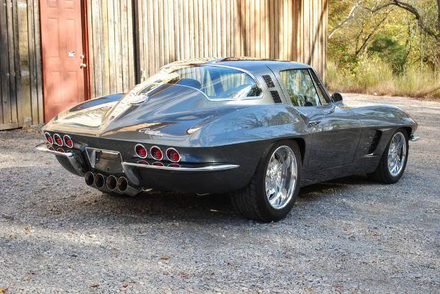

      Here are a few more pictures of the reason why I want car to run solid mid 11's. It's because it was built to dirve. It's not a show car, just a Pro Touring one.
