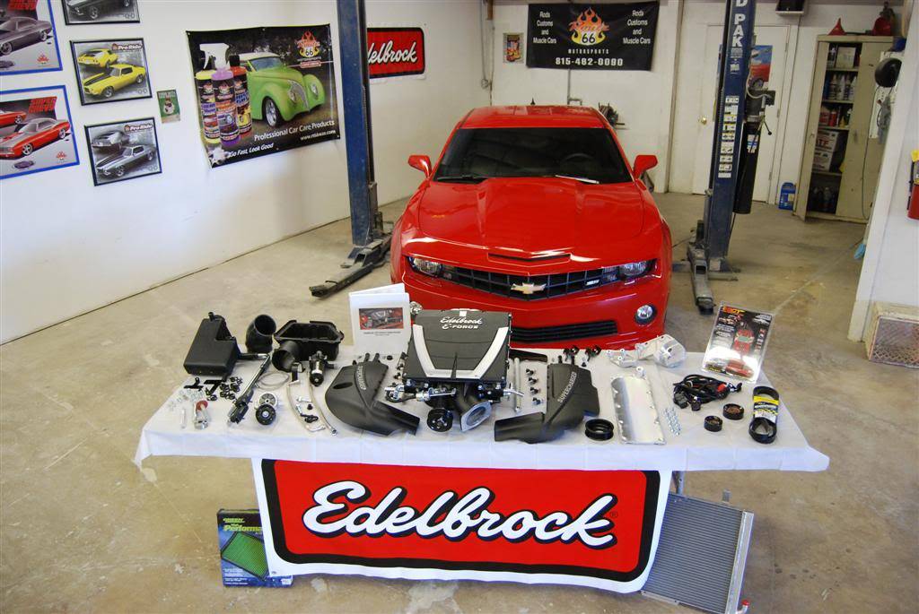

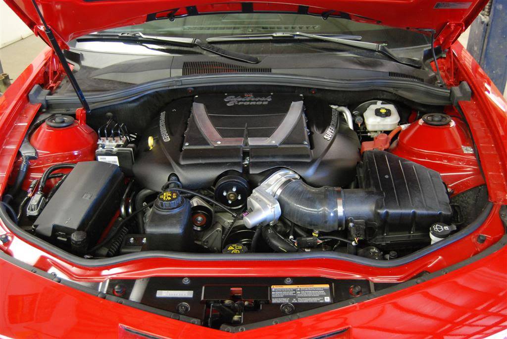

      Route 66 Motorsports is proud to announce that it is one of the very first to install the E-Force Super Charger on a 2010 Camaro automatic. What we found here at Route 66 Motorsports is that there is no cutting or modifying needed to install the complete system under the stock hood. If at any time we find it necessary to return the car to stock, the system can be removed and all the stock parts can be reinstalled. Edelbrock’s instruction folder was very informative with color photos and step by step instructions. The whole install process was very simplistic due to its well thought out design and engineering. As we write this the 2010 Camaro is being strapped down to the dyno. Tune in for dyno results and video.
      You can also go to our web site at www.rt66motorsports.com to see step by step pictures of the install

      So it only made an addtional 60RWHP?? Not a whole lot for the investment. Really nice looking kit though. Good info!

      LOL 57 HP to be exact. Watch the scroll when it shows the numbers. I had to rewind it because it sped up. I'm suprised so little though.

      Watch it to the end...they found a few more after tuning...82 over stock baseline. Maybe they need to drive the SC just a bit harder or add an intercooler to see some bigger gains.

      It already has an intercooler.

      Hell, do some intake and exhaust mods, followed by a good tune and you're almost there. Unless I'm missing something, a total waste of money. I picked up about 300 RWHP with my Procharger on a Gen 1 sbc, for about the same or less money.
