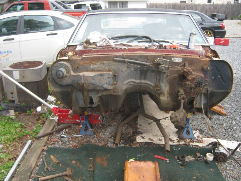

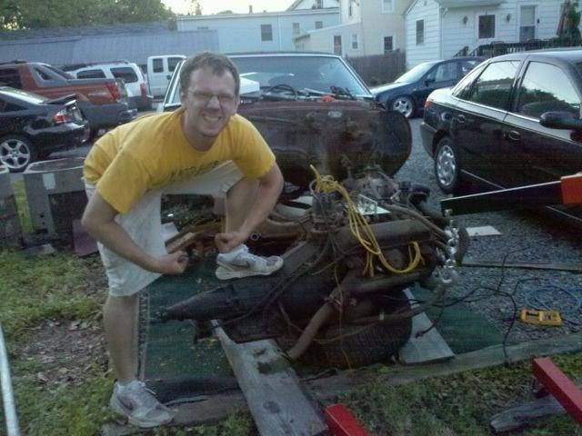

      Heres an update from last week..we have takin apart almost the whole car and are waiting till next winter or summer to tackle the body. Its just to much money to put out at once...we basically need everything body wise so we decided to just get the car in perfect working order first and then worry about how it looks. With that being said the whole car is basically stripped and ready for some new parts. Here is where we are at now.
      Ready for the pull, bye bye old 327 and powerglide...
      Out and conquered...haha

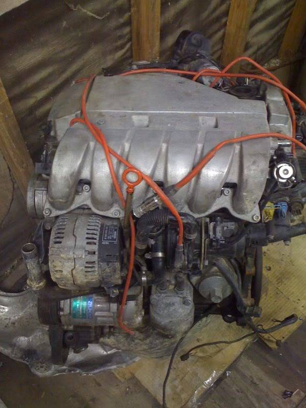

      you putting a VR6 in a 16V GTI? love GTI's, had 2, both 8V.
      I'm in Easton PA, you nearby? few lehigh valley guys here.
      Keith C.
      NJ/PA
      396
      Quote Originally Posted by twosaturns View Post

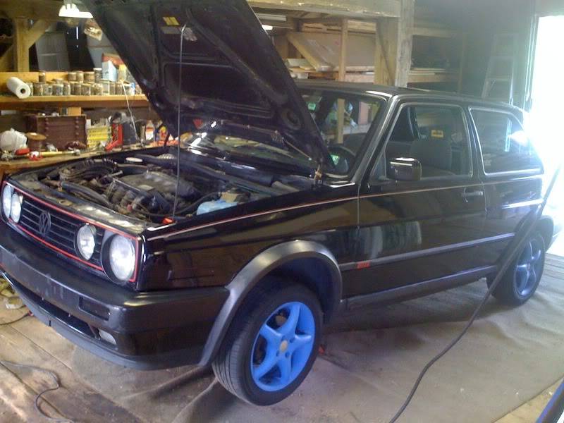

      Yep.. The green can was my first mk2 to pull the old 16v out and put a vr6 into it.. I didn't have much cash into that car and sold it for quite a bit to buy a ring. Then decided that I really liked that car so I bought another mk2 and another vr6 to do it all again.. Haha.. Crazy I know. I currently live in Newtown pa.. I don't think that's to far from you..If your close enough and need a hand let me know..

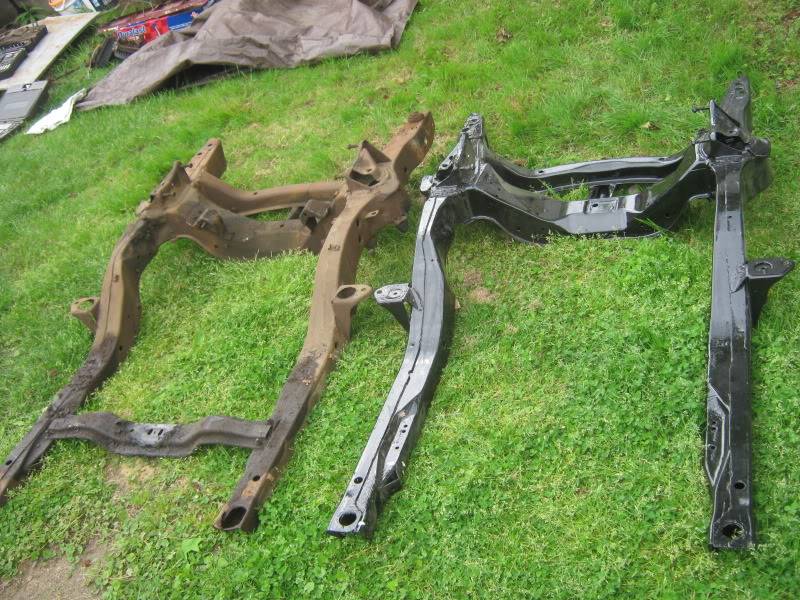

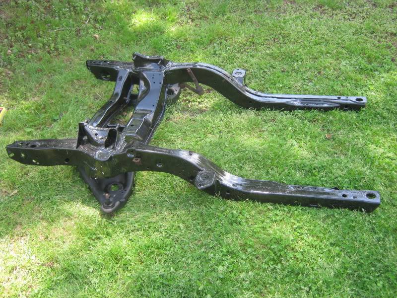

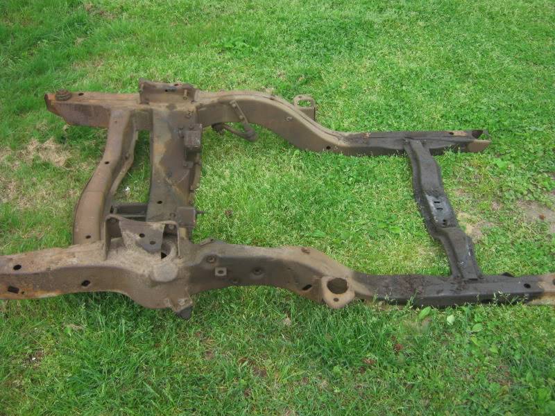

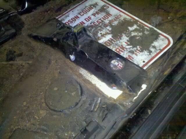

      Heres where the car is at right now..
      old frame..
      and new.
      and compairson.

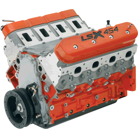

      Alright guys..need some help here...EFI or Carb? Heres the motor Im going with:
      I have questions for both. I have done research on both and from what I have gathered EFI seems to be more expensive for this motor because I basically need everything..enlighten me please..
      EFI:
      All wiring
      ECU
      Tune
      All Accessories
      Injectors
      Intake Manifold
      Ignition Coils
      Throttle body
      Oil Pan
      Oil pump pick up
      Headers
      Carb:
      Carb (What size, Manufacturer?)
      Ignition (MSD 6010 or 19171130 off of www.crateenginedepot.com ?)
      Intake Manifold (19244033 off of www.crateenginedepot.com or Edelbrock?)
      All Accessories (Which kit will fit the stock subframe and go it with out any/too much modification?
      19243525 off of www.crateenginedepot.com
      19155066 off of www.crateenginedepot.com
      19155067 off of www.crateenginedepot.com
      Oil Pan (19212593 off of www.crateenginedepot.com) fit stock subframe?
      Oil pump pick up
      Headers
      Ive tried to see what others have done with this motor but because it is new not many have run it that I can find..I believe it is the same set up as a ls7 correct..? I dont want to just rule out EFI untill I know it is not suited for me. The car will be a nice cruiser with some drag strip trips in store. I feel like I might be leaning to carb set up because it seems to be easier and I just want to really weight both options fully. Help me guys. Thanks Steven

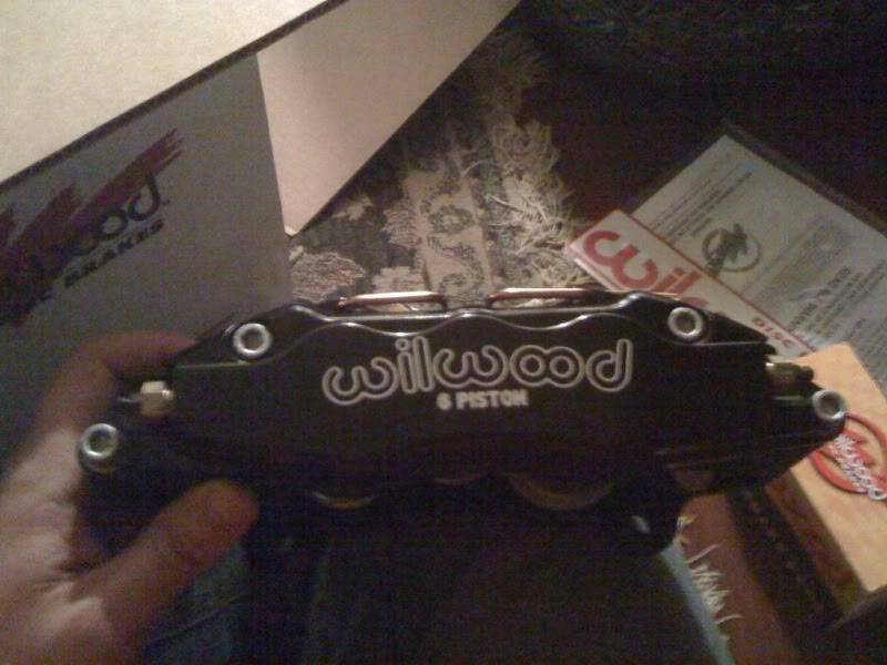

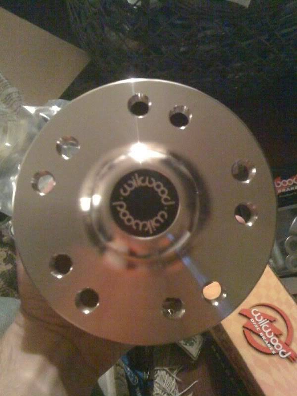

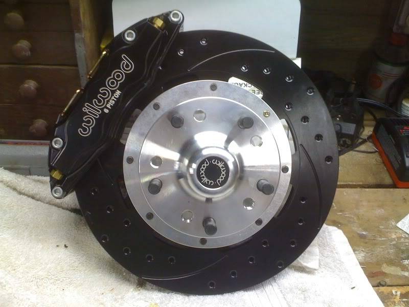

      Well stuff is starting to come in..its wilwood heaven..here is some quick pictures..
      emmm...6 piston..
      theres the old man holding some two piece goodness..
      hopefully well see the rear soon.. Big Thanks To Frank and all the prodigy customs guys...A+++ service..

      Save those engine stands off the original subframe. The reproduction pieces are junk and you are better off cleaning up the orginal ones and having them powder coated. Other than that I think your original subframe was totally shoot.
      You also might consider the Hotchkis valved Bilstein shocks in lieu of the QA1 pieces since it looks like you are going with their springs. Nothing against QA1 but might save you some money and have a better matched system. Do some research on the forum and you will find they get good reviews.
      Also, I vote EFI. I know the LSX 454 is an awesome piece but you could also save some money on a drop out LS2 or LS3. You could get the accessories, trans, wiring, ECM, etc. and save some serious money over the LSX 454. You can do a cam and spring swap and easily be in the 500+ HP range at the crank. The LS3 heads flow better and would give you slightly better numbers than the LS2. I know that is short of your goal of 550 RWHP but I estimate it would be around half the cost or less of the set up you are looking at. Just some food for thought.
      Last piece of unsolicited advice. If you are serious about running 11s in the 1/4 mile you should reconsider the leaf spring rear suspension. If your budget can manage the cost you would be much better off for hard launches with a canted 4-link like the prodigy bar or g-bar. It will also give you improved ride quality on the street.
      Best of luck with the build.
      NJ/PA
      396
      Quote Originally Posted by meenaggie View Post
      (1) I have already bought the QA1 all around.. im afraid its to late to turn back now. I plan on running them and if me and my dad really hate them well look into other options. But thanks for the advise.
      (2) The problem here is that we want a motor with a warrenty. Thats why we want to buy a new gmpp engine. I will have to look into the ls2-ls3. What cam and spring set up would you recommend for the power outputs I would like to see? Where can I look to buy a complete set up..? Ive been talking to frank over at prodigy and he has been telling my about a really nice 418cc engine that will make close to the same hp/tq as the gmpp 454..well see.
      (3) I have looked into it with frank..it just isnt in the budget as of right now. Again mabye down the road we will go with that. Only time will tell. Thank you for taking the time to give me your advise. It is appreciated. Thanks Steven
      413
      Country Flag: China
      No problem with the QA1. I was just throwing out another option. I don't think you will hate them.
      Datonayellaz is a member on this forum that sells drop outs. Gets good reviews from fellow members but I have no personal experience. Link below should help.
      https://www.pro-touring.com/forum/sh...ad.php?t=68969
      Here is a link on LS2 cam selection. Mike Norris is a great resource for selecting and tuning a setup that meets your goals.
      https://www.pro-touring.com/forum/sh...ad.php?t=65687
      I can definately understand you wanting a warranty. After all, you plan to spend a lot of money on that engine and you expect it to work. For a new LS I think you are on the right track with Frank. Another resource for new performance LS engines is Scoggin-Dickey Parts Center. They are a sponsor here as well - user name Jesse@SDPC
      A set of Cal-Tracs are budget friendly and will help you at the drag strip to get better launches. You might even be able to pick up a used set from someone by posting on the wanted section.
      It is good to see you have a plan by the way.
      NJ/PA
      396
      I hope we wont hate them they cost enough.haha..well see. I just want to drive the damn thing already.
      I am not totally set on the lsx just yet. It does seem pricey for the power it makes. Expecially when you factor in how much extras will be needed for the install. The should sell it as a complete drop in for that price. Im still weighing out my options at this time. Hopefully by the time comes to order the motor we will have all our bearings sorted out. With the help of you guys and frank im sure im in good hands. Thanks for all the suggestions.
      I looked into these because of you and this seems like a great alternative to the pricey 3 link set up. I know that the 3 link set up is far superior but this product seems to fit the car well at this time. I will be on the lookout for a set of these. Thanks for the the info.
      It is good to see you have a plan by the way.[/QUOTE]
      Thank you, its alot of work to build a car right the first time. We are trying to put something together that will hit all the targets we want in the budget we want. I hope were on the right path. Again thank you for all the help.

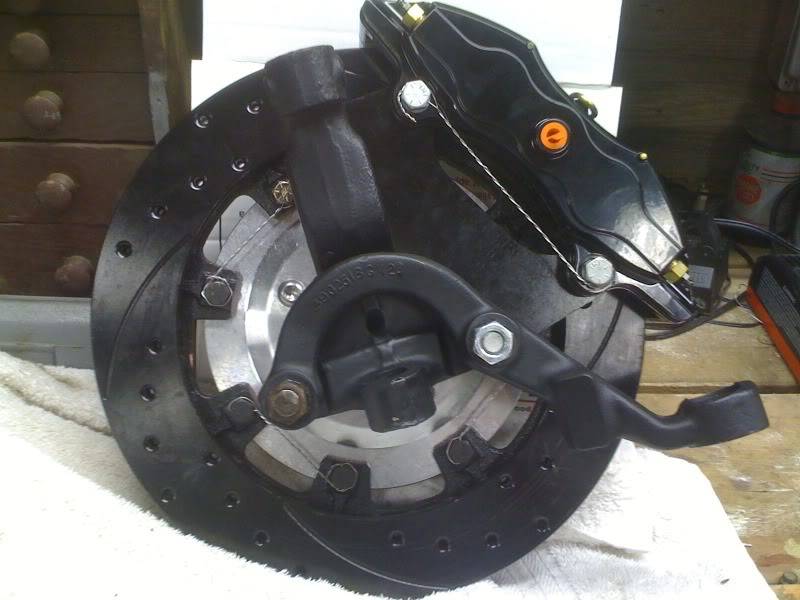

      Alright so I went to the old mans house last night and started putting the brake kit together. Still need to strip the old drum hubs and get them all ready but that will probley be tonight or this weekend..hope to have the brakes pretty wraped up by monday.. heres some pictures..and btw safety wiring is not fun...
      Heres me and my younger brother trying to figure it all out..

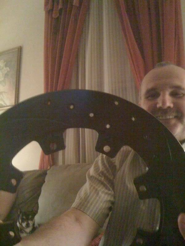

      Me messing around..
      Slowly getting there..

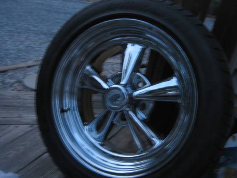

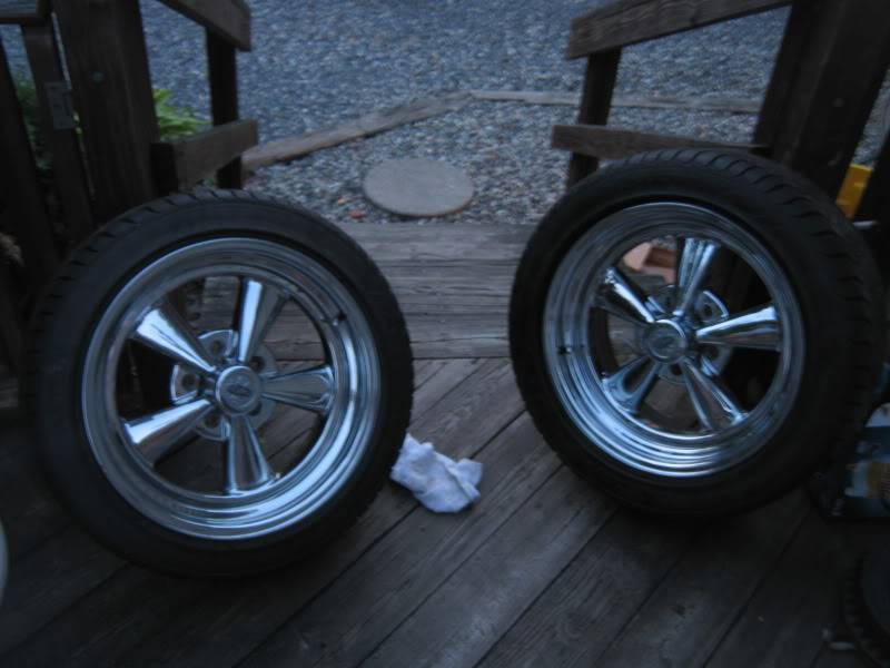

      and we brought the wheels out for test fitting..
      front and back...
      more updates coming soon..
      NJ/PA
      396
      OK...got most of the front brakes together this weekend...alot more steps then I would have thought of..but overall not to bad..cleaned up the old spindals and they look so much better now. Only have the pass side fully together and the drive will be put together tonight..heres is some pictures..
      Hopefully the rear will come today..:D
