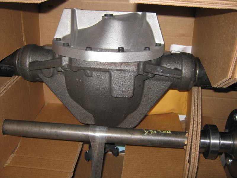

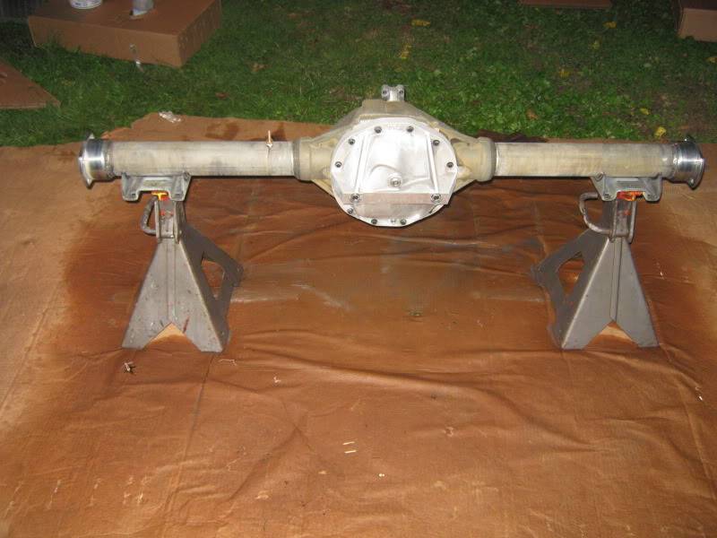

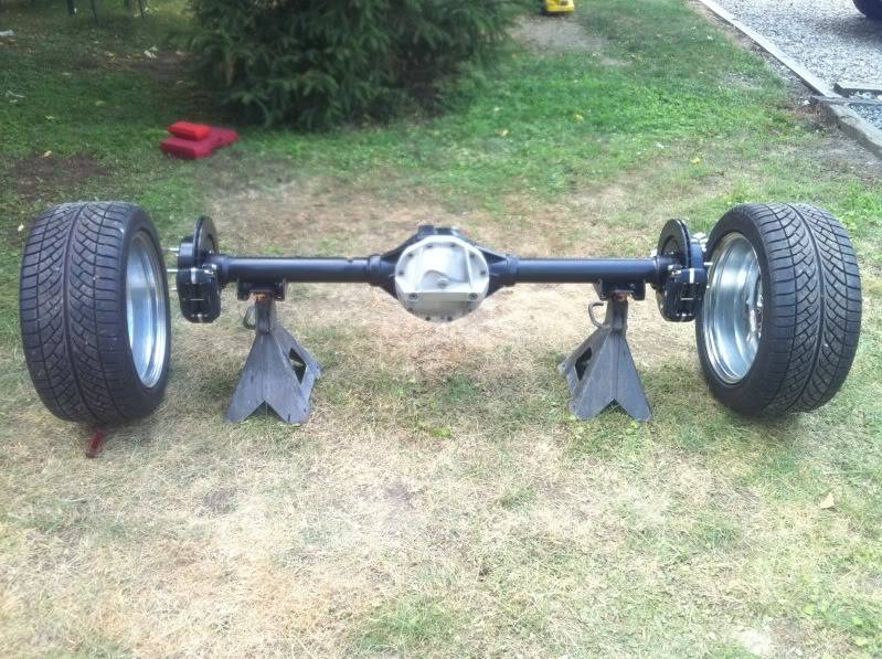

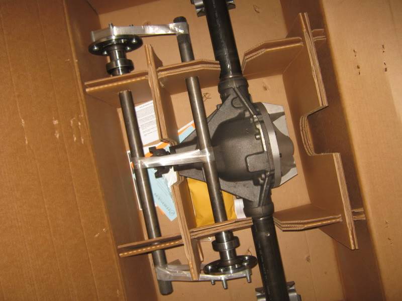

      well its here and I finally got to open up the box and work on it some...not the best pictures but they will do for now..The rear was ordered with no finish as me and my dad said we would just por-15 it in the same black that we did the front frame. We got it all out, set it up and did the first two steps of the process..degrease, then rinse with water, metal ready, then rinse with water again...let dry...open up the can of por-15 and its solid as a rock..so we order more paint today and hopefully well have it by the weekend. We should have what we need after its painted to put the rear all together as a rolling assembly.
      As for the front frame when we had the powder coater do the front arm and other little things we didnt think about the ball joints and sure enough they where toast. So we ordered new upper and lower ball joints and they should be here by friday also. We also ordered the AIM manual and the alingment shims. Hopefully the sub frame can be a rolling assembly also soon. Anyone care to chime in on if I have the steering arms mounted correctly? I believe they are to face twords the rear of the car...

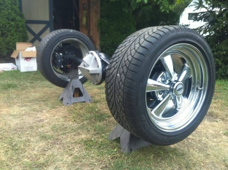

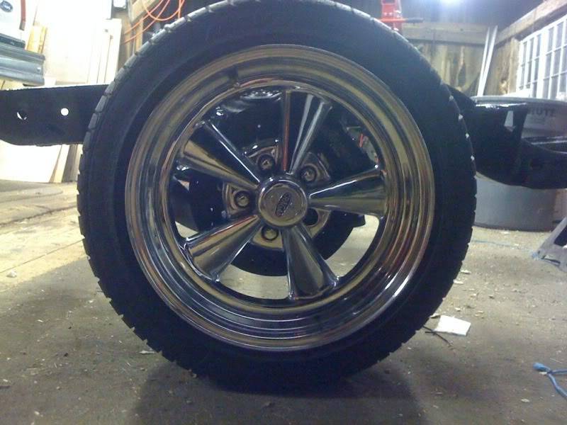

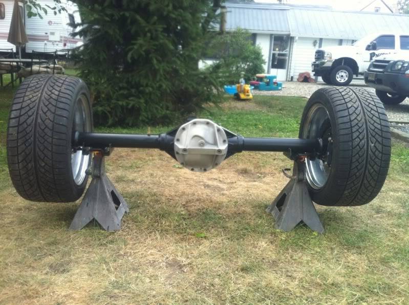

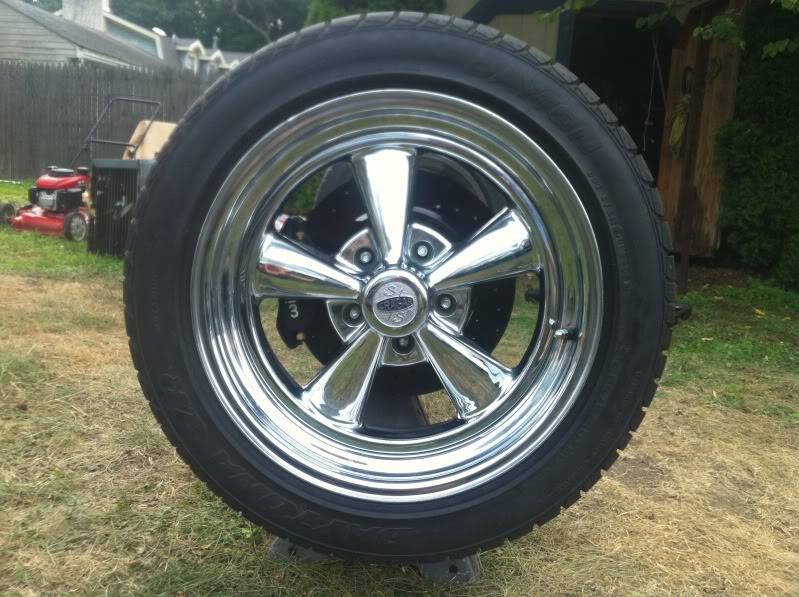

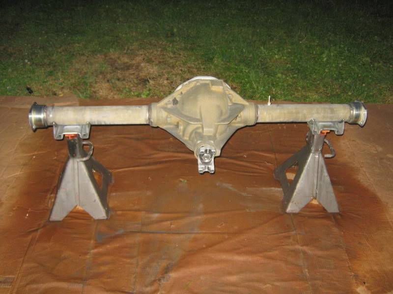

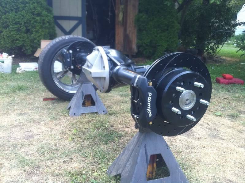

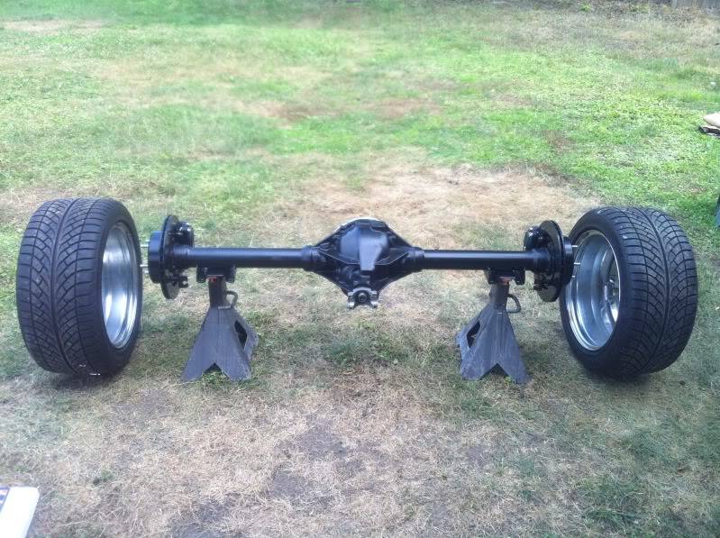

      Ok so the box from ricks camaro never came and I wanted to do the front end today also. At least get the new ball joints pressed in the upper and lower arms..but no fedex. So I just worked on the rear. The por-15 came in yesterday so I went over to my dads and painted the rear with two coats. After that I put the rear brake assembly together and the alxes in. Also grabbed the rear wheels to see what there gonna look like. Here are the pictures..
      Mabye tommorow I will get over there and start on the front frame..if not deff by tuesday...more updates coming soon..

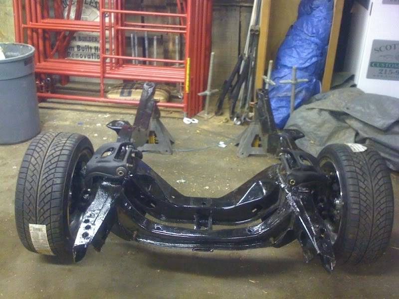

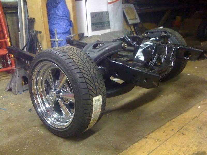

      Ok..after many curse words and a couple busted/bruised body parts. I finally have the start of the front assembly together. Not the best of pictures but its better than nothing. I have to get the caps for the upper control arms still and get all the steering cleaned up and gather my bearings on what Im going to need to buy. In other news the Stainless tank should be here sooner than later...next up. Brake lines and mabye por-15 some stuff...more updates coming soon..

      How come the body mount holes are different sizes on the two subframes?
      The frame that is painted had some rot near the second body mount so we had some steel welded to the underside. We still need to drill the hole.

      I noticed when I changed over to the solid mounts that the firewall holes were oversized from ro. I was thinking of having the whole mounting bracket replaced in time, but now I'm gonna look into having done what you did,

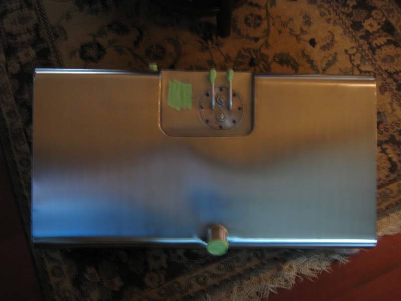

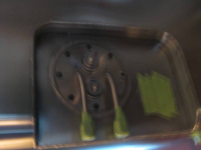

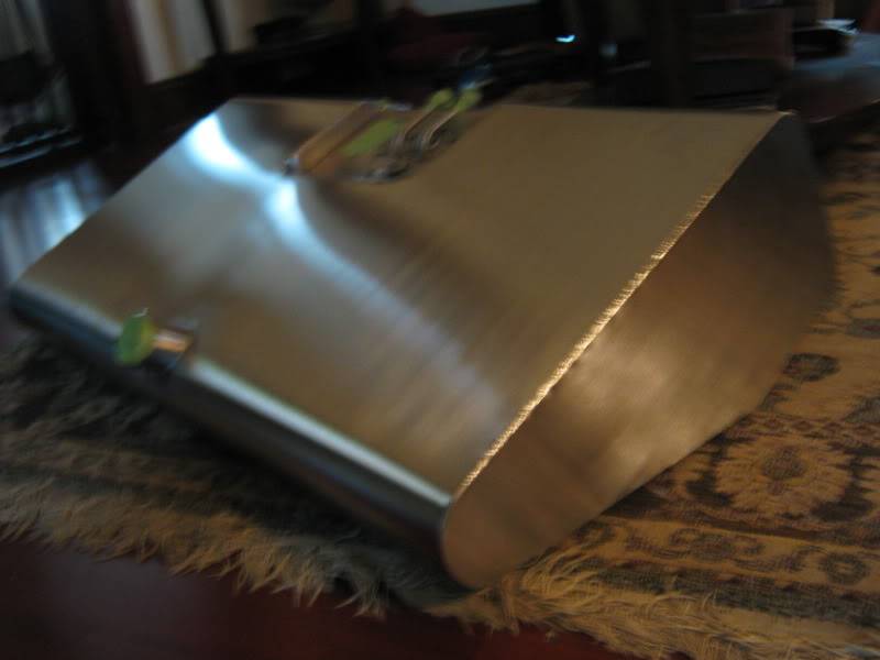

      got the s/s tank from ricks...thanks frank!! next on the list is the transmission..brake lines, and fuel lines..more updates coming soon..big install once the tranny is ordered and arrives..heres some quick blurry pictures..

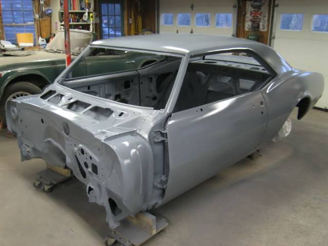

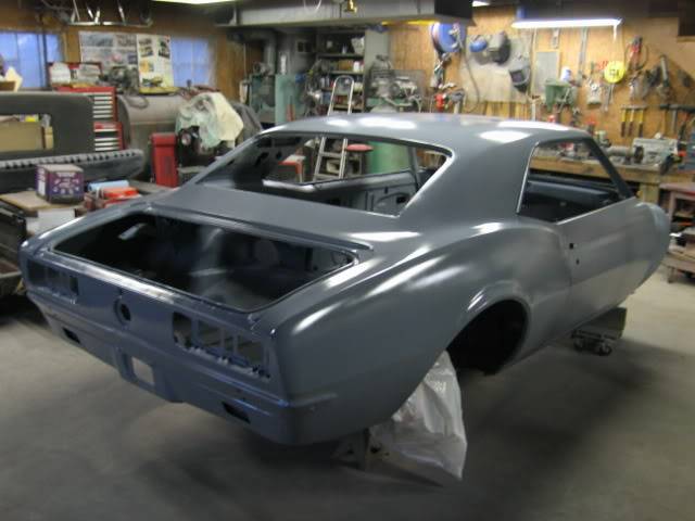

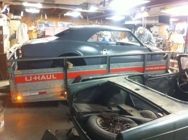

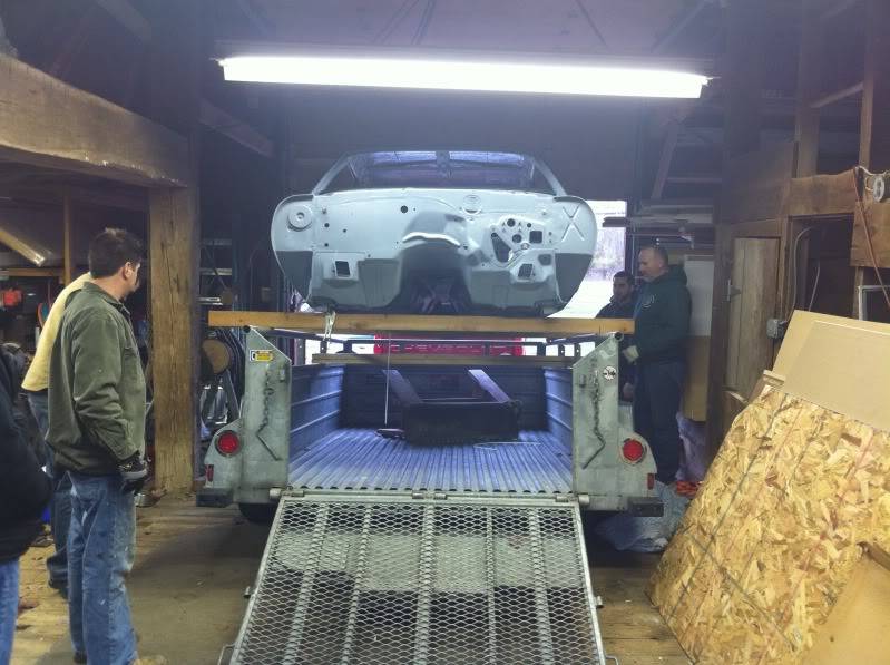

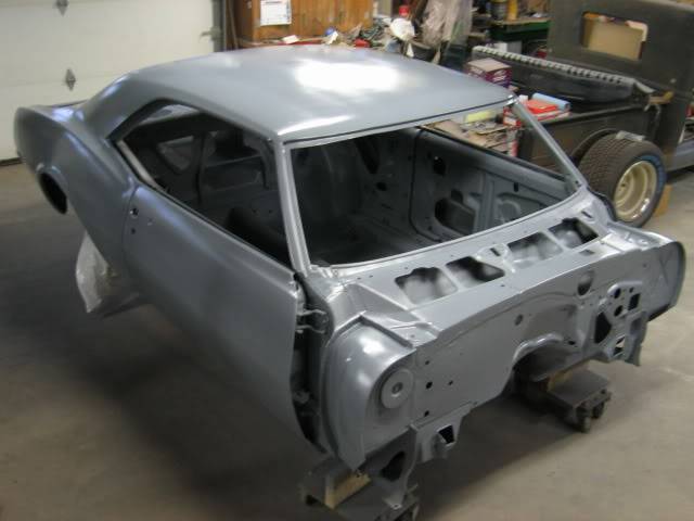

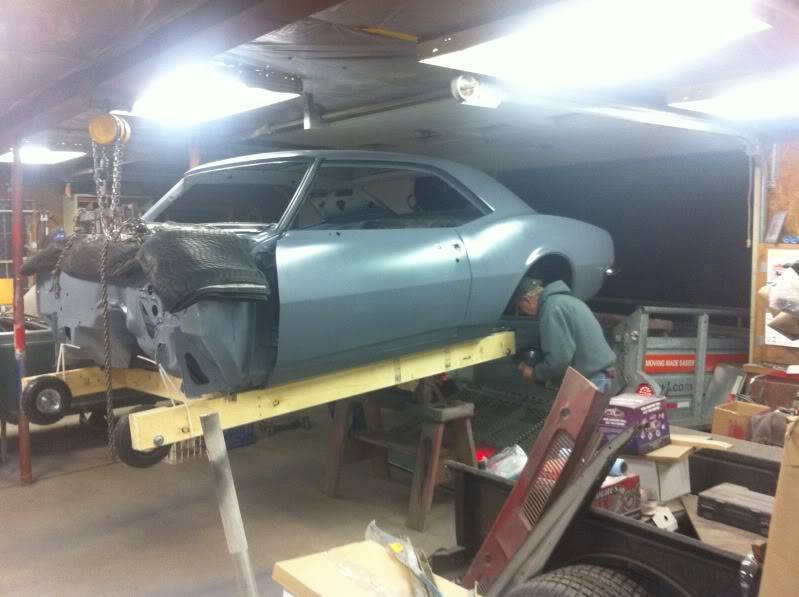

      alright ladies/gentleman its been a while but money and time don't grow on trees. Late in the summer we had someone come by and take a look at my shell. Basically the guy told us to even start with that shell your looking at 25k. Well that is out of the question. So me and my dad have been eying this shell. Only problem is that is was over 5 hours away. So we saved up and made the trip this past weekend. After a 14 straight hours and many miles..here what we got.

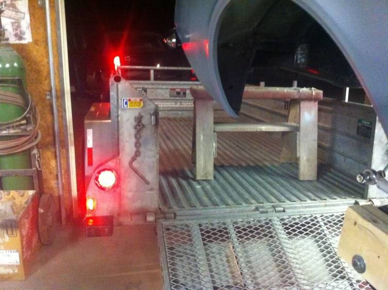

      so me and my dad rented a 6'x12' enclosed trailer from uhaul only to get there after a 5 plus hours drive and realize that the smallest opening on the trailer is 5 1/2' so there is no pulling the car on..had to lift the car in the air over the trailer and then lower it. To say it was tight was an understatement. But all in all it was worth it because now it all done.

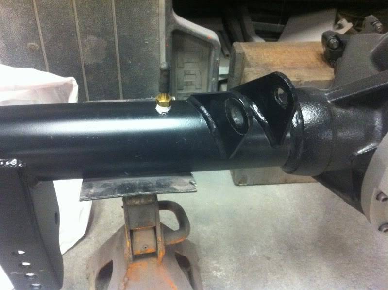

      and now I need franks help. The car I got has one of your 4 link set ups on it. The problem is my rear does not have the brackets I need. The guy I bought everything off of said that they make a bracket (in the picture to the left) that can be bolted to the leaf spring mount.The other bracket (in the picture to the right) has to be welded on to my rear. I need to know where to find that bracket and also the dimensions or some kind of guide as to where to weld those on at. Any help is greatly appreciated guys. Thanks and talk to you soon, Steven
