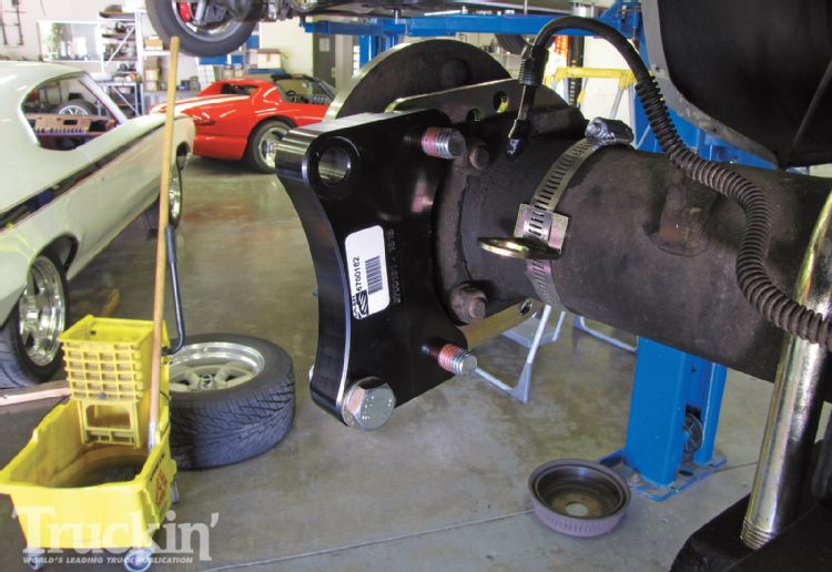

      For pictures sake, how much do you think it would cost to have something like this CNC'd:

      I agree with 6061-T6. Machine time looks short and only one setup. Dont need to flip the part over.
      I would guestimate about 4 hours for the cut time. Most places will charge a minimum of $250 but that includes setup and a certain amount of time on the machine, guessing 2 hours or so.
