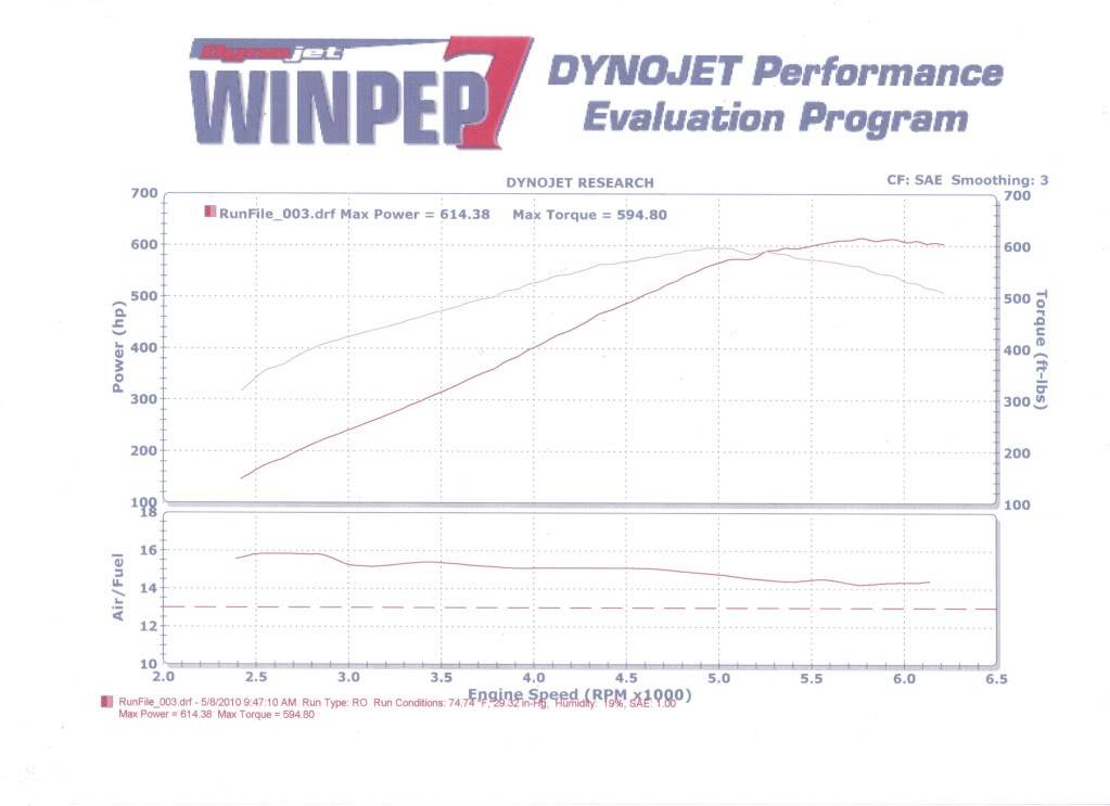

      Did a dyno session to validate my latest cam change. Not too shabby...but I dare not press the Gen 1 block any harder. 625 rwhp/595 rwtq.

      383, 8.3:1 scr, JE blower pistons, Scat 4340 crank, Eagle rods w. ARP L-19 bolts, Edelbrock Vic. Jr. heads, Comp. Cams solid roller 244/248/114*, .617 in./.591 ex. lift. FAST efi, ProCharger D1-SC supercharger around 15-18 lbs. boost,(not logged this session).

      Wow, nice steady curve, should be fun running through the gears with those numbers.

      Your air/fuel looks lean for forced induction?

      The probe was out of calibration. It as reading 1 to 2 points leaner than actual on everyone's runs.
