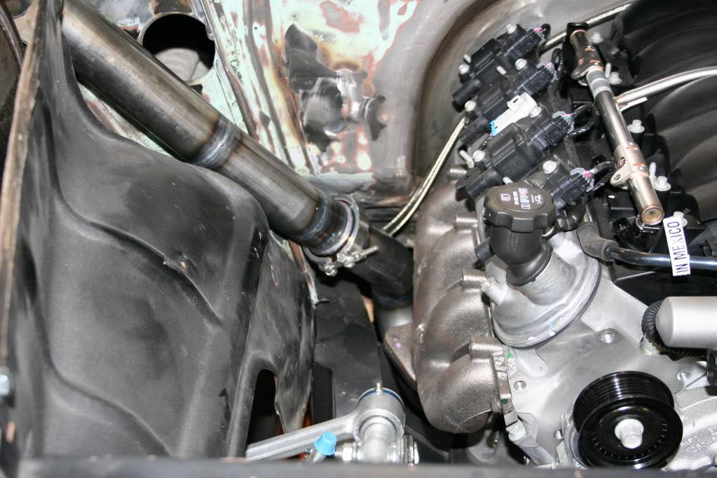

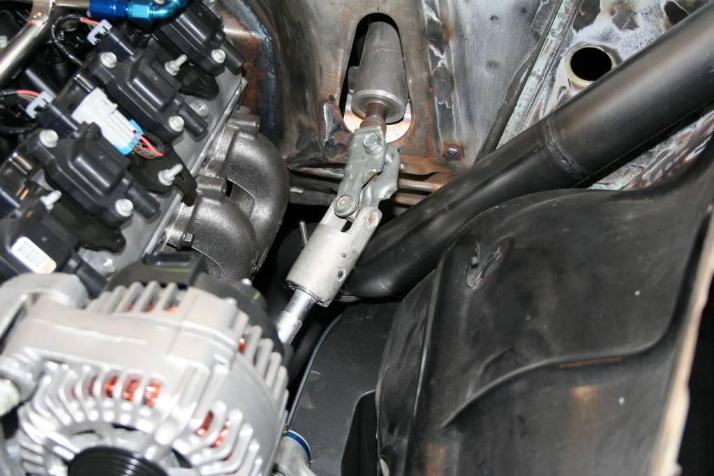

      The new power plant consists of a LS-376/480 with a T56 six speed. The motor is moved back 5” into the firewall and in doing that we were able to drop the front of the motor down and get the pulley sitting behind the rack and pinion (opposite of what the wagon has, motor sitting on top of the rack and much higher). We are trying to keep all the weight behind the front axle and keep the roll center low.

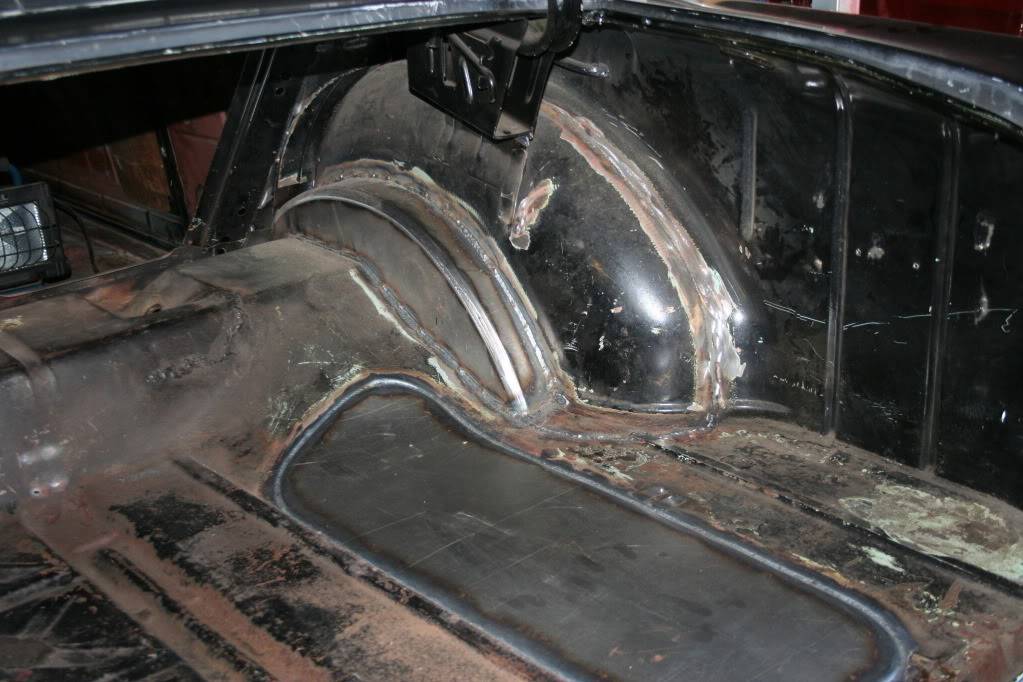

      We put one of our Newman Car Creations/ Dana 44 Replacement differential’s in the car with a .373 ring and pinion and True Track limited slip. We also installed our new Free Action Link Kit on the rear suspension which replaces all the stock Corvette links with a new billet link and spherical bearing’s. This and the independent rear suspension will help us keep the ride as plush and soft on the street as possible. We also gave the rear a mini-tub which allows us to run an 11” wheel. We were amazed at how little you really have to cut and go into the trunk.
      Our next weight saving idea was to put the exhaust in the front fenders. The idea behind it was that it will take less tubing and therefore cut down on weight. We don’t know how this will work and if it is going to get the front fenders too hot. It will be wrapped with some sort of insulation to try and cut down on heat. We are also hoping that it will be quiet (if you saw our 57 wagon run you will notice that it is not very loud and we like it that way!).

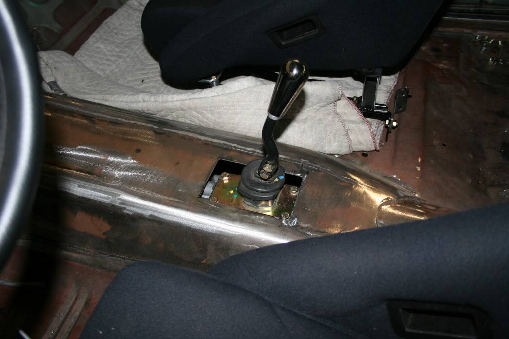

      Inside the car we are planning on keeping it very basic. The steering wheel got pushed up and back so that it is in a better driving position for me. We are hoping to run minimal interior, no back seat and in its place some sort of tire rack for track slicks and tools. The doors will get stock interior door panels with no frills. Hand role up windows, no heater, no A/C.

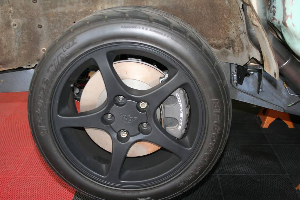

      brakes will be C-5/ C-6 hybrid

      Not trying to down but i do have a question about the exhaust. wont the heat build up mess with the paint or am I not thinking straight. But it is a good idea alos like the frame alot

      We are a little concerned about that as well, but we are not planning on painting the car at first. It was painted black sometime before we got it, and we are just going to run it till we have a good reason to repaint it. We have also been kicking around the idea of cutting some sort of louvers on top of the fender to help with the heat.

      My only critique would be the exhaust. Long tubes and exhaust out the back would likely weigh about the same as the iron manifolds/piping and would help out with the F/R weight bias.
