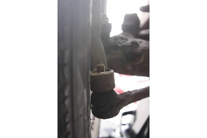

      Help me in removing ball joints!
      I am under the car right now, and I can't seem to get the tie rod arm separated from the spindle
      I removed the nut, and I hit it with a hammer, but it doesn't budge.
      Is there a special tool that I need to help me separate the two
      Thanks for the help

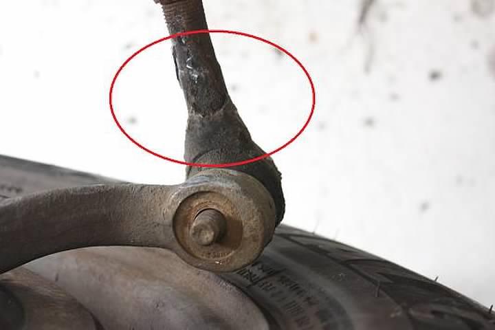

      where are you hitting?
      You need to hit the steering arm not the tie rod.

      I was hitting in the red circle

      Hit the side of the steering arm where the arrow points, removing the tire and turning the wheel to full lock will help also.

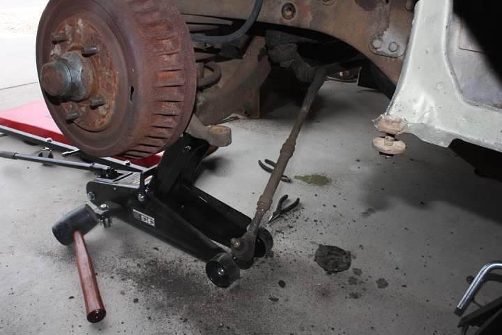

      Victory is mine ... I actually got the wheel off and separated the ball joint
      Thanks everyone.
      Jack stands are being used, just can't see them. In case anyone was wondering.
