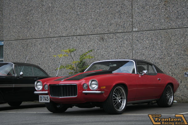

      Just found an pic. from last year on the web...

      Engine and trans. bolted to the car, had to redisigne rear trans. mount because it diden`t fit to the car, Headders from Hedman fit perfect, just 1/2" inch below frame.
      Ole Graversen
      Fast Foot Racing
      Norway
