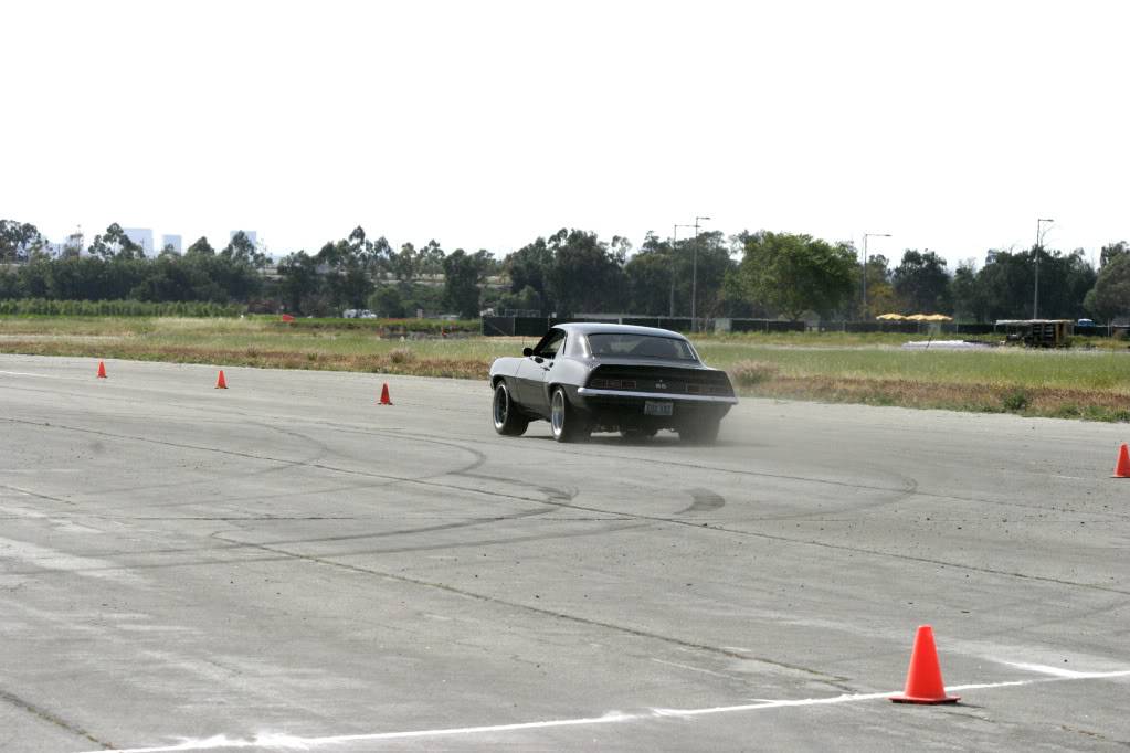

      I've been happy with the ride and handling of my gbar.(Old style modified) It's go pretty decent forward bite. This photo was shot by Sean at Chevy hi performance during apex practice at RTTC. My first wheelie that I know of!
      Todd
      Aug 2003
      Orlando, FL
      8,745
      That is really diggin Todd. Car looks great.
