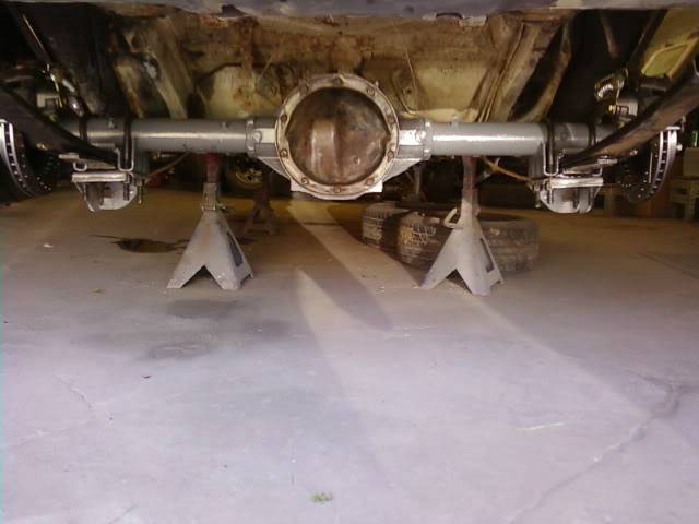

      since i last posted the rearend has been painted a hammertone gray, has the rear disks installed, and the rearend bolted in.
      and instead of the 1 bolt on each side of the leaf springs, there are now 2.
      btw with the hotchkis drop leafs and hardware kit, or atleast just with my rearend. i had to drill out the slots slightly on the shock mounts and the axle for the beefier u-bolts.
      also all of the brake lines are off, brake booster, master cylinder, and whatever else i dont need. along with the front suspension.

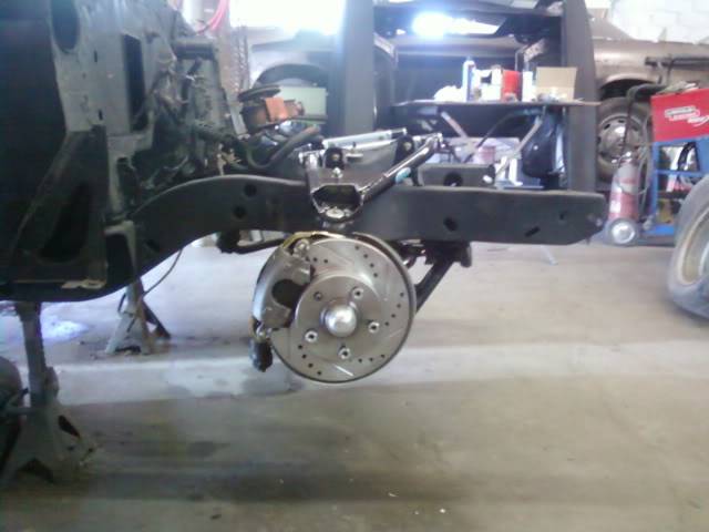

      new pics as of today.
      new drilled and slotted rotors...
      They're on the rear as well, cant get rear shocks yet theyre all wrong
      its a little dirty in some places and am going to paint the cover black

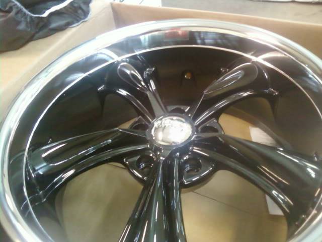

      Showing the style of the boss 338's, a lot of people compare them to the american racing rims but these are much more aggresive
      front control arms, brakes, spinles, sway bar ect.

      Cool car looks nice! Whos contral arms are those they look like CPP??

      I'm interested in those same rims. Please tell me what size they are and what size rotors you're running. I was told in one of my threads in the wheels section that those rims might not clear the calipers because the curve of the rim is too aggressive, but I'm going to have LS1 brakes, so I'd like to see how they look on yours. can you get a picture with one of the rims on to show the clearance too. thanks man. I love those rims, and for the price you can't beat them.

      im not sure about them working with ls1 brakes...
      18" should cover it right?
      im using 18x8's
      do you already have the brakes?
      mock them up and measure them.
      im not with my car any more.
      i had to come back down to north carolina.
      i will try to find a picture of the rims/brakes together
      Winter Park, FL
      143
      With regard to the wheels and brakes, it looks like you have the stock size rotor and caliper, so I would think 18" wheels will be no problem. I think they only offer the 338's with a 4.5" bs on an 8" wheel, so I've been wondering how they will fit. I've been told you need 4.875 bs on an 18x8 in front. That's a custom size and all the TTII's and others I see are all 4.5 bs.

      Keep us informed on this build. Things look great. I would like to hear any feedback you have on the CPP UCA as well. I have some sitting in the garage ready for install on my 68 camaro
      Sep 2009
      Jacksonville, NC
      15
      the cpp uca's are great. the look at least. and problems with them are nothing to worry about. the bolts for the kit were not up to par with what i wanted for the uppers and lowers, so i just ran to the hardware store and bought beefier grade 8 bolts. when i ordered all of my stuffthey thought they had the brake lines in stock but were out. they called and appoligized they day they shipped it to me, then i recieved them 2 days later. not bad at all. also i ordered their brake kit, not sure on what one it was now, but it went together so nicely.
