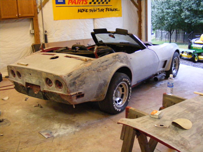

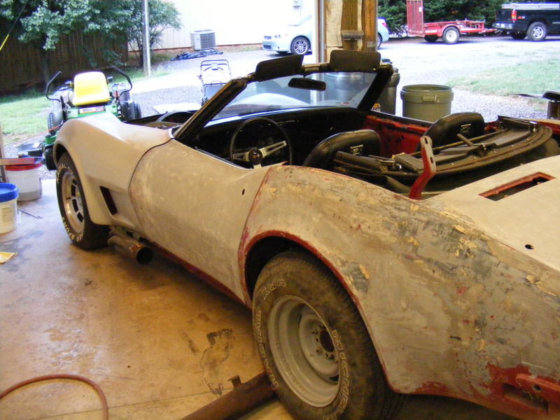

      time to bring this back from the dead! Hopefully my pics will attach if not ill try again but I am making progress on the body, waiting on the Baer brakes to come in and still up in the air on what to do motor wise. Enjoy.
