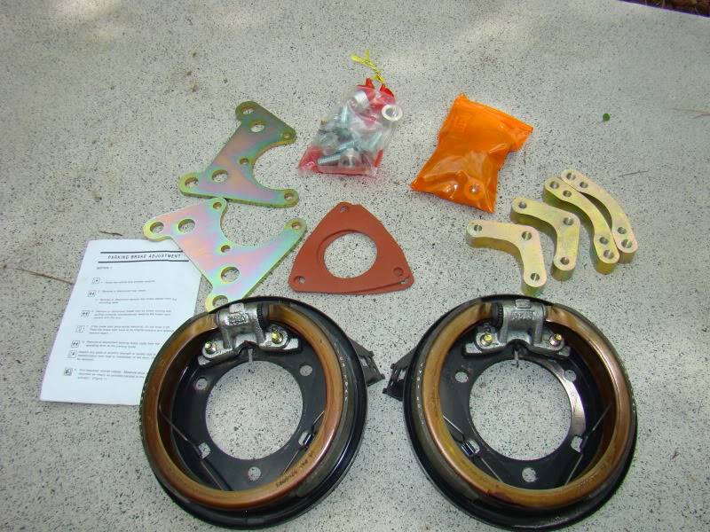

      Those look like the C5 brackets....can't tell for sure from the pics.....here is a pic of the C5 with ebrake stuff that I put on my car awhile back.
