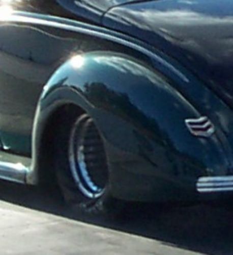

      Are you talking about a drag-race style four link? If so, they are better, because there is a lot of adjustment to set the instant center of the suspension and maximize how hard the tire plants on the launch.
      this is on my 40 Ford with Hoosier "street" tires. The four link gave me the adjustment to plant the tire like this.
      Good thing you had the bead screws, I expect that would have spun inside the rim without them.
