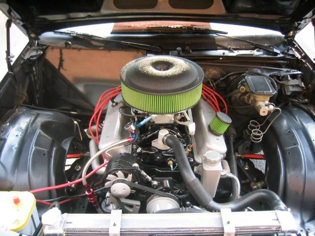

      here is an old pic of my motor...but you can kinda see the red adjusters on the control arms....
      I like what you did to your smooth sleeves. I might just end up doing that. It is easy and functional!!
