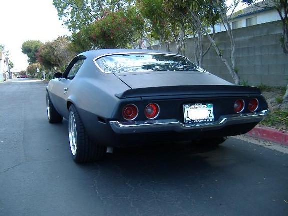

      I've got 315s on the back of mine. On 17x11s.

      Quote Originally Posted by POS71RS View Post
      looks good. no rubbing?

      Paso Robles, CA
      73
      No rubbing, but I had to roll the inner quarter panel up flat against itself. Also flattened the seatbelt hump a bit.
      Here's the sizes I'm running:
      Front: 17x8" 5" Backspace 255/40WR17
      Rear: 17x11" 5.75" Backspace 315/35WR17
