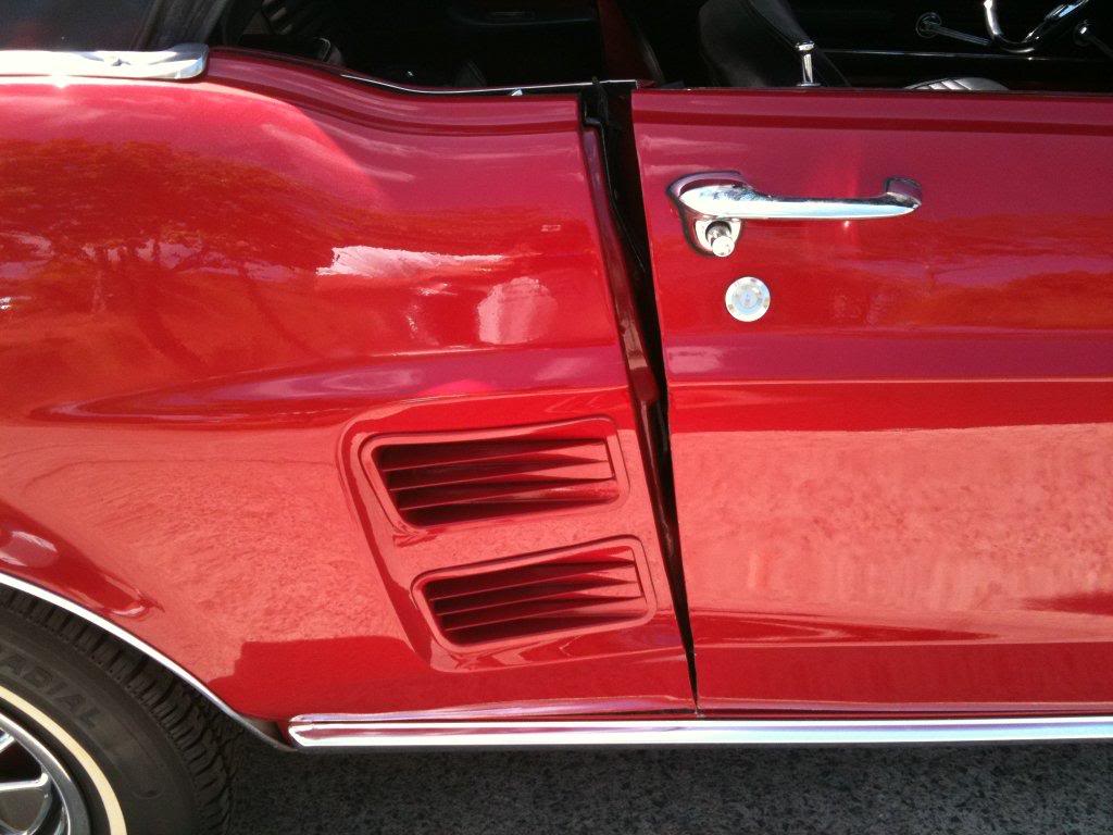

      I had a very good customer of mine that was looking at buying this car. Look over the pics and let me know what you think. (NO WE HAD ABSOLUTLY NOTHING TO DO WITH THE BUILD OR BUY) I got the pics too late to say anything.
      Seems like a nice car, price is great around $35,000 no way you could build it for that. Drives nice, underside looks nice, paint is very nice, can’t seem to find any rust or bondo problems, interior is perfect, everything works.
      So he bought the car thinking man what a great deal and great buy. He looked at hundreds of pictures of the car and yes this car was a full rebuild. Everything new on it.
      Look at the pictures and see just how nice the car really is.

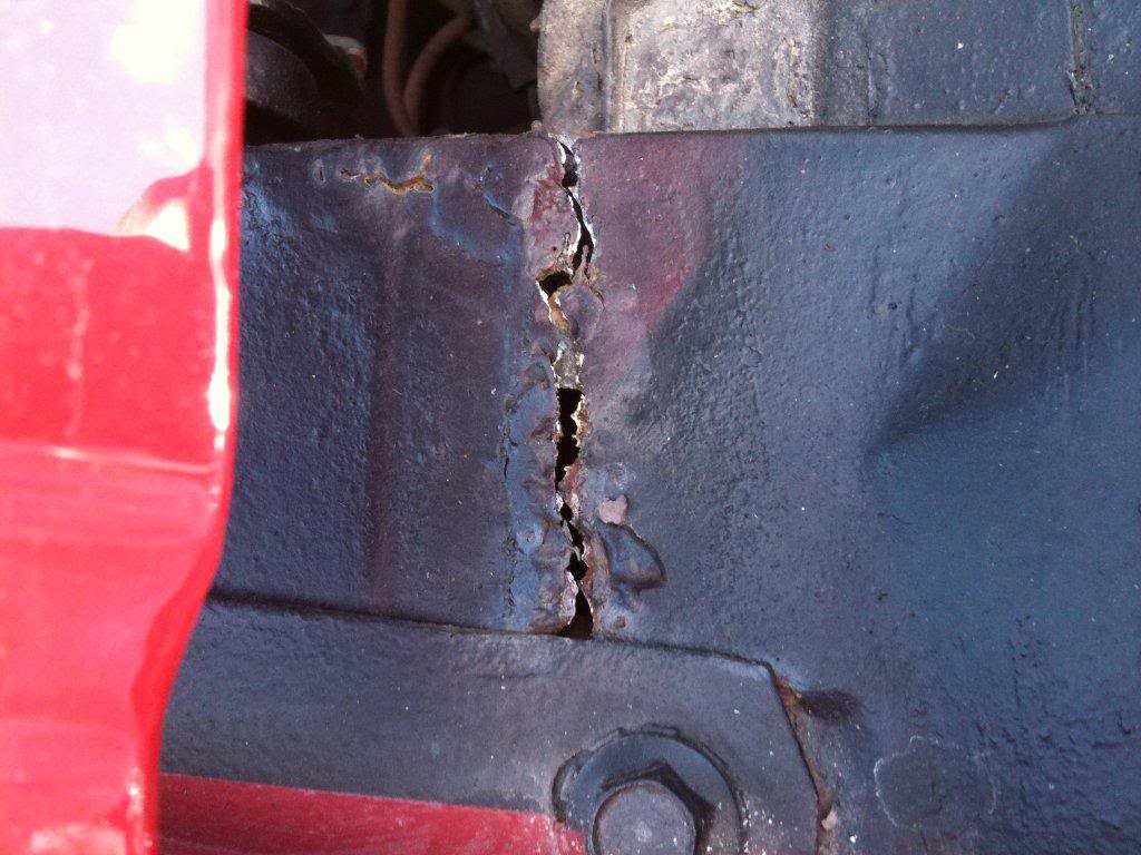

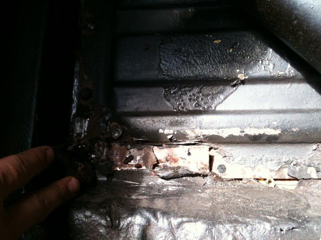

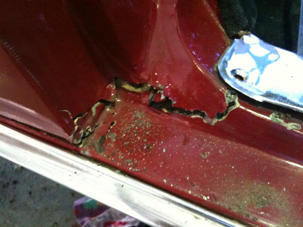

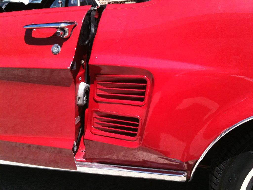

      Now to the sad part of this story, this car looked really nice and drove really well but the scum bags of today have really figured out how to take advantage of everyone so OPEN your eyes and know what you are buying.
      They put bondo over every part of rust but just thin enough that the bodo gauges had a rough time finding it. The complete underside of the car was coated and covered and looks completely factory. The work looked great and the average person would not be able to find this stuff.
      There are people out there that will spend a ton of time thinking up ways that they can take advantage of someone buy cutting every corner of a build to make more money. Hours are hours when it comes to building a car and if you are going to be serious about this in any way it’s time to stand up and put these people out of business.
      Yes the car broke into two parts all the way accorss

      • Pull up the carpet look under ask for pics of that build area
      • Ask for pics before paint if they don’t have them they did not paint it
      • Ask for engine out shots if they painted it with the engine in you probably don’t want the car
      • Ask for interior build shots see what and how they did it, I will post up some shots of what we see all the time
      • Pull up carpet in trunk climb in and check all the rust spots

      Wow, the car literally cracked in half!
      It is a good thing someone did not get killed while driving it.

      Holy crap! I wonder how long they were able to drive it before it snapped.

      OMG!!! I thought I had seen some of the crappest work done to vehicles. That is a lawsuit, it was represented as a driveable car when it was not. I'm sorry but at 35k (overpriced IMHO) I would go over the car with a fine tooth comb (I noticed the door gaps in the original pics) or at least pay the cost of taking the car to a trusted shop to get it on a lift and pull the carpets and backseat. If the seller refuses RUN! the other way. If it is too good to be true then it is, but I don't believe that was such a great deal even if it was a nice quality resto. Really what is a nice restored 67/8 V8 Mustang Convertible worth.....IMHO not 35k in todays market.
