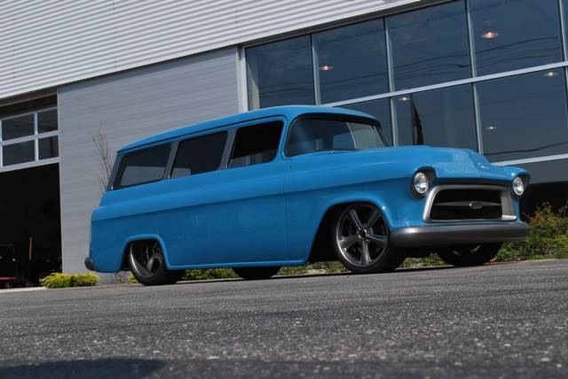

      About to head off to upholstery and wanted to get a few pics posted of our latest project. (The truck is not 100% completed yet.)
      Our customer was looking for something that could perform as well as one of our Chevelles plus have room for his family. He brought in a monster of a 57 Suburban and this is what we have created...
      Custom Roadster Shop Chassis
      Kenne Bell Supercharged LS7 (785 HP) by Turn Key Performance
      4L85E Trans by Bowler Performance
      20x9.5 and 22x12.5 Wheels w/ KDW Rubber

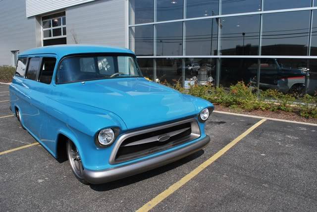

      Tucked and heavily modified front bumper
      Custom grille, grille bar, and grille surround
      Pie cut hood
      pie cut and sectioned entire roof
      Front doors lengthened (3" or 4" can't remember exact)

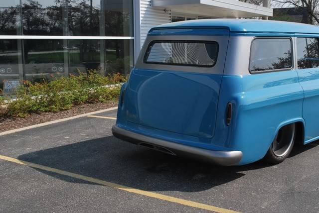

      Fabricated two rear doors, openings, pillars, hinge, etc... (Suburbans were only 2 doors until the late 60's, early 70's)
      Changed rear wheel opening shape
      1-Off LED brake lights
      Fabbed complete rear cargo door
      Tucked and modified rear bumper
