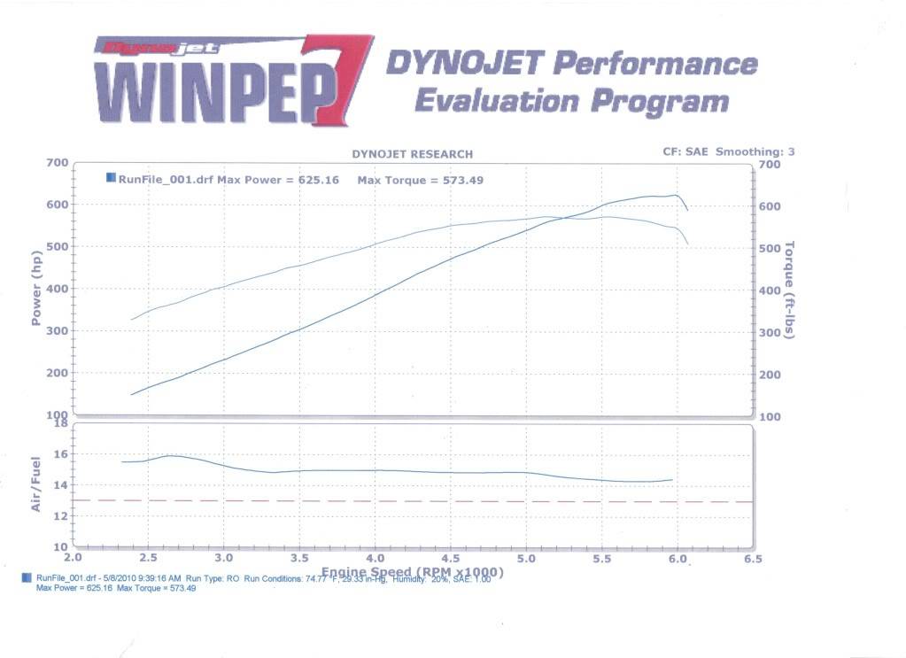

      ProCharger 3 inch core intercooler. No water or meth. 8.3:1 scr.
      Last dyno. for reference:

      Well, the latest dyno pull yielded 625 rwhp, with the drag radials spinning (smoking) on the rollers at about 5,900. I think the heads are the limiting factor. Disregard the a/f graph.

      That's more like it! And you didn't seem to lose any lowend torque or anything. Strap that thing down better, put a couple big boys in the trunk and spin it until the HP starts to drop - I bet she has more in her.

      Thanks, Jim. The engine obviously liked the bigger cam. I like how the bigger cam not only gave up nothing, but 500 rwtq came in 500 rpm earlier, and held on forever. I think the dyno drum is too smooth, we tried tieing it down tighter and dropping tire pressure, to no avail.
