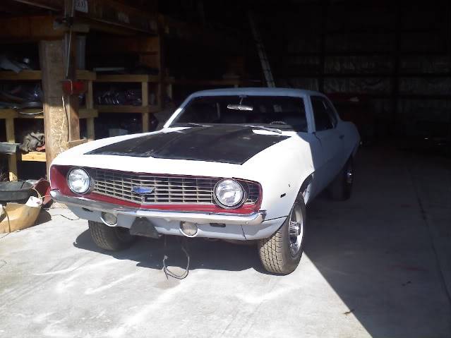

      '69 Street Fighter Camaro. just picked up the car today, someone has already replaced the outer rockers, inner, outer wheel wells and 1/4 skins along with the trunk pan. needs a small section of the frame rails repaired to be a rust free car. going to be an autocross/road track/street machine.

      niiice!
      cant wait to see what you do with it.
      looking good! good luck with the project!

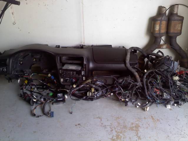

      camaro dash and full wire harness. (this is the second car i have done this swap too)

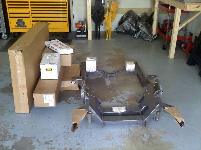

      Speed Tech frame kit

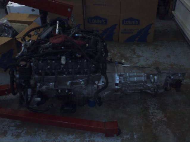

      2001 LS1 and T56
