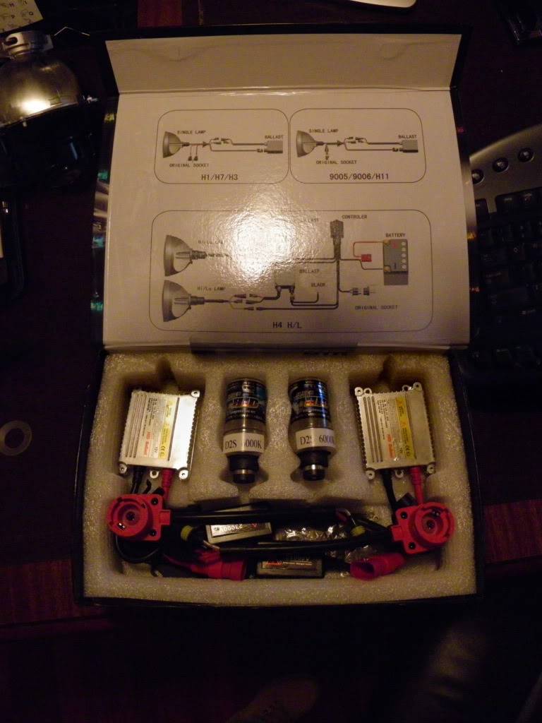

      Well My kit has arrived I looked for a different one other than the one on ebay. I got it from a local car audio shop.

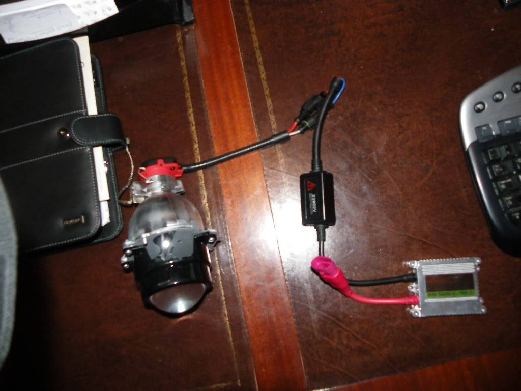

      Just test fired them up tonight! They work! now to retro fit them!

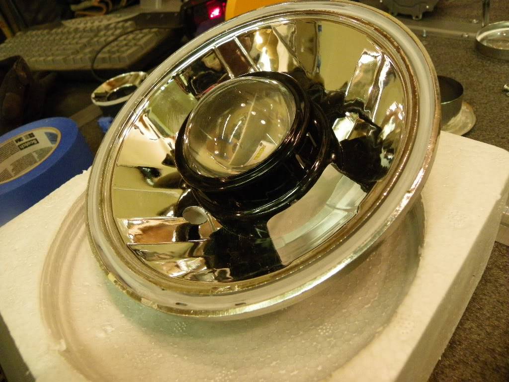

      I had a little time to work on the lights tonight.
      Here are the projectors fitted into the housings.
      And the link to the build pics.http://s300.photobucket.com/albums/n...light%20build/ Now have to fit them to The car.

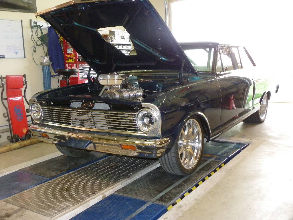

      Here is the finished Product

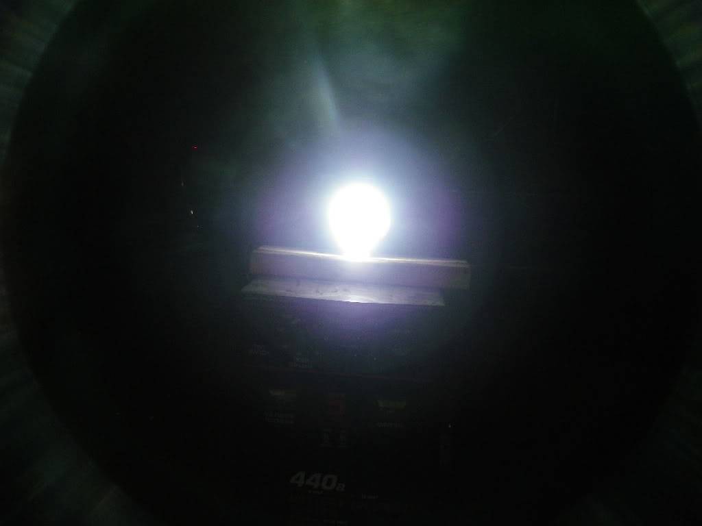

      If they were mine, I'd remove the tri-bar. On an H4 the bulb tips are painted anyway, and the light is bounced off the reflector, but on the projector lens, it is blocking a vital area in the center of your light path. JMHO

      I thought that too about blocking the projector. Tried it both ways and it did not change a thing. So I kept them.

      It will block a small amount of light, but it probably wouldn't be enough to distinguish a difference. Considering the additional light output you have I don't think I'd worry about it. With the bar installed, do you notice any additional light leaking outside of the intended pattern? My thought is that the light is reflected from the bar, onto the rear reflector, and back out the headlight.

      No I have not noticed any difference and I have removed the tribars to see if there is one.
