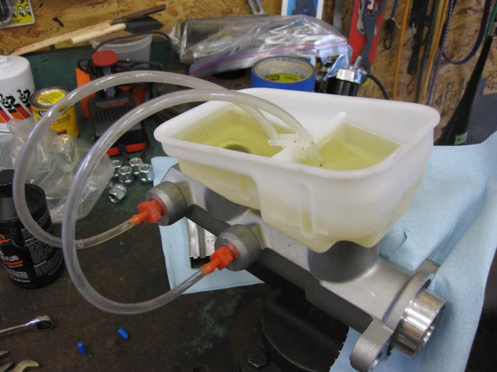

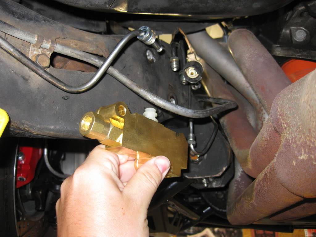

      This is the second Inline Tube brass prop valve I have installed...the first one leaked out of that lil front valve/button thingy.
      New Aluminum Master Cylinder...my old one started leaking randomly as soon as I replaced that prop valve!!
      Douglas Lutes

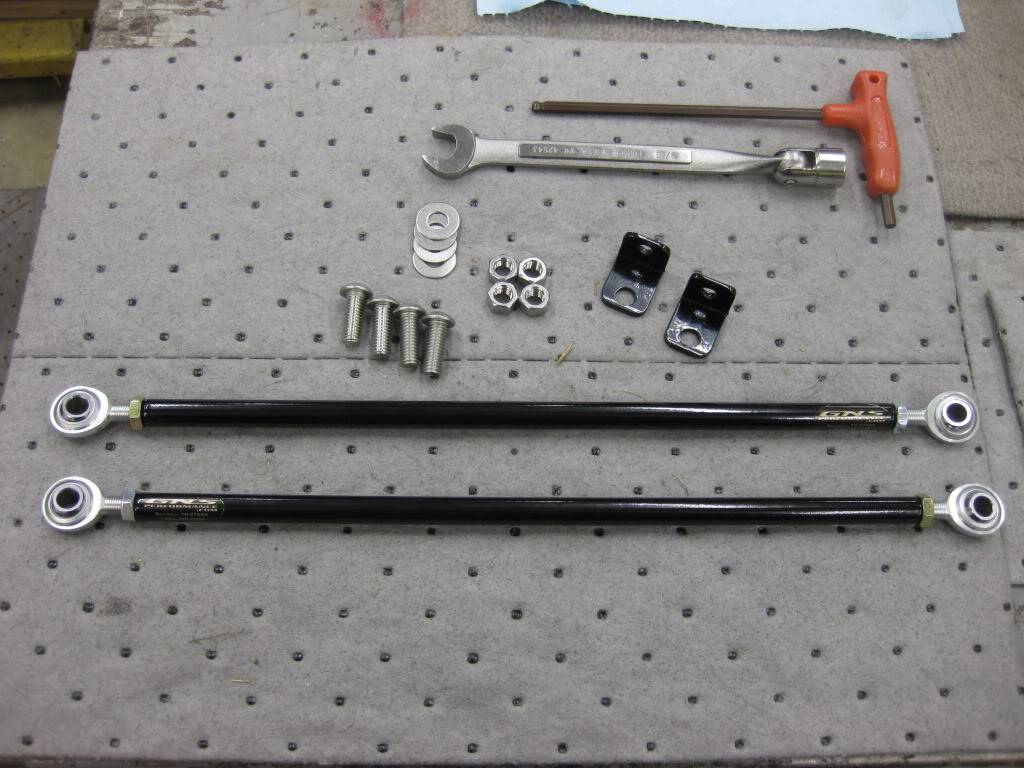

      Now I am going to do a lil write up on the install of the GNS Performance Fender Brace kit for a G-Body
      Here is the kit all layed out and tools at the ready. All you need is a 7/32 allen wrench and a 9/16 wrench. I did put some anti-seize on the hardware since they are all stainless steel.

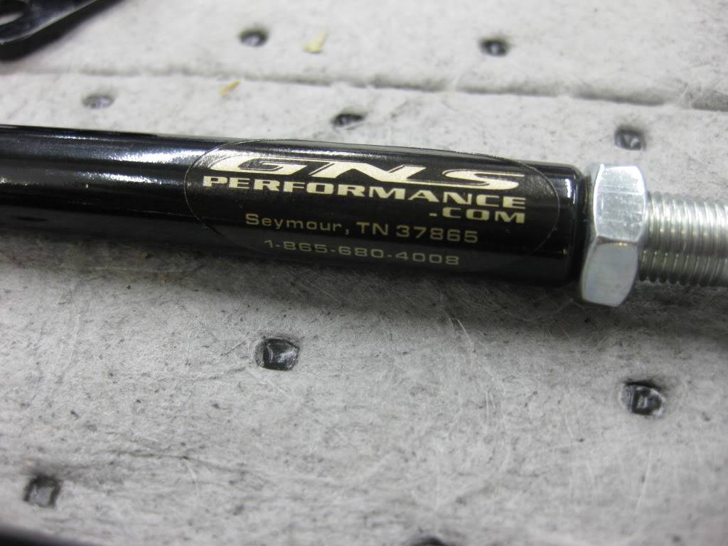

      Contact info...had to give the company free plug!!

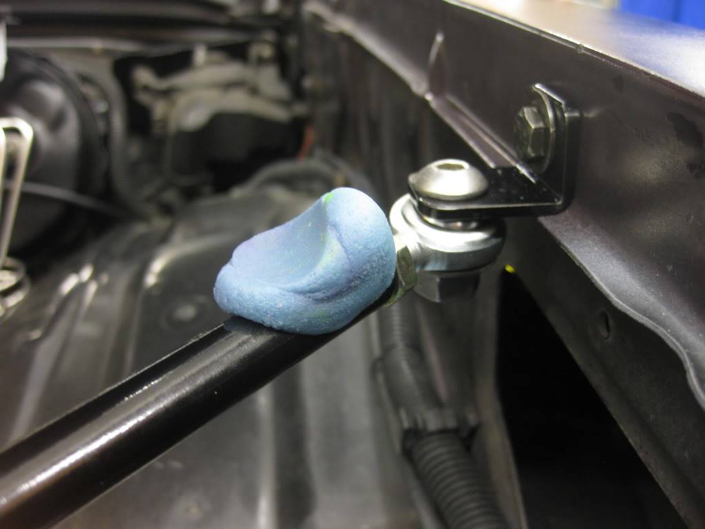

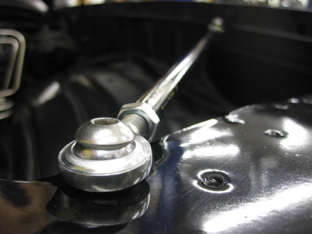

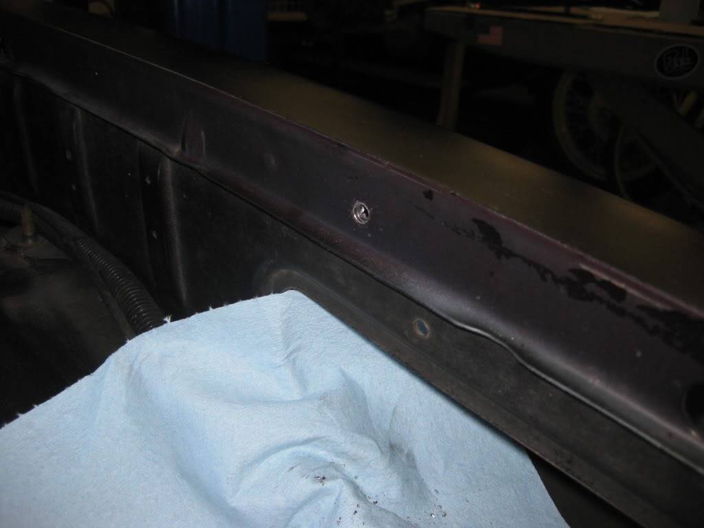

      First step was to find out where the fender mounting brackets were going to go. These were meant to bolt onto the third fender bolt on a Grand National Fender. A Monte Carlo SS doesn't have this bolt so a hole had to be drilled. I assembled the braces and found where the hole will be placed. After center punching and drilling the hole this was the result.

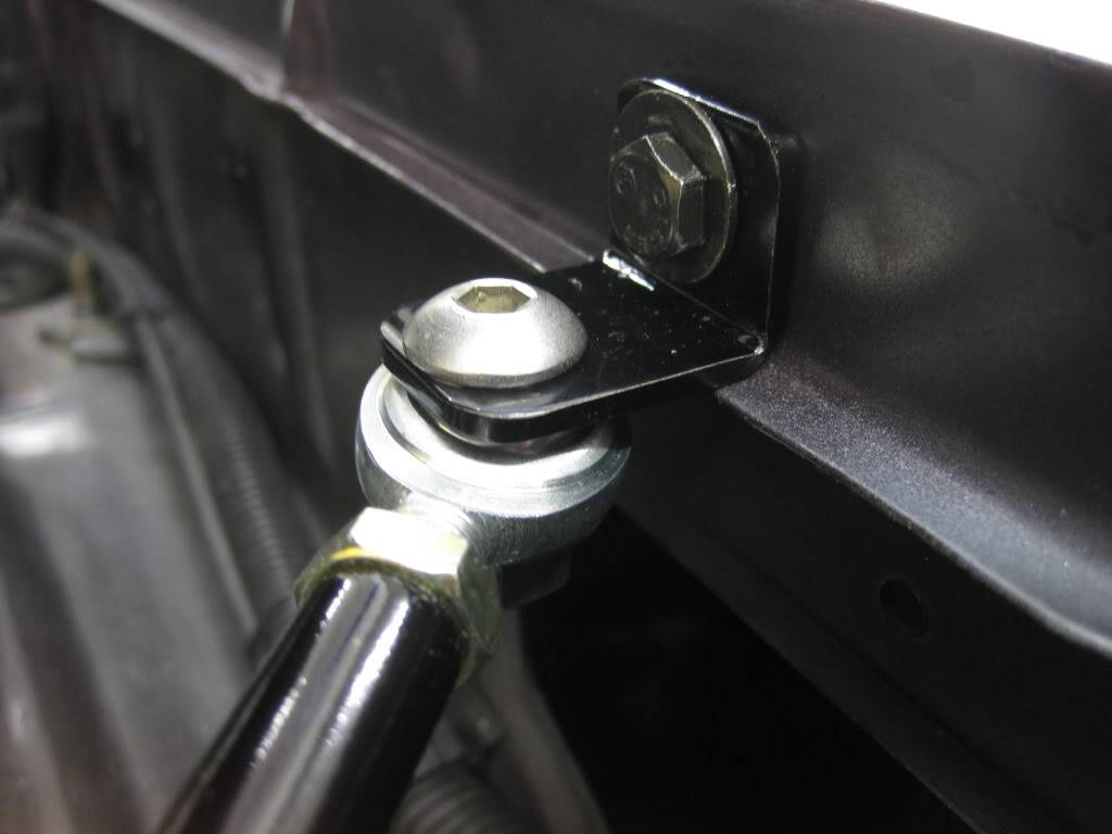

      I found some black hardware in my shop and bolted the "L" bracket to the inside of the fender. I used a nylon lock nut.
      I was curious as to how my Harwood Cowl hood would fit with these fender braces intalled so I checked the hood clearance with some putty. The hood has no clearance issues!!

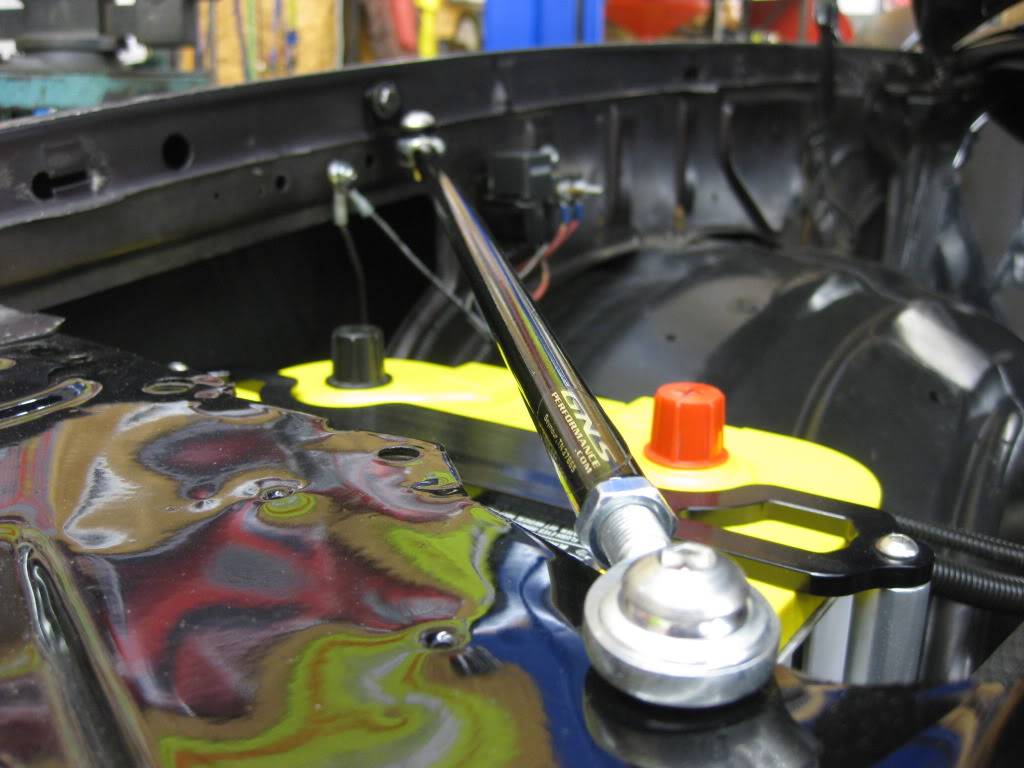

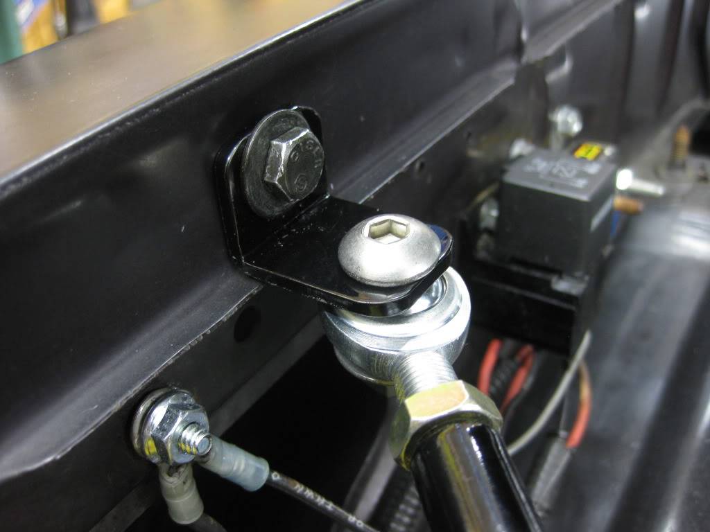

      Here is the drivers side brace all mounted up.

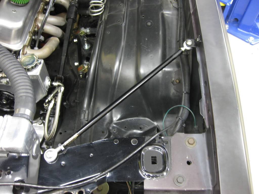

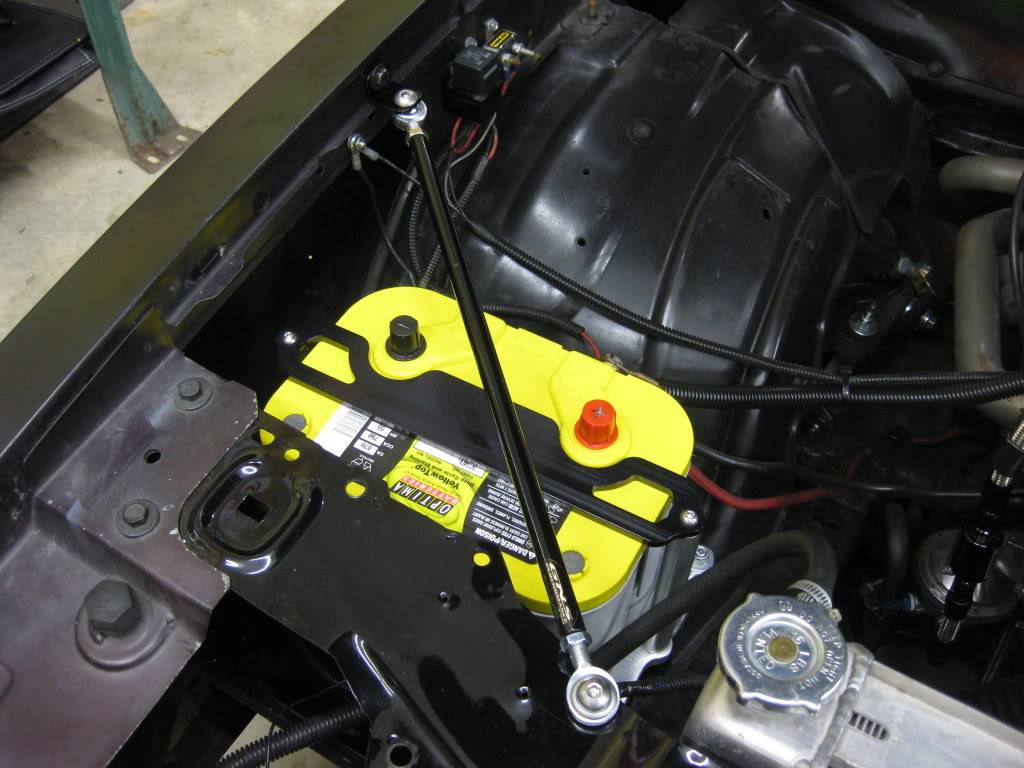

      The passenger side brace installs the same way as the drivers side!! Find the correct position for the fender brace mounting bracket, drill the hole and install it. It's that easy!! GNS Performance does include a direction sheet in the package that explains how much tension each brace needs..
      These fender braces install easy, are a quality product, and look killer under the hood!! I drove the car with these installed over 300 miles this weekend and they did not come loose and performed perfectly!!
