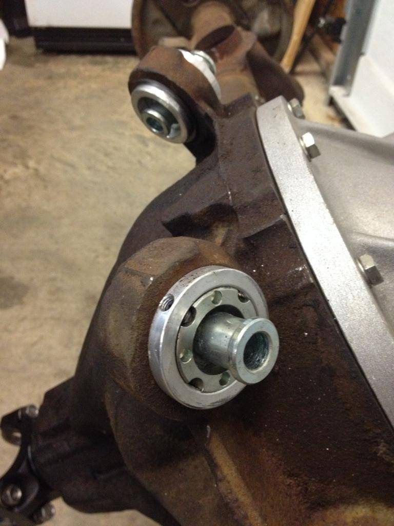

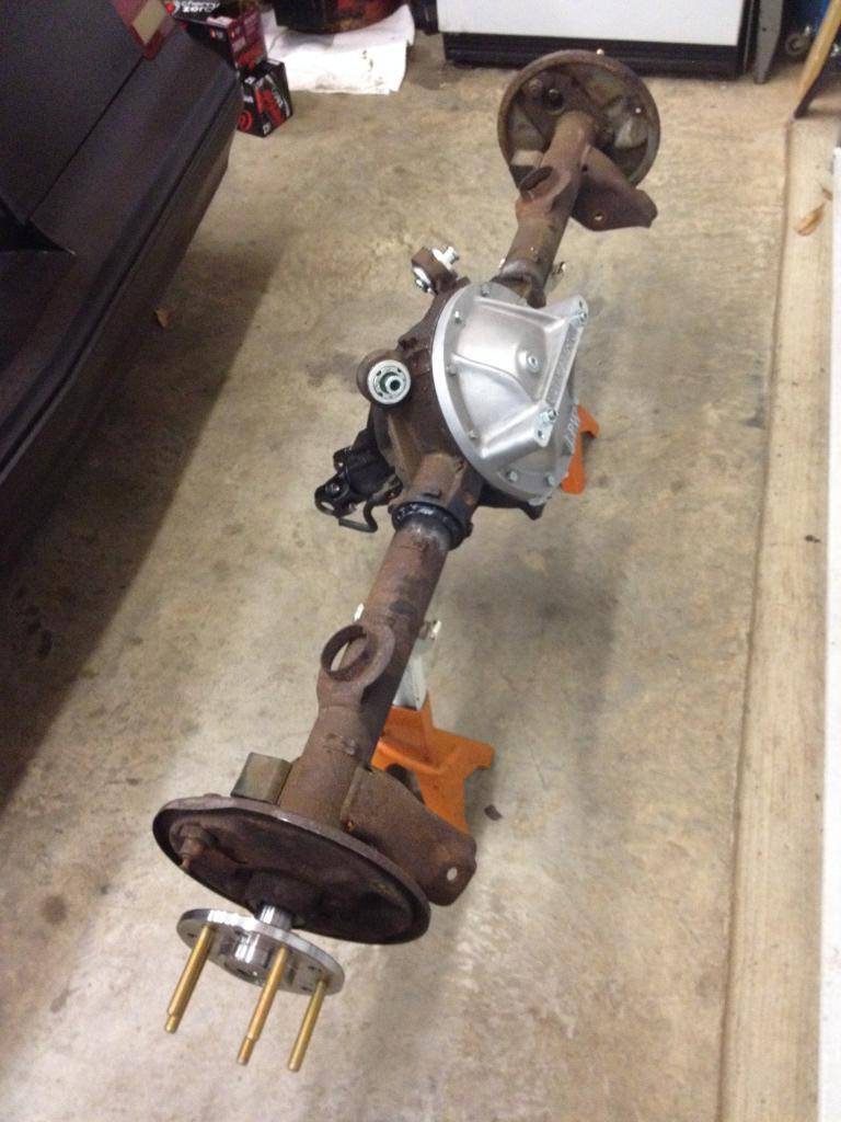

      I got the rear end back...all I have to do now is paint it and determine what I will be using for my LCA relocation brackets. I hear UMI is coming out with some trick stuff soon............
      The rear is a GM 8.5" 10 bolt with 30 spline Moser Axles, Tru Trac Diff, 3.73 Yukon Gears, Inland Empire 1350 forged yoke, a LPW Ultimate 10 Diff Cover and the UMI Performance Roto Joints. This is a bad mofo.

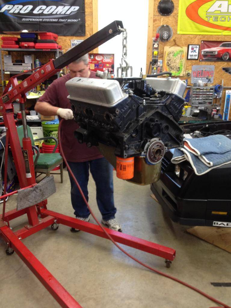

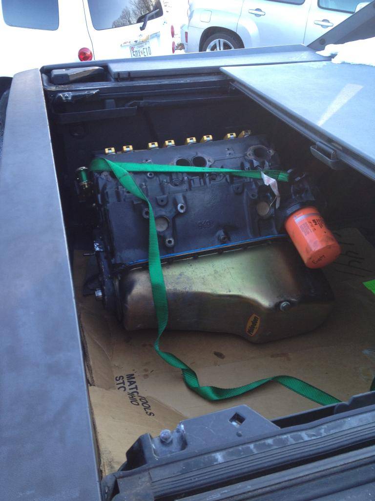

      I decided to pull the motor in order to swap out oil pans...and this quickly turned into me taking the motor to a machine shop to rebuild since I only had 4 psi of oil pressure at idle.....sooooooooo

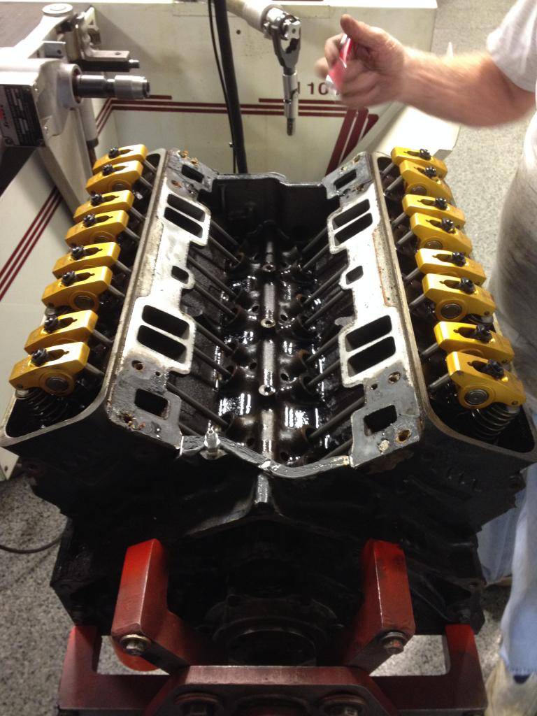

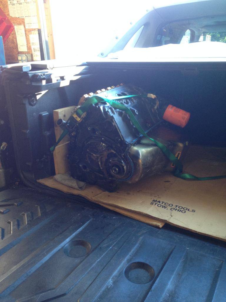

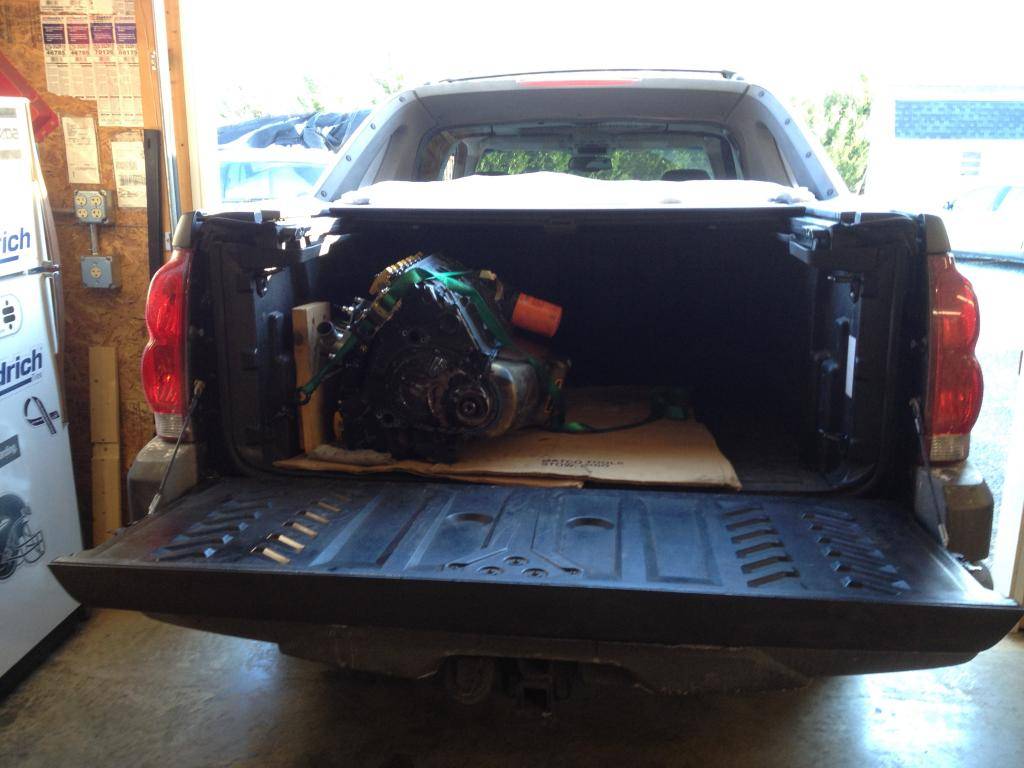

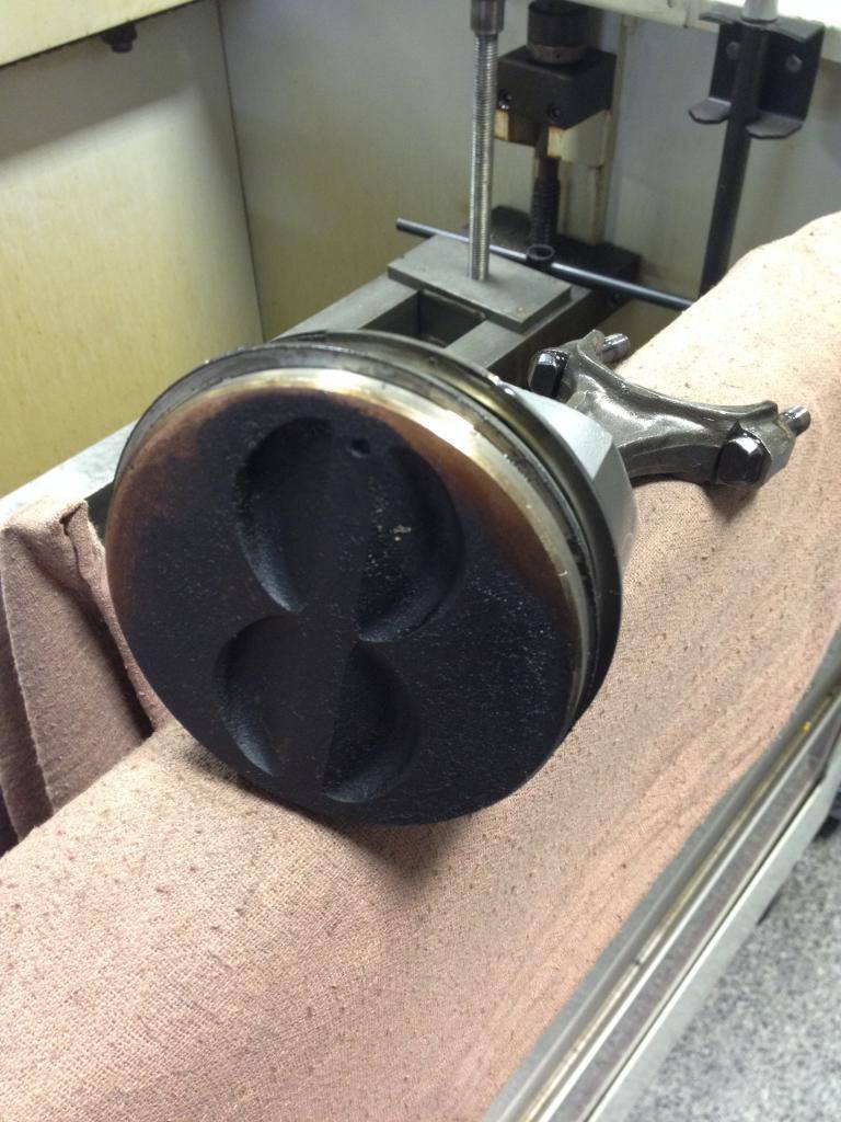

      While it is at the machine shop......

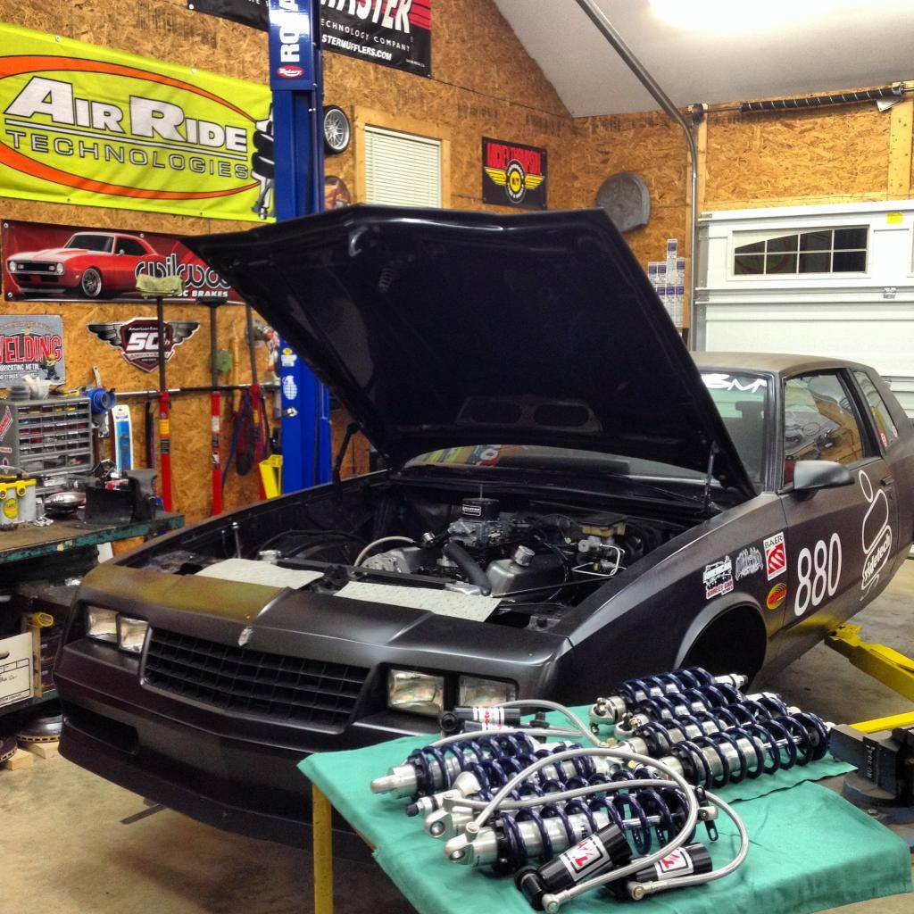

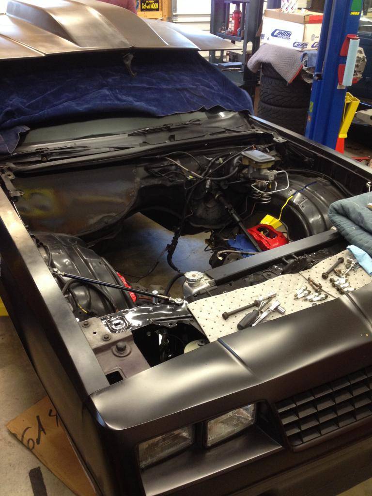

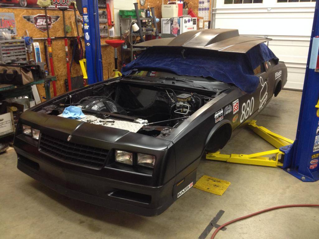

      Here's the car as she sits......
      So I decided to put up my partner banners and film some stuff for my YouTube page!!!

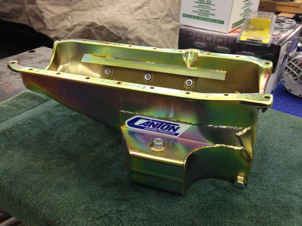

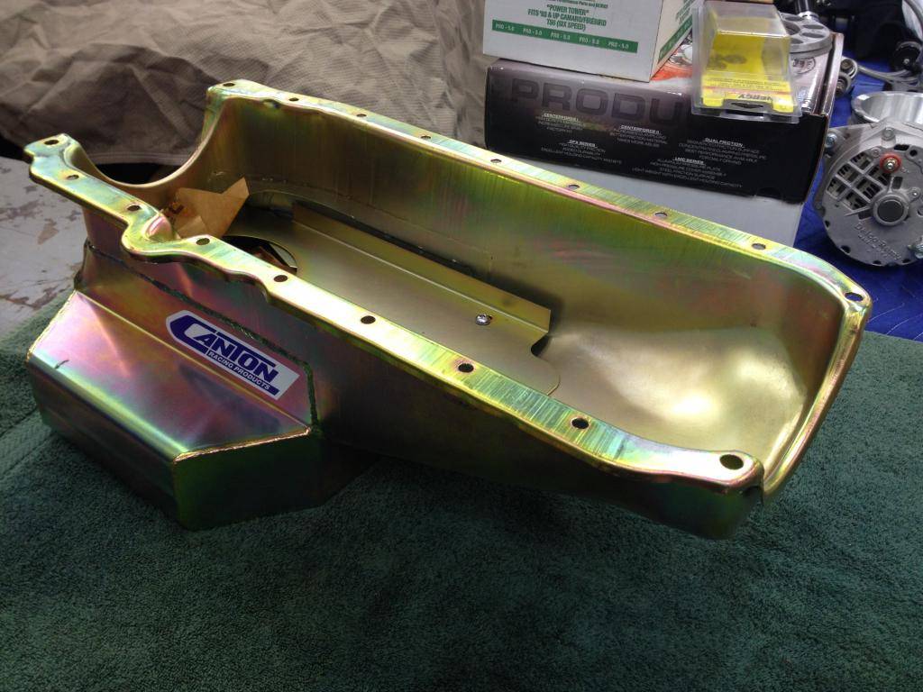

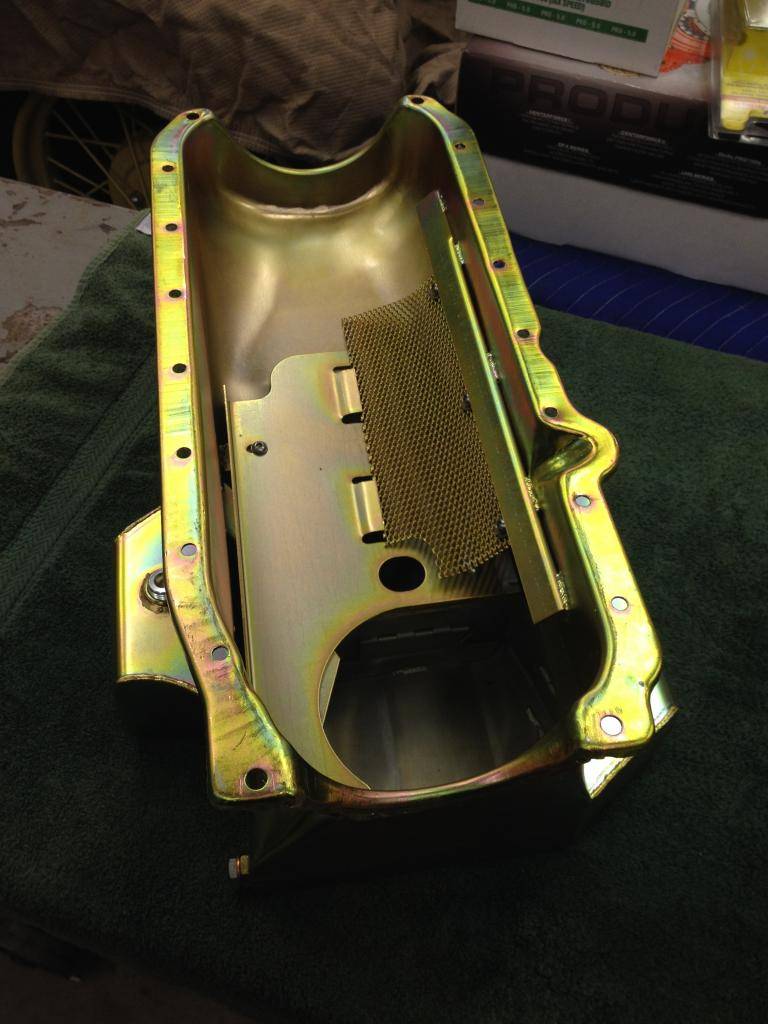

      Pics of my Canton Road Race Oil Pan and FelPro one piece gasket.

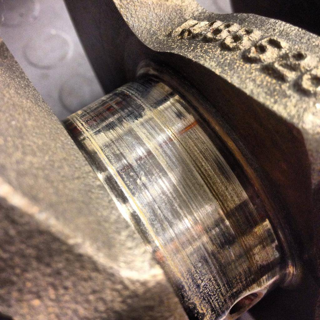

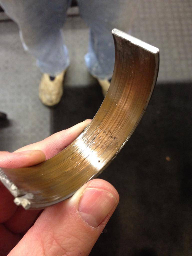

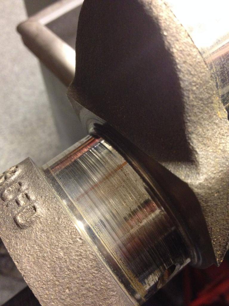

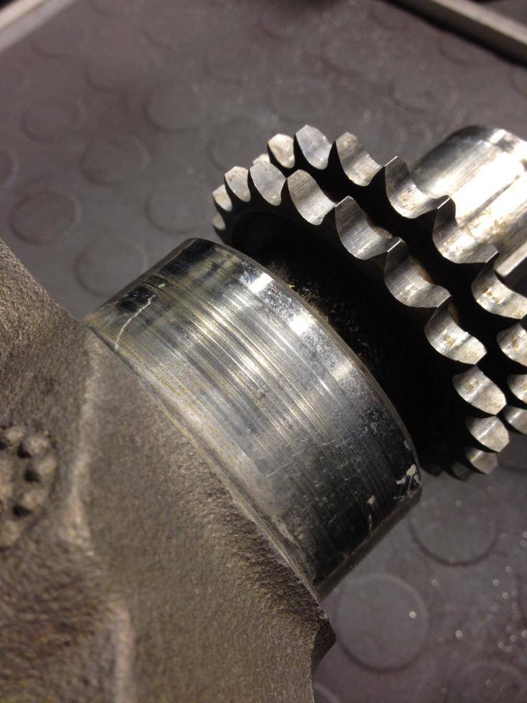

      So I went to the machine shop tonight to talk about the motor. Remember I had 4psi of oil pressure at idle and this is why.....everyone of my main bearings was destroyed and the crank main journals were so worn that they looked like a mountain ridge. Nasty!!!!

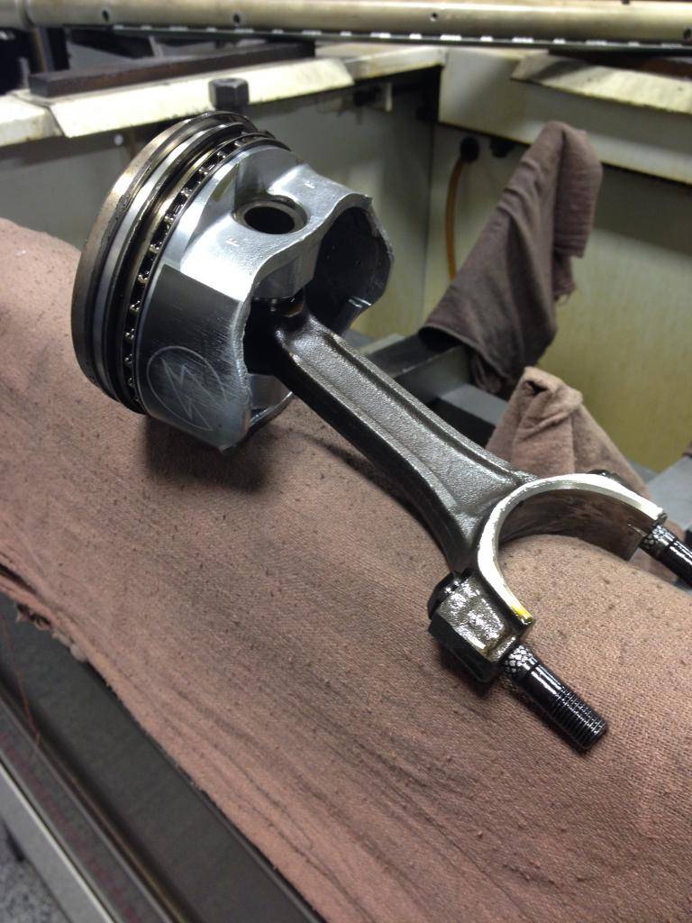

      We will clean up and reuse the rods and pistons.
