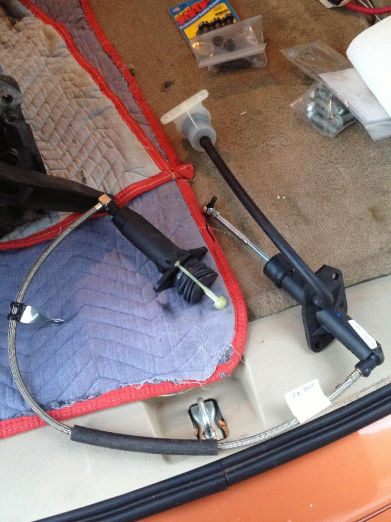

      I had a mechanical speedo conversion done on my tailhousing. I did not want to run an electric speedo.

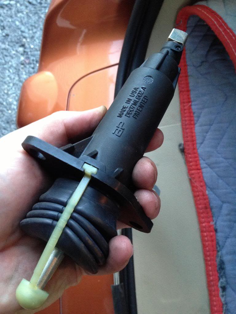

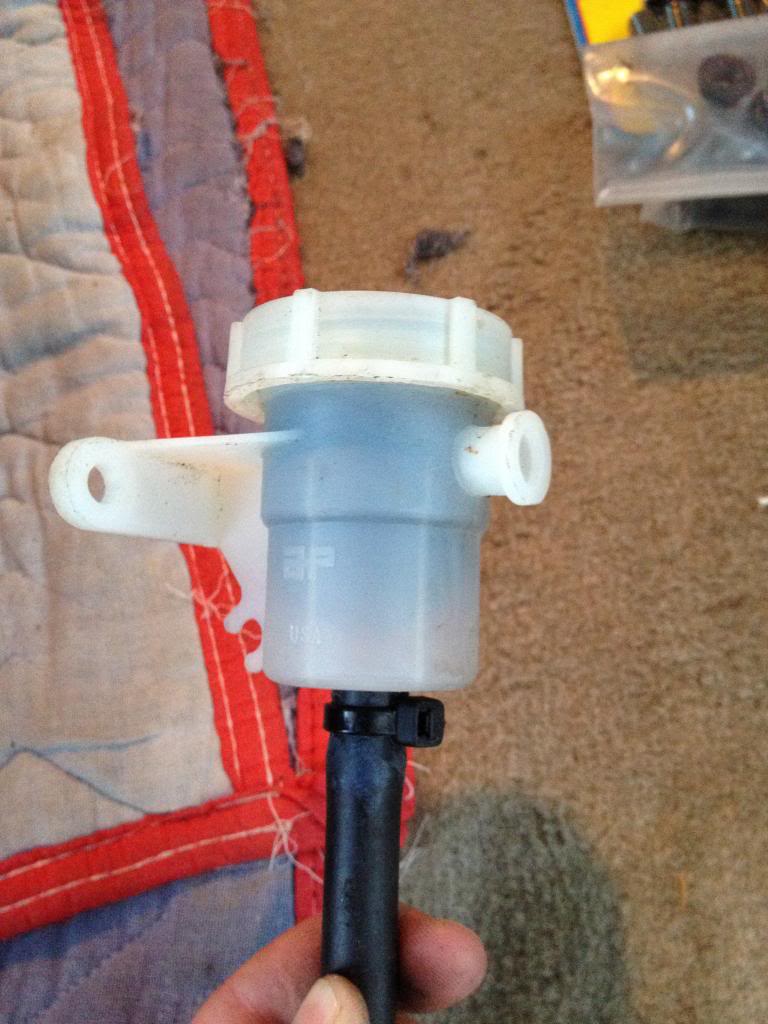

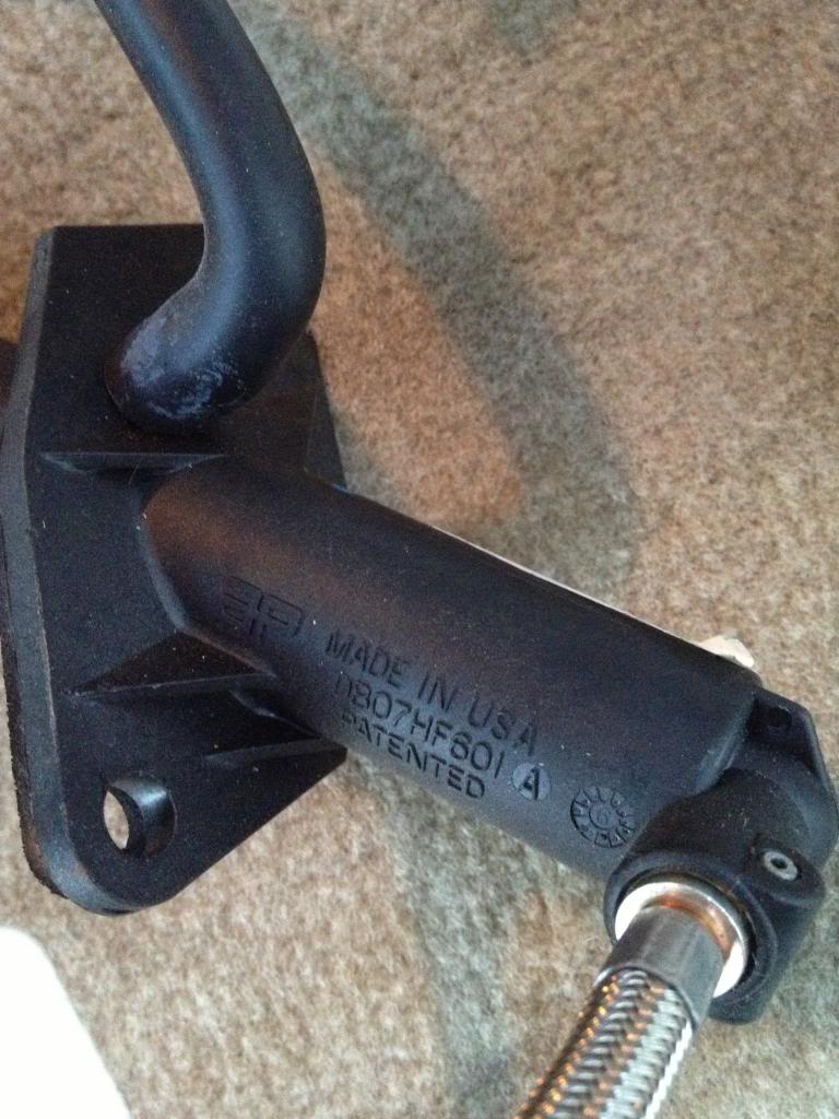

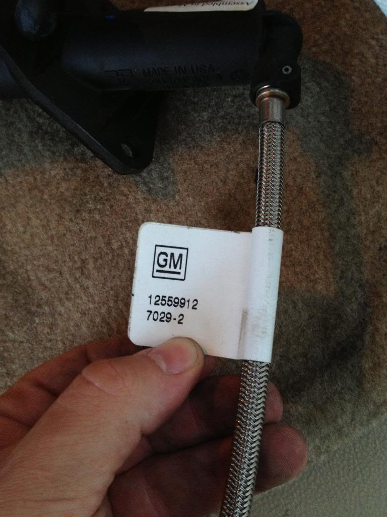

      I used factory pedals, LT1 style hydraulics (GM# 12559912) with the Speedtech's pedal adapter and firewall mount.
      I ditched the factory aluminum bellhousing and used a McLeod Scattershield (Sum# MCL-8760-00)
      I also used McLeod on evrything else.

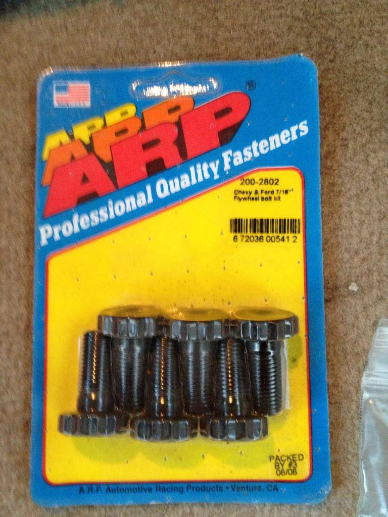

      Flywheel (Sum# MCL-8760-00)
      Clutch kit (Sum# MCL-75216)
      Roller Pilot (Sum# MCL-8605)
      Hurst Shifter (Sum# HUU-3915061) I had to get a white shifter ball for it...could not get used to the black one.
      I also had to have my trans built, as it was bad to start with.
      Works great now.

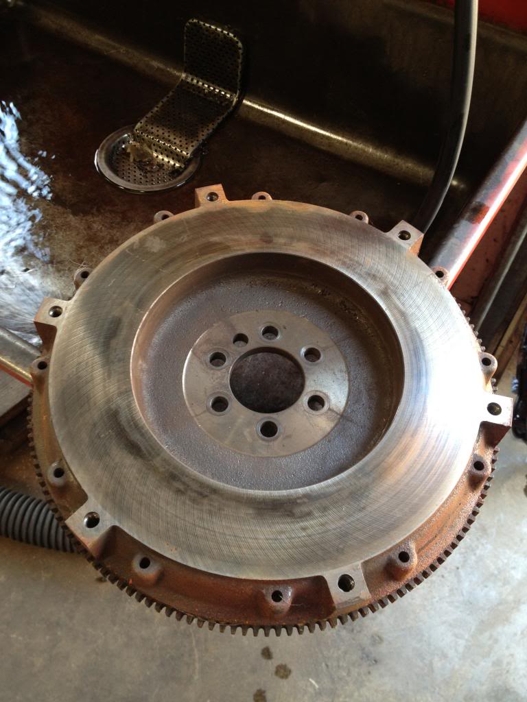

      Quote Originally Posted by SicMonte View Post
      Looks like that flywheel is externally balanced. I don't know offhand whether your engine is balanced internally or not, but that flywheel may need to be rebalanced to suit.
