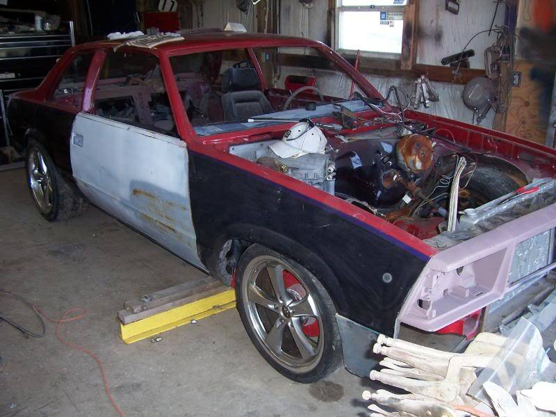

      Heres my 79 Malibu project. I havnt worked on it for over 6 years.
      Had it down at my farm in the barn. I did a frame off on it back in 96' when I was "just" going to repaint it.Then it turned into a frame off.

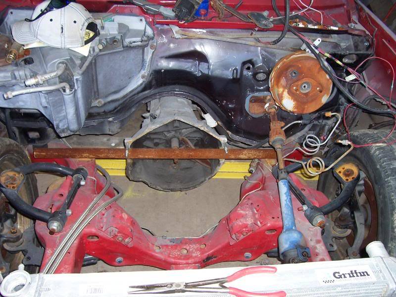

      It has all the hotchkis control arms in the rear. In the front it has the 12" B body spindle swap with the Hotchkis upper arms and tie rod adjusters, and has a monte carlo SS steering box. I have for it a set of bilstien shocks and Eibach springs. I do not have sway bars yet.
      I know some people say the suspension is not up to par for superb handling but back in 96' this was the hot set up,I thought.
      I have the 19"s off of my 95' camaro under it in the photos just to get an idea. I know I have to notch the rails and the widen the wheel tubes. On to the pics.
      The rear wheels are 19x10.5 with 295/35 bfg's
      The fronts are 19x8 with a 245/35 seem to fit really well

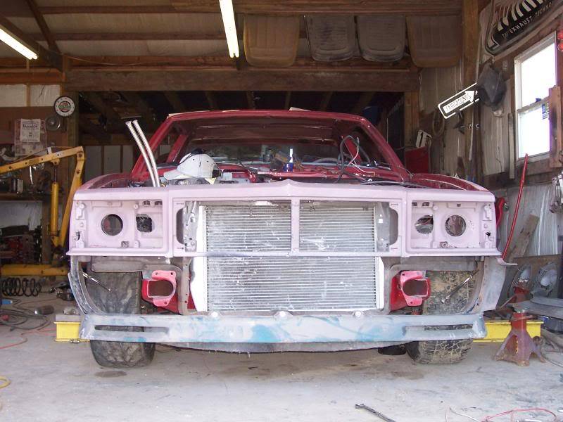

      Heres a shot of the somewhat smoothed fire wall and the frame/suspension
      Heres ashot of the front end mocked up. I found the elcamino chin spoiler at a swap meet for $10 bucks!

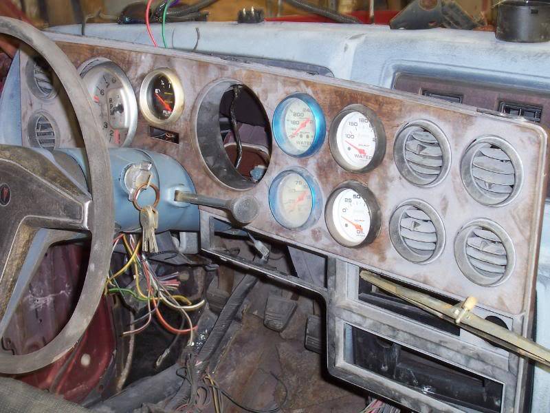

      Heres a shot of the dash..Its an Idea, The panel is out of a pontiac.I like the way you can run 7 gauges and still have the a/c vents.

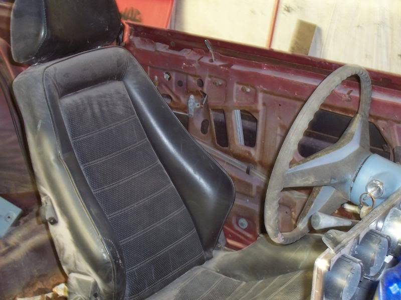

      Heres a pic of the Recaro seats I found in the salvage yard. They're out of a late 80's/early 90's BMW if I remember right. It bolted down to the out side seat mounts with out any modifing. I have to fab up some mounts by the tunnel because the car was an origanal bench seat car.

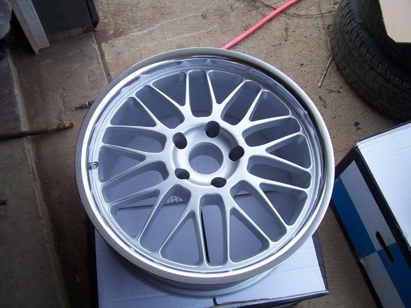

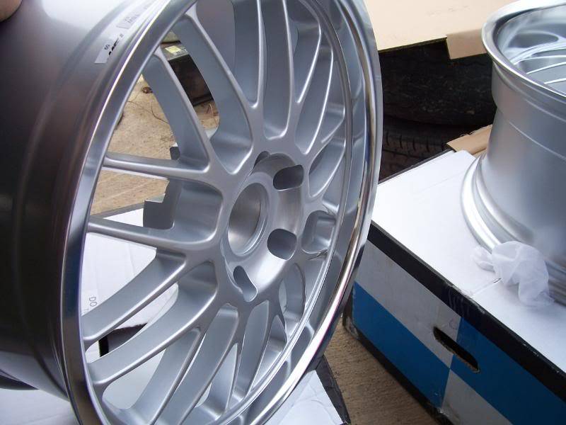

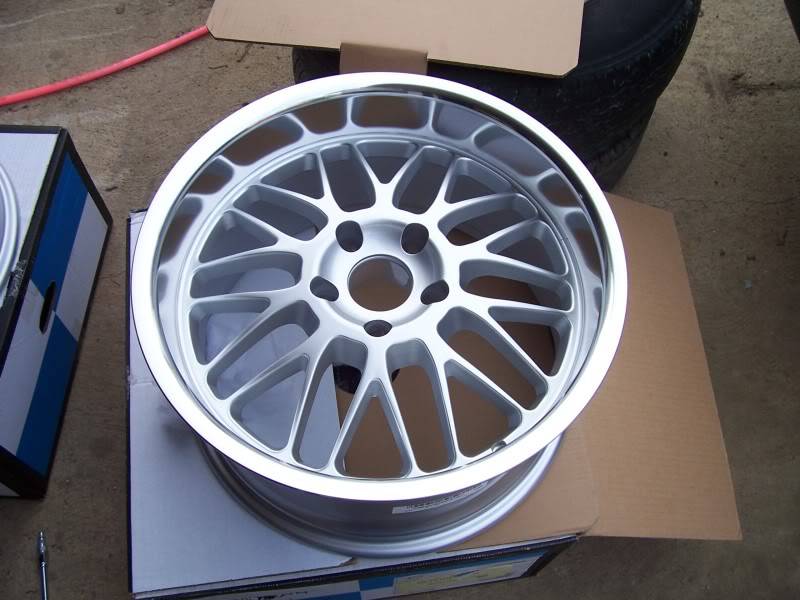

      I ordered my new wheels yesterday and 2 of them showed up.
      They are 18x8.5 Beyern Mesh
      The rears are 18x9.5"

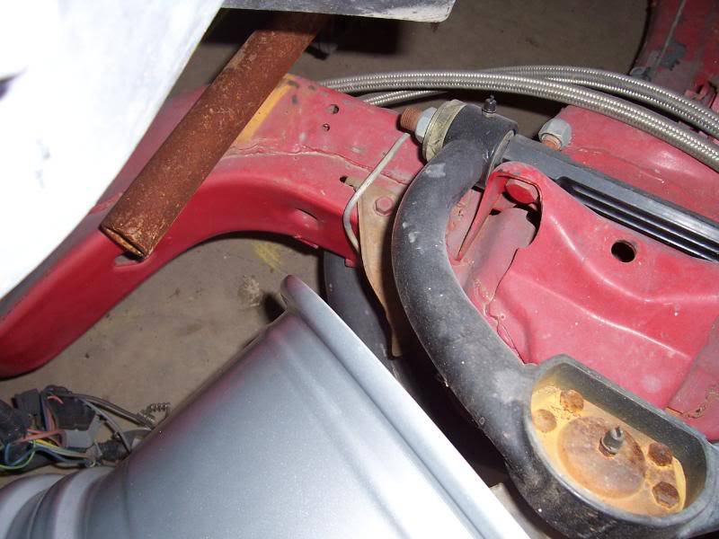

      No rubbing issues in the front
      This is how close to the wheel is to the lower c/a.
      Theres about 3/8"
      Looks like it will be close with a 245/40 tire but we will see.

      Question. Are those wheels 5X120 or 5X120.65? just curious since I really like them. If they are the BMW 5X120 pattern, what are you going to do for mounting them. Nice build by the way.
      Kevin
      73 Nova
      355/TH350 (soon to be T56)
      07 Trailblazer SS AWD
      Stock (for now)
      Aug 2009
      Suncity FL
      76
      Beyern makes wheels for BMW applications, their parent company is TSW. I only know this cause ive been doing research for those exact wheels on my 69. Cant wait to see it done with them on!
