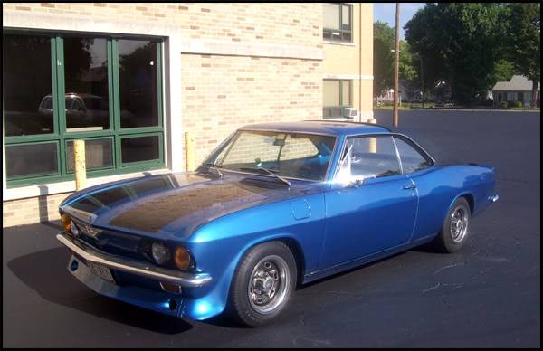

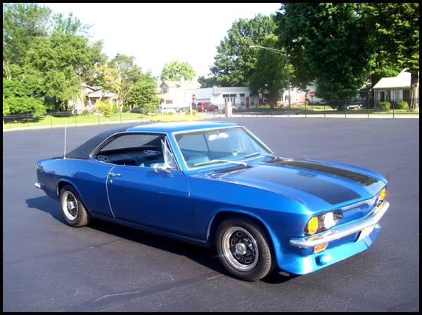

      I decided to sell the second gen Camaro that I had originally planned to build up, and do something a little different. After thinking about it for a while, and then coming across this corvair on Ebay, I knew that I had to change direction and start a new project around this car. Introducing project "The engine is in the back????":
      I flew out to Indiana last weekend and drove it back 13 hours straight to NY - from an hour before sunrise to an hour after sunset (in the rain, the entire way). Now the fun begins - first thing's first, have to fix a fuel leak at the fuel tank and at both carburetors, and I need to rebuild the steering box because there's about 90 degrees of play in the steering and it's a little hairy to drive. But hey, it got me home.
      After the initial mechanical repairs are done, I'll start to think of improving the handling. It already has Yenko sways on it and appears to be lowered. I'd like to get a set of 16" black Cragar steelies and some nice tires to replace the older Nova wheels and tires. The motor is cammed and has some carb and ignition work done. It's fairly quick, especially for a Corvair. Who knows, maybe one day it'll get a V8 swap (a guy can dream, can't he?).
      Anyway, just introducing the project. I don't have any particular plan, just a general plan to improve the car over time little by little. It won't be a dedicated race car so I'm keeping the interior, just going to modernize it a bit and increase the handling as much as possible. I'll be double-posting here and on my website, but the site is just a build log - the real fun is getting everyone's feedback on the forum!

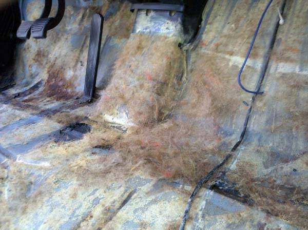

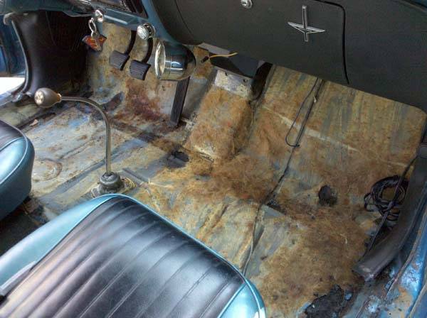

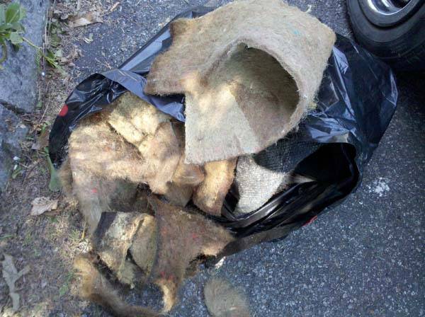

      While I'm waiting for my parts to arrive, I started taking out the old damp carpeting:
      I need to pick up a gallon of Goo Gone to remove the rest, it's all stuck to the flooring. Here's my collection:
      During the week I'll do more, I just wanted to get the wet carpeting out of the car as soon as possible. I plan to POR-15 the flooring and lay down brand new carpeting and insulation as soon as it arrives.

      I can't specifically tell but the vinyl top deal is most likely a "Fitch" treatment or at least a knock off of it.
      http://www.corvaircorsa.com/fitch.html
      Sort of like a Yenko but Fitch....

      Yeah, it's a fitch roof - I believe that some of the interior treatments are also fitch but I'm not sure. I know it's not a full blown fitch sprint but it does have some fitch touches here and there. I'd love to paint the roof body color so it blends a little more with the rest of the car.
