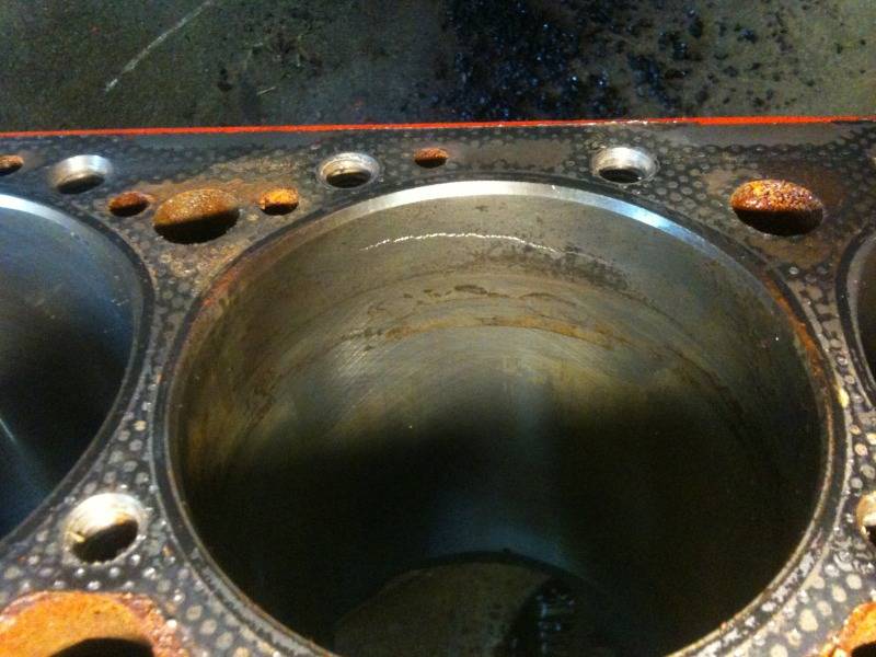

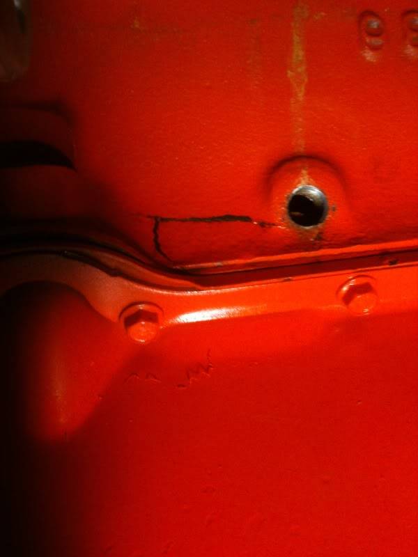

      The crack slowed my progress. Here is a pic of the crack I found.

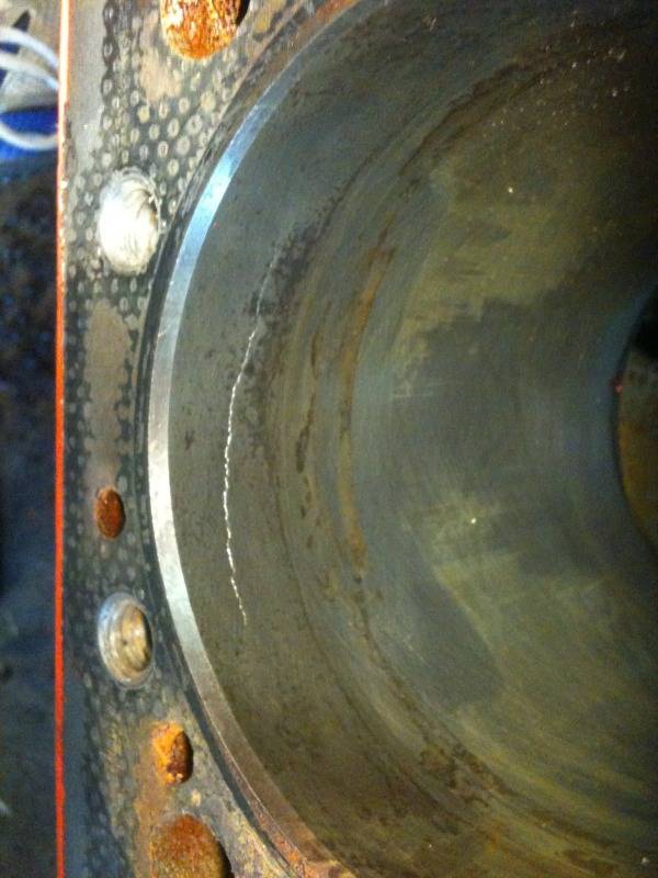

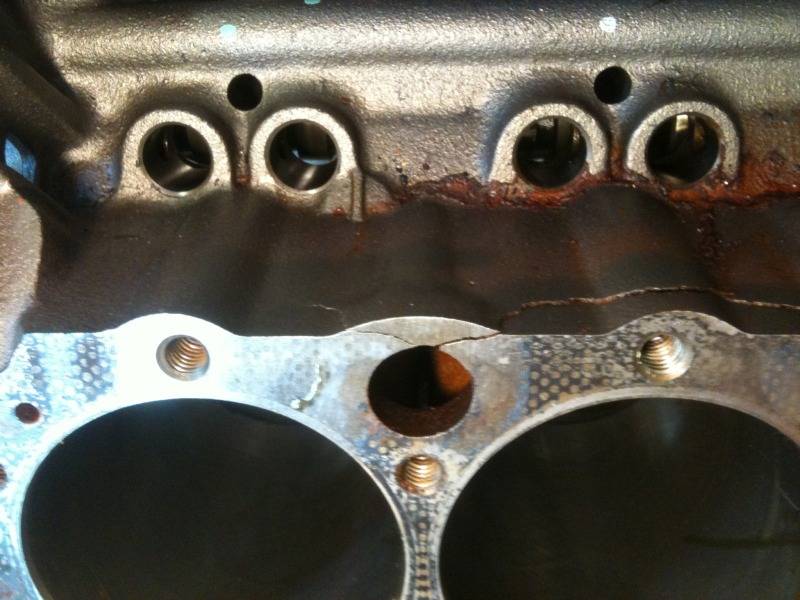

      I was going to have it welded and be done with it, but after pulling the intake, I found this,

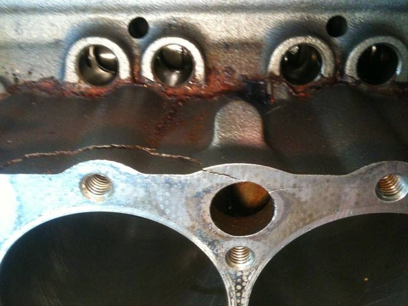

      And after pulling the heads I found this,
