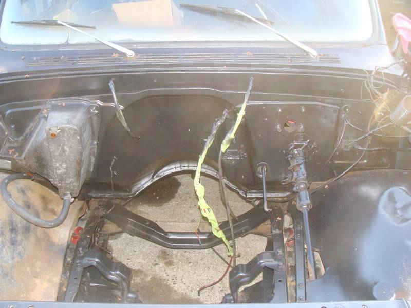

      Currently I am cleaning the underhood area, to repaint,
      The six is out.

      Got the underhood area striped and painted with some black epoxy primer.
      Tommorrow, I install they stainless steel brake lines, and mate the 350 to the muncie 4 speed.

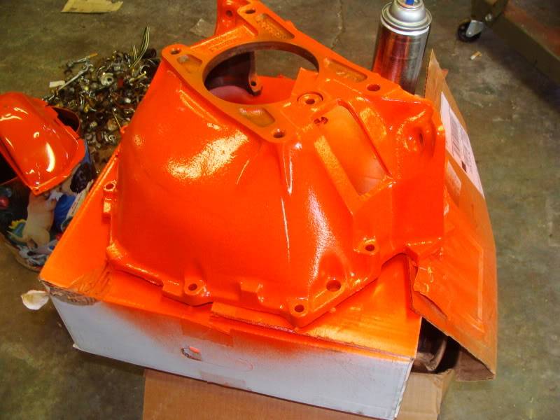

      Not a whole lot to update. Been raining so have not been able to do much work, other than some cleaning and spray bombing.

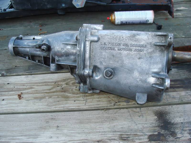

      Here is my Munice that will replace the 3 on tha tree,
      Stock bellhousing after a lot of elbow grease, and paint,

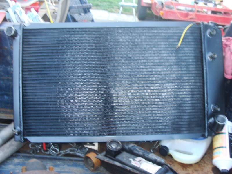

      New Ebay aluminum Radiator, painted to look factory,

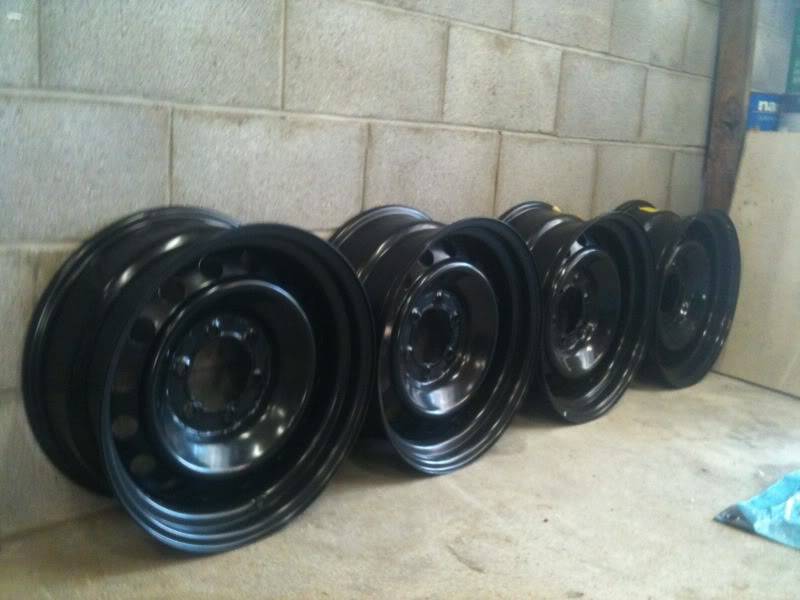

      In keeping with stock appearnce, but pro touring advancements, I picked up these wheels,
      They are 17x7.5. I am unsure if I am going to leave them black, paint them white, or ralley silver, thoughts?

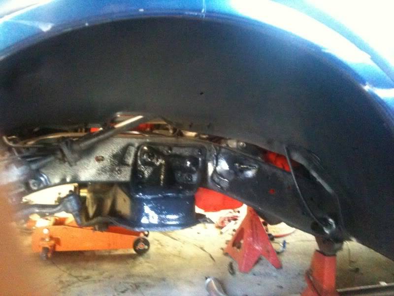

      I stripped the underside and painted it all with the black expoy primer,
      Then reassembled it all.
      I converted it to 74-87 parts, with poly bushings, and all new parts.

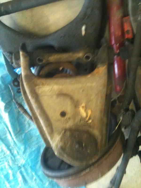

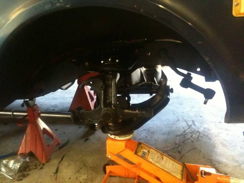

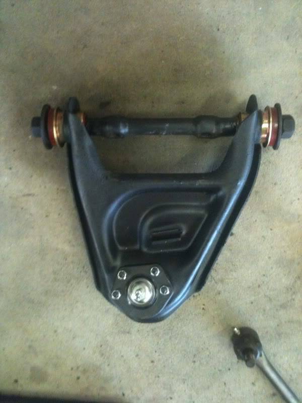

      I am using CPP 3" drop springs in the front.
      The difference between the 69 a arms and the newer style is amazing. Much bigger, much bigger bushings,
      here are the uppers,

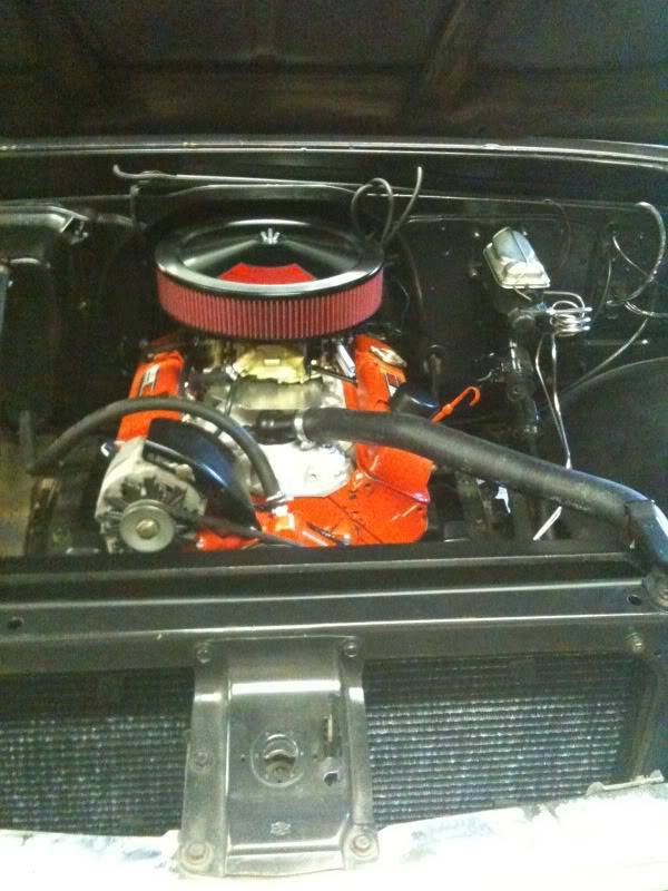

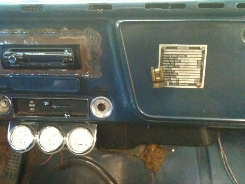

      Engine installed, with the holley carb,
      Government Asset tag,

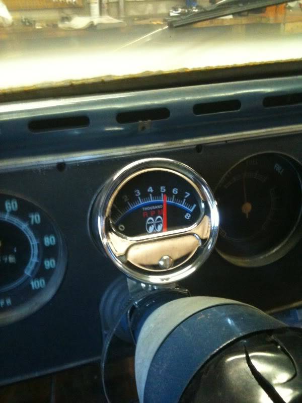

      Old school style Moon tach,

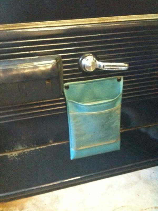

      This is cool, not sure if its a dealer add on, or a custom made deal, I call it a saddle bag.

      I love what you're doing with the truck!! I've though about doing something like that but I only ever see the camo blazers and box vans.
      Useless gee-wiz info..... So thats a forms pouch mostly used to hold the AF Form 1800 which is the operators guide and servicability report.
      Quote Originally Posted by Johnny Blaze View Post

      Someone somewhere else told me that too. Been trying to get one of those forms printed off!

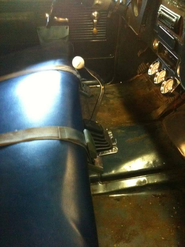

      Here you can see how close the shifter is,

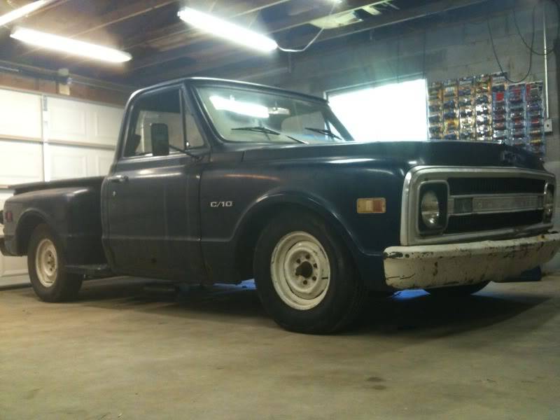

      I just realized there were no full truck shots,
      here it is after the v8 install, it actually sat the same as it did with the inline 6. Of course this is on cut stock springs.

      looks really cool. i'd go with silver or white for the wheels.

      I am leaning towards ralley silver for the wheels.

      The engine has an aluminum high flow water pump ( painted orange) Aftermarket HEI, black moroso plug wires, routed under manifolds.
      Intake is a Performer.
      The only major deviation is the electric fan, but I just love the thermostat controlled fans.
