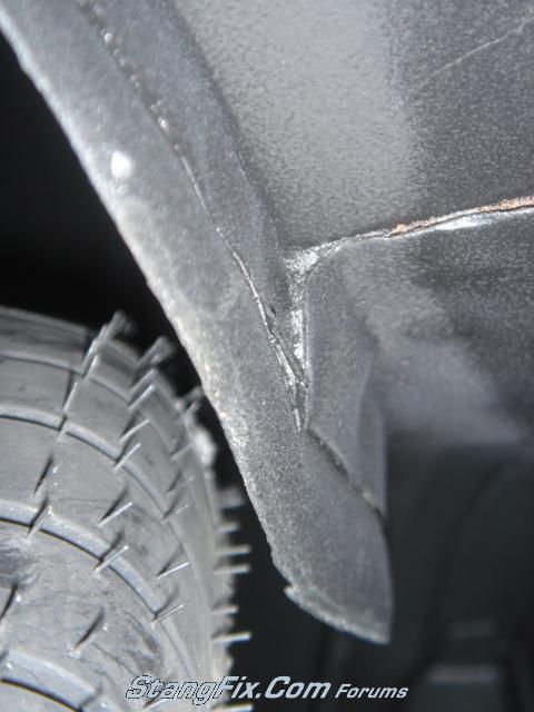

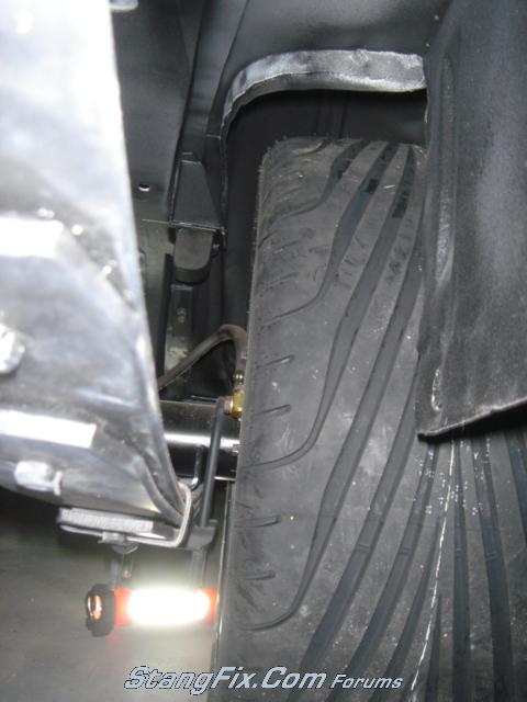

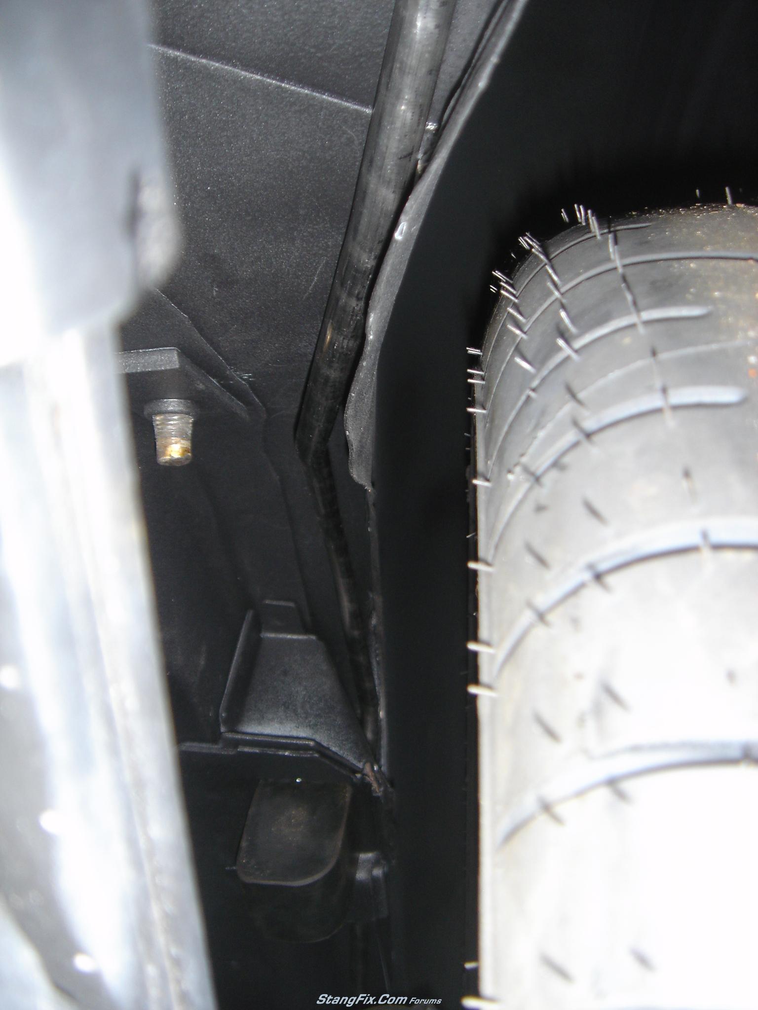

      Found this picture, it may help as well
      The lower front is the closest part. I used a BFH to make a little more room
      Before (about a fingers width, maybe 3/4-1")
      After
