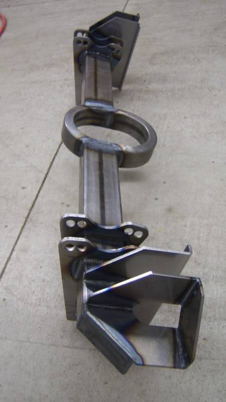

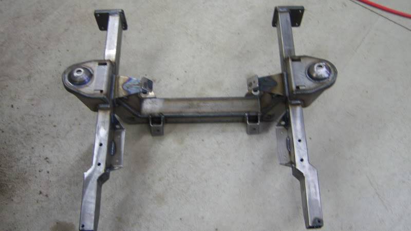

      We got the suspension in today. Nice looking parts indeed!

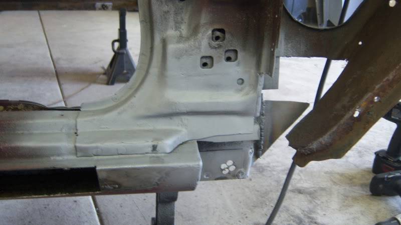

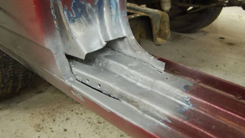

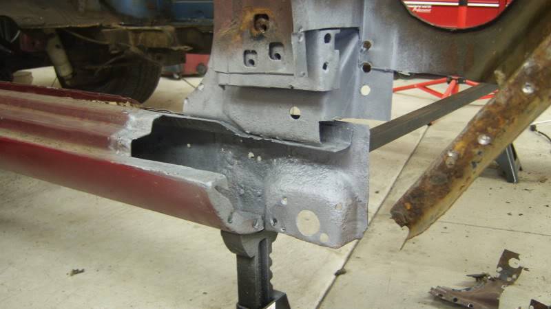

      Welp, got some rust repair in the making. The two front lower pillar spots, we have to wait untill we get the new cowl sides to see where to rebuild the pinch weld to.

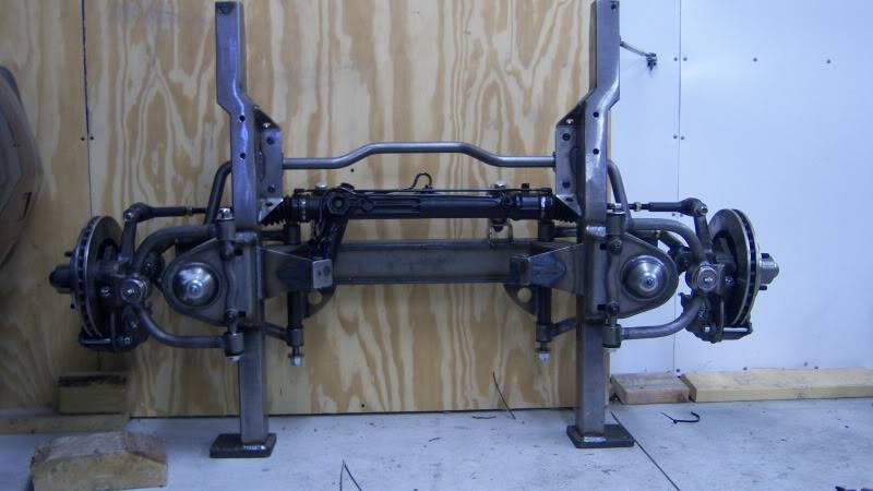

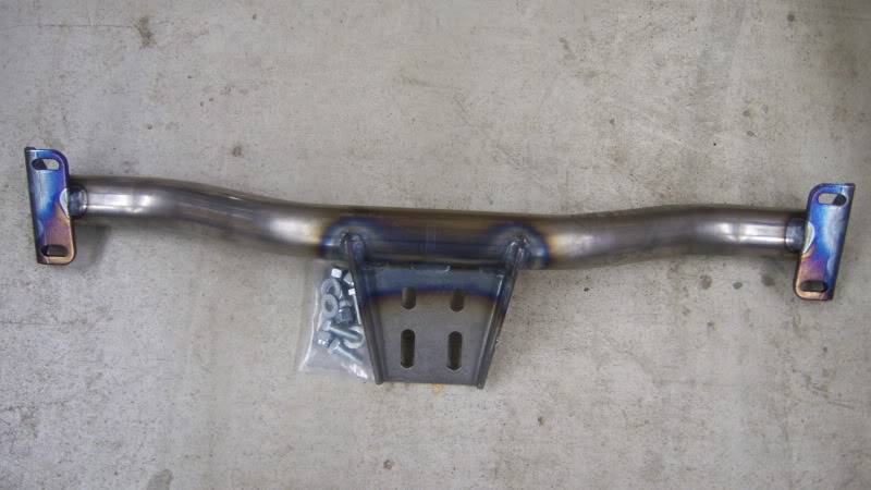

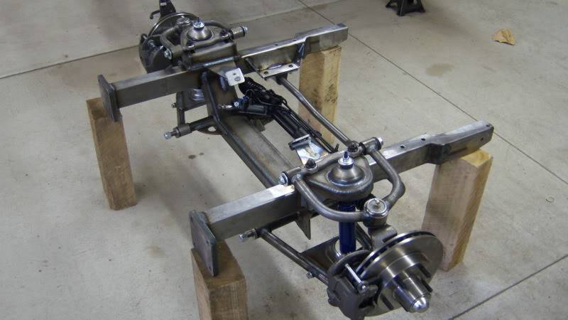

      Got some parts pictures for ya as well. Threw the front suspension together to make sure everything works / and that everything is there. We just had to run a tap into the A-arm sway bar endlink holes.
      Got all the rear suspension parts as well. We will be going with a 9" rear, and will be centering the pinion.
      Right twards lunch today we got DSE's deep tubs in as well. Checked out the video and it seems pretty self explanitory. The kit comes with templates and everything is a real clean/factory looking installation.
      The only thing were wondering as of yet, is how the TCI 4 link is going to fit under there with the deep tubs. Anyone else know/seen? I guess well find out!

      Our 4-link will need just one small modifcation to work with the DSE tubs. The outer/upper lip of the coilover crossmember will need to be modified to fit the newly reshaped frame rail. Everything else will work perfect as supplied.
      If you have any questions just give me a call, my direct line is in my sig.
