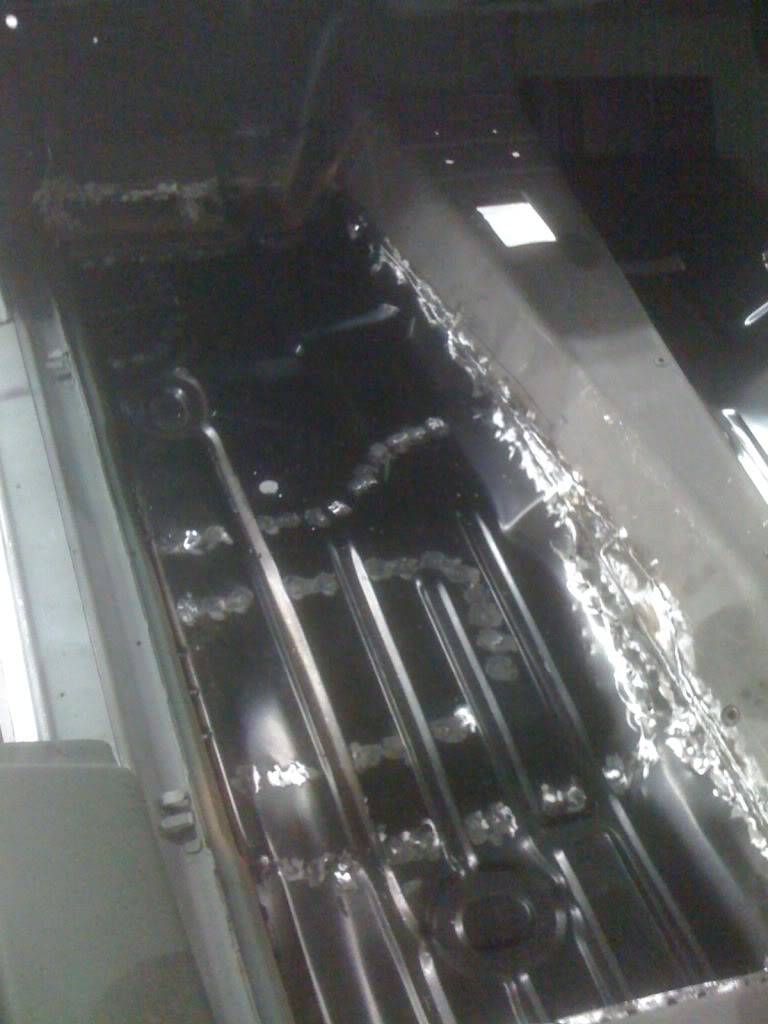

      Little update... Finshed installing the floor pans. I installed the powder coated subframe and 12 bolt rear end we got from a 69 camaro built in the shop. Also installed a pair of GWS subframe conectors with their soild mounts. I'll post some pics if I can remeber what site I used to upload....

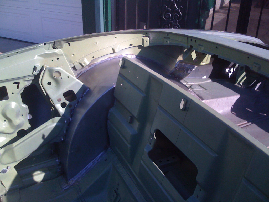

      Wow, I havn't posted for awhile. So far I have the front sub frame and all the new global west/qa1 front suspension installed. The rear quarters are about 90% complete. I have full tubs in it now. I have been spending a lot of time with the rear suspension. Basically I have a firebird with an "a" body rear link set up with coil overs. It's something we at the shop have been wanting to try. So far it's looking good. There is a lot of fitting and getting all angles correct. It's kinda cool, I can use anyones "a" body rear suspension kit. Right now I'm using global west's kit, we has one sittin at the shop.

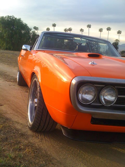

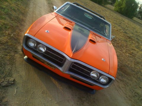

      Painted and driving
      I havn't posted for a very long time. The car is all painted and driving.Name:  firebird4.jpg

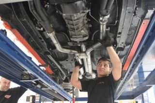

      I found some more buld pics.Name:  firebirdg.jpg

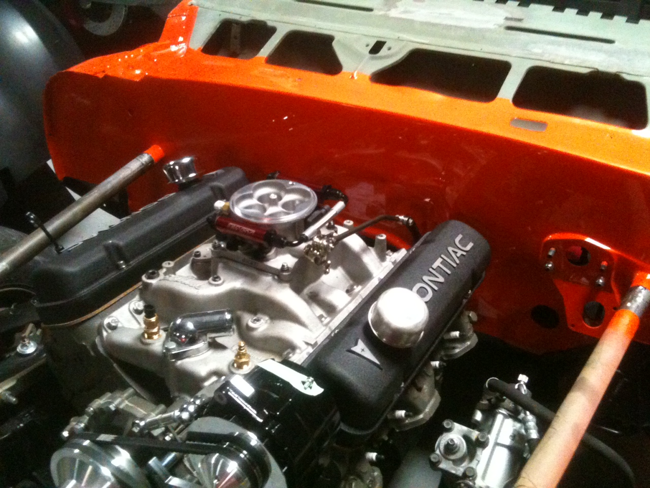

      The front suspension is all GWS coil-over. The rear is one-off based from GM A-body using GWS parts and coil-overs. So far it rides good. We havn't autocrossed it yet. The engine is a bad subject. We put is a pontiac 326, mild port to the heads, ez-efi, headers, intake, ect... About 10 miles into the car being driveable we spon a bearing, broke 4 rods and put about 7 holes into a brand new 7qt Moroso oil pan :( Right know we are bulding a pontiac 406 with alum. heads. I'll get some more pics
