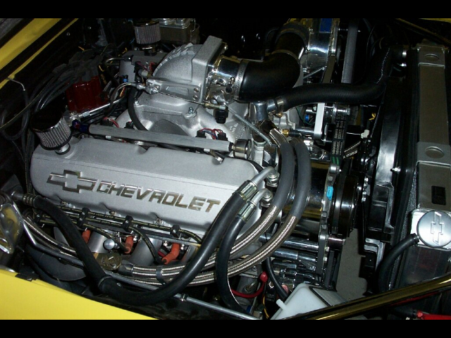

      Quote Originally Posted by trapin View Post
      Thanks Jody, I'll have to do some measuring when I get the radiator installed. One last question...what's the best way to mount it to the radiator that you've found? Got any pics?
      simple and cheap method, just bought some aluminum strap material and did this on a friends car:
      On my 69 I used some of the Be Cool straps:

      Thanks for the pics Jody. I'll have to look into getting some of those Be Cool straps if I go this route. I just have to see if the fan will fit on the radiator or if it's too big. I just heard something interesting today from an engineer at work. He told me the HHR fans draw a ton of air and don't use too much power and are starting to become popular with hot rod enthusiasts. Anyone else heard of this?
