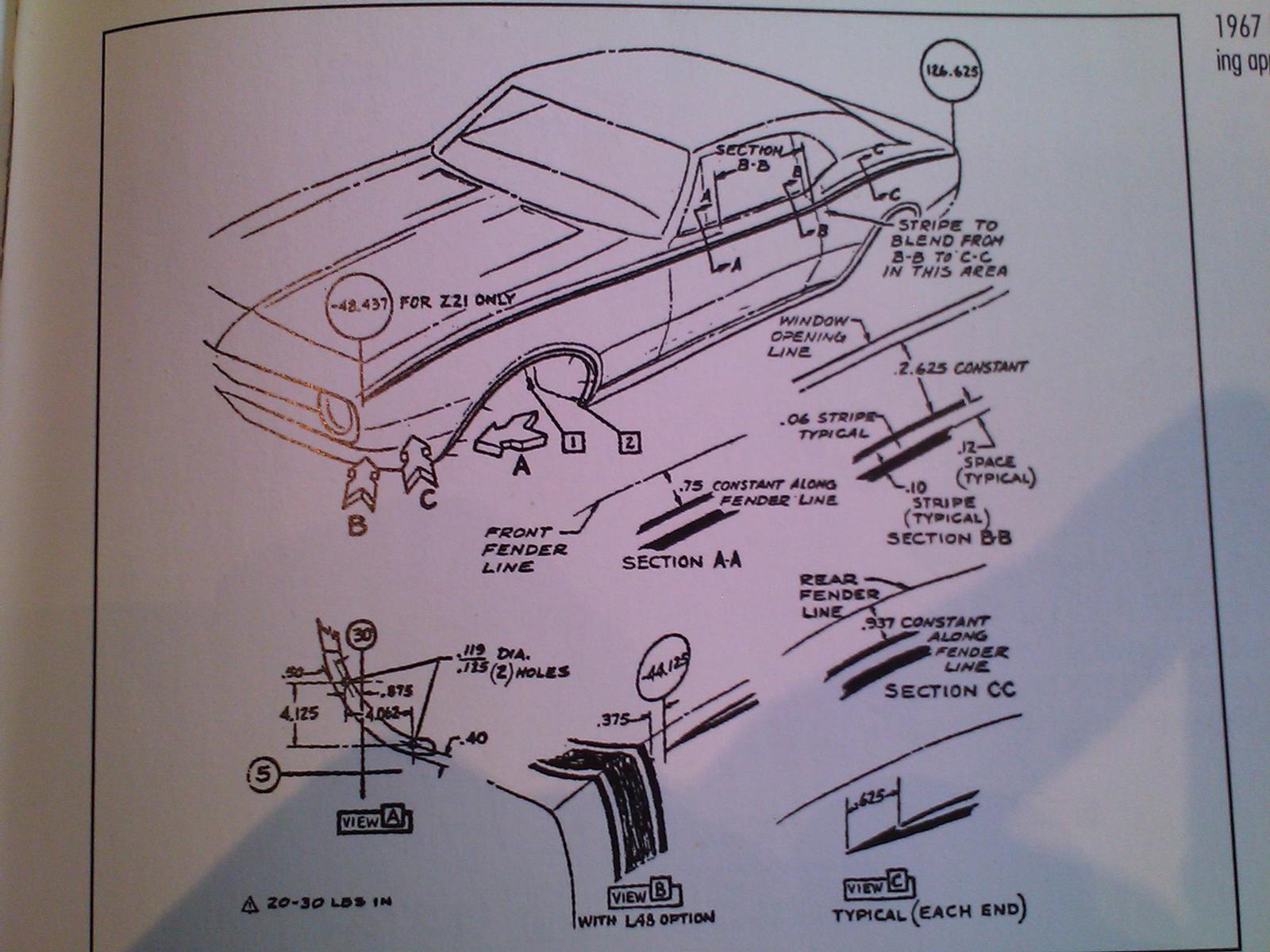

      RPO Z21 style trim group accent striping??
      Has anyone ever seen this striping on a camaro? and has a photo of it?
      Any ideas where to get a stencil of it?
      Thanks Erik
      Rockford Illinois
      3,949
      It is more like a pin stripe and can be found on a lot of camaros.
      A good pinstripper can do the same for you or a pinstripe kit will do it for less and look like it.
      The cars look good with them.
