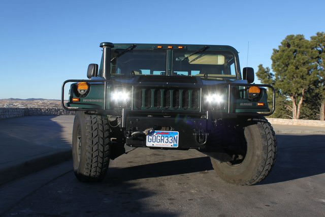

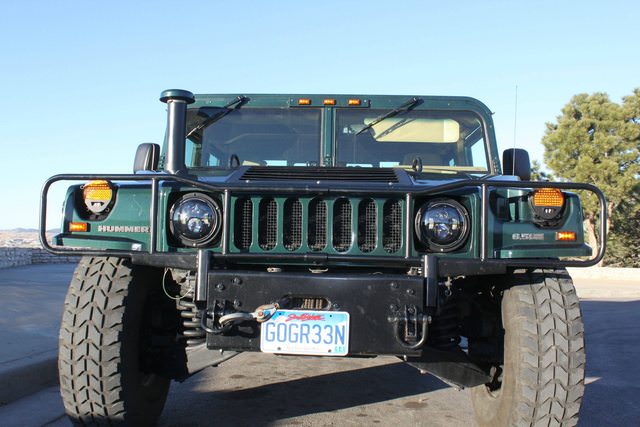

      I have the 8700 Evolution's on my Hummer and they're awesome!

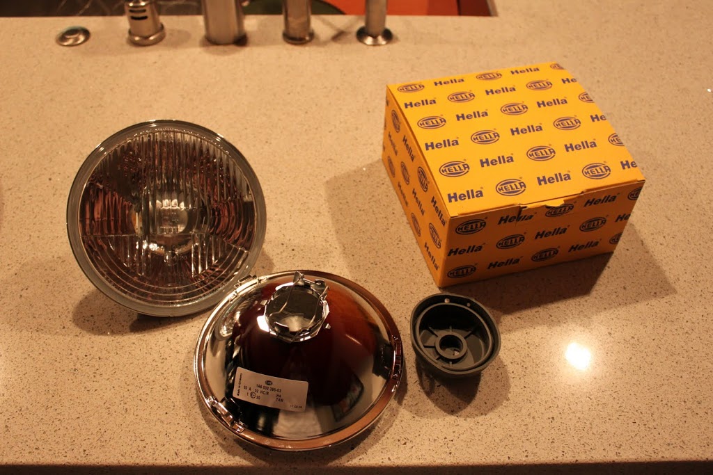

      Hella E-Codes are hands down the best traditional headlamp I have ever seen/used. I have them on my R1 Mini. Insanely bright, and will accept an HID kit with proper beam cutoff and will not blind other drivers...
      I need to get sets for my other cars, the Camaro especially, its like driving without lights! You should be able to find a set on Jeep sites...

      Try www.talbotco.com and http://www.danielsternlighting.com They both sell the composite light as opposed to the sealed beam which will allow you to add an LED bulb, regular H4, or HID but with the proper light spread.
      Both sites have Cibie brand lights as well. Whether it's Hella or Cibie, the way to go for "off-road" use only is e-code which will have the proper beam cutoff.

      Quote Originally Posted by Trevon View Post
      Those are pretty sweet looking man. Anyone know if these will work on a chevelle or el camino? Im sure they are $$ but interested in seeing what it would take to make work...thoughts??
