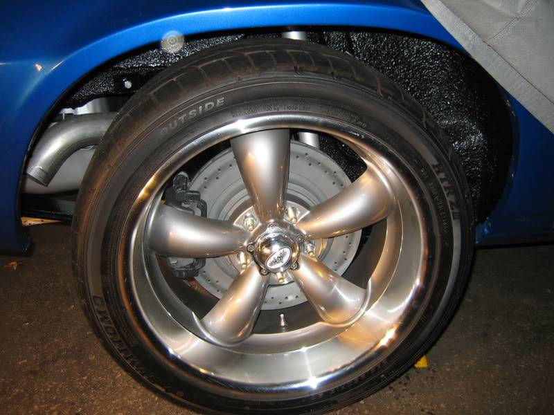

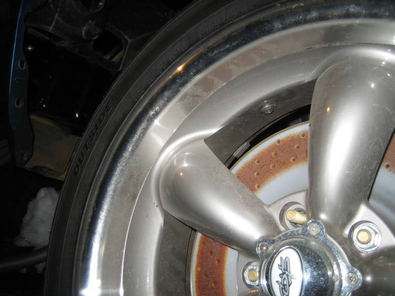

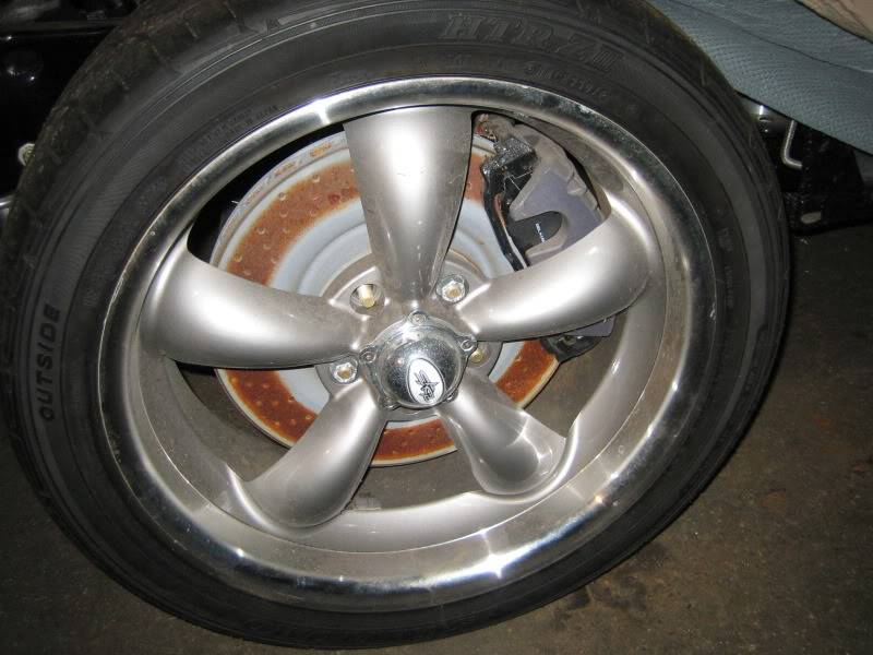

      I have kore 3's z51 kit on my car front and back with coys 18 inch and it just clears with a flush mount valvestem, but not with the valvestem cap on .and wont work with the valvestem in the pic.

      bmx1112, do you have any pics of the front wheels/brakes, thanks

      If you look in the DSE catalog, Chuck Hanson's chevelle has baer pro plus 14" system in the front, that's also found from his showroom page on Team Chevelle. First off I didn't realize that the coys valvestem was behind the spokes. I've never had any wheels like that, it seems that it wood be a PITA to adjust air pressure. Also if you get on baer's site you cant find a clearance template for the pro plus or even a T4 system the only one that is on their site is the extreme plus. BMX1112, what is required to add air to your front tires? I would also like to see a pic of your front brake setup. IIRC, the Z51 rotors are 13.4" in dia. ?

      They are the z51 13.5 rotor up front with the regular c5 caliper the valve stems you fill by threading in an adapter and then fill and remove the adapter.
