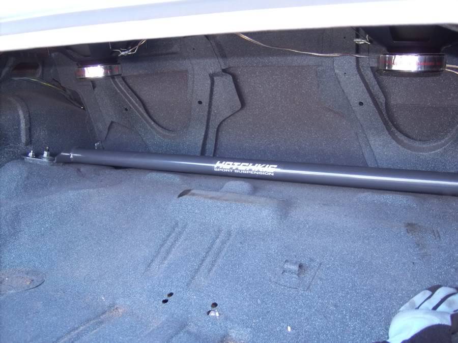

      If the purpose is to lighten your wallet, it'll work fine. Make the suspension work better, not a chance. The loads through the shock mount are in the vertical plane, attaching the two mounting points together does nothing to help. It could be argued that it would be better if the reinforcement anchored to the inner wheelwell, but the area doesn't flex with a shock load anyway. In the old days, it was common to support most of the weight of the car with air shocks, using the original mounts, and they worked just fine as long as they weren't rusted. Save your time and money.

      I put one on my car, at an event to feel if there was any change, and from just seat of the pants driving, at the autocross event I couldn't feel any difference, there might be some measurable changes, but at low speeds at autoX the car had no discernible handling changes, but it looked good
