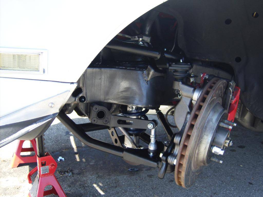

      Hey Chris! Brett ended up winning the event he won by 2 one hundredths of a second! it was a fun weekend(any time I can race with friends is a good weekend) the camber gain is awesome I have a test mule frame section that I mock things up on to see and suspension binds, angle changes, and I used the Tru-Turn and the ridetech arms with the guldstrand! the caster and camber looked fantastic, the Tru-Turn with the setup I running reduced the bumpsteer to so little I couldn't measure it
      heres my test mule frame section
      I can look at how components all work together before I decide on what to try

      Wow, the ridetech spindles with the Guldstrand mod, awesome, I assumed that would be too much camber gain, glad to hear it works well as I have trimmed the control arm stand for stock arm clearance with the Guldstrand mod so going back to the stock holes would require some re-inforcement. My current set-up is much the same as your old set-up so I'm very interested in what to expect with the Ridetech swap.

      the Tru-Turn will work with great with the mod, I'm sure someone will say its to much(show me why?), but I'm running it and its proving very fast, I mocked it up on the test mule and there wasn't any binding at any component and now with weeks worth of testing and racing it has crazy amounts of turn

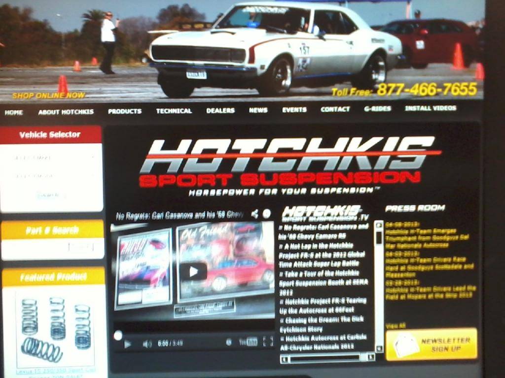

      This is cool! Hotchkis used my little car Plain Jane as there header banner on there website AWESOME!

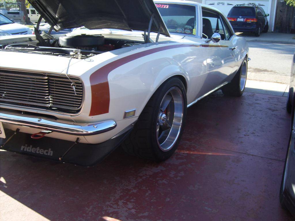

      heres the car at ride height

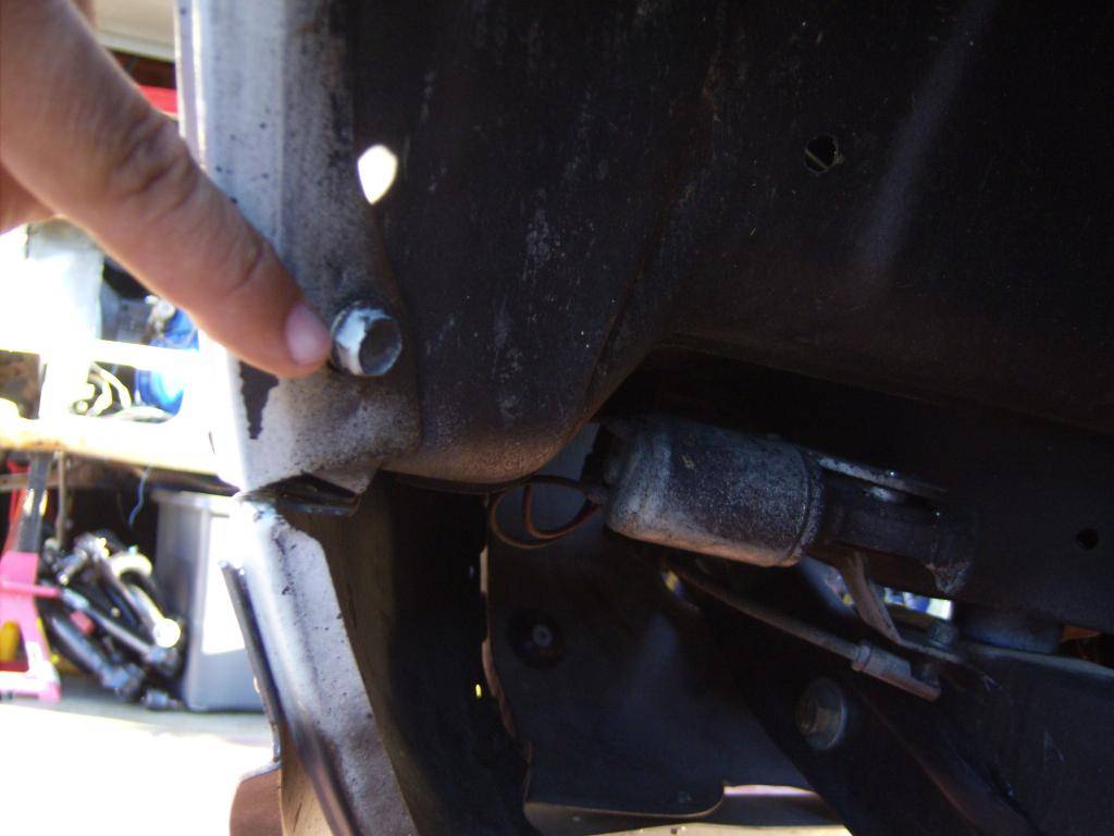

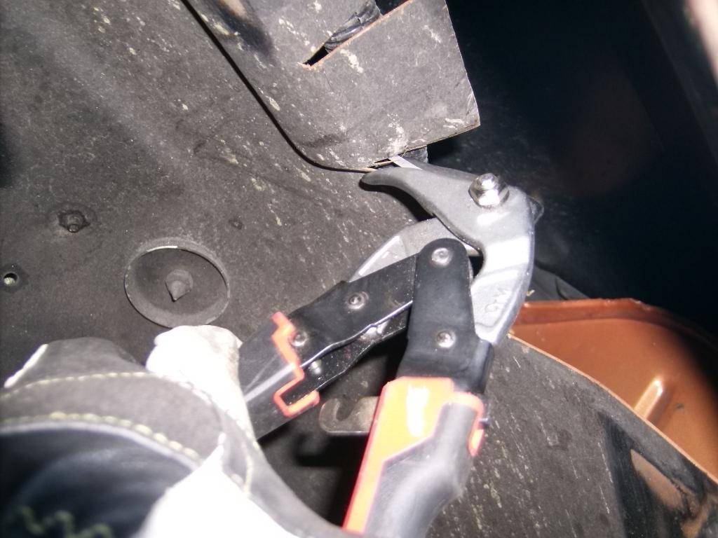

      remove the inner fender bolts all the way around
      just leave the front one for now
      and the lower rear will need a small button head when your done or you can leave it out if you want

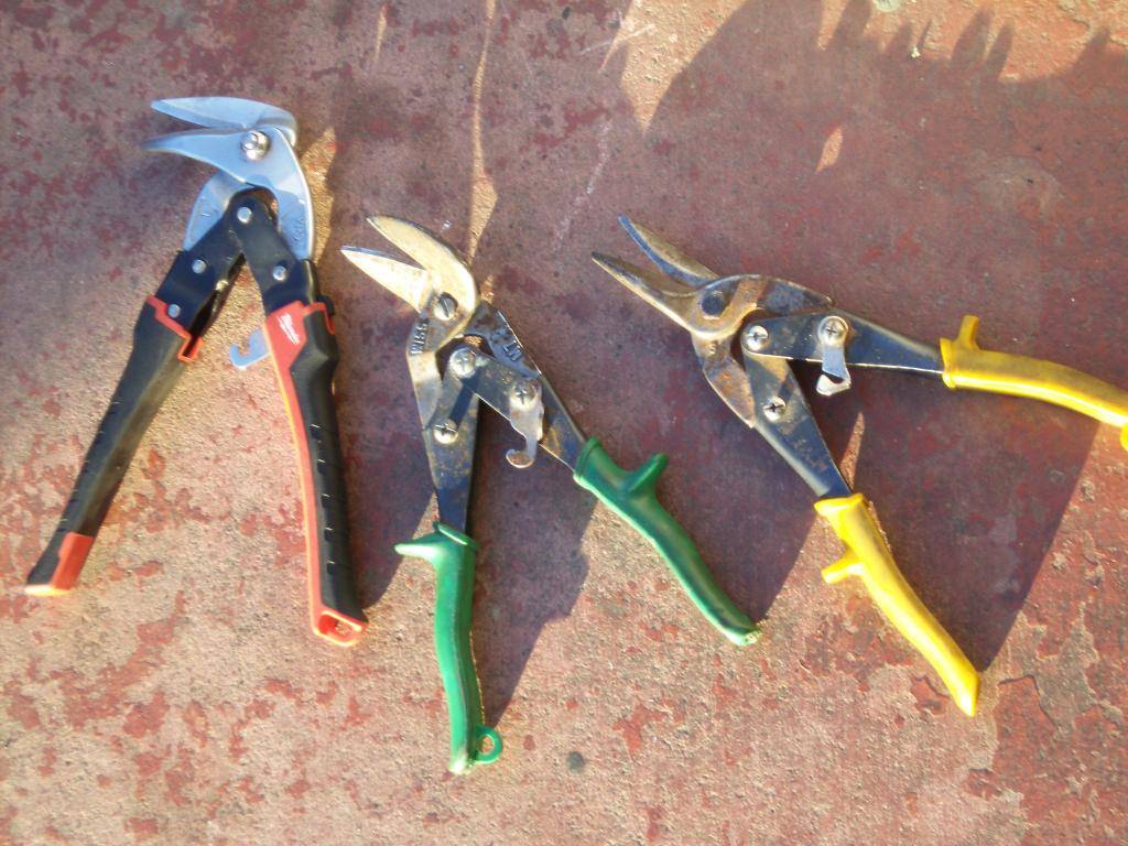

      you need a couple of these and some strong forearms or cut it the way you want

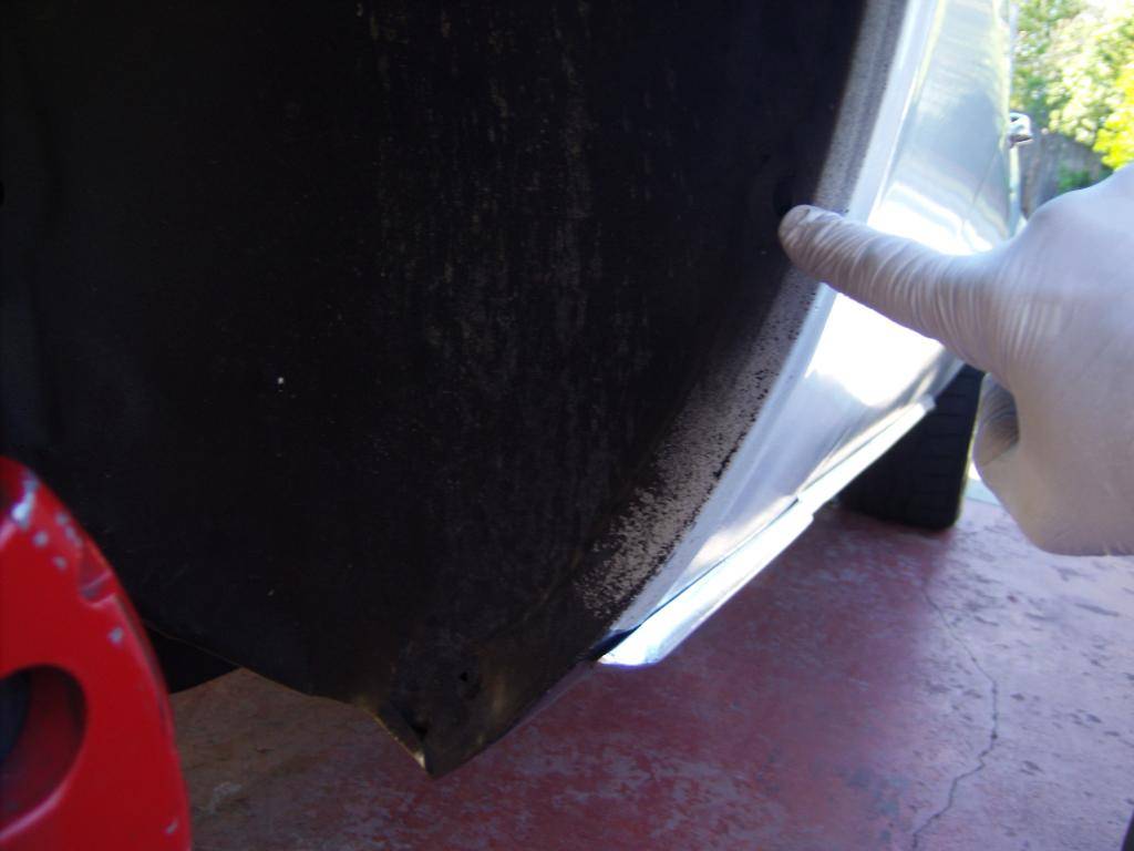

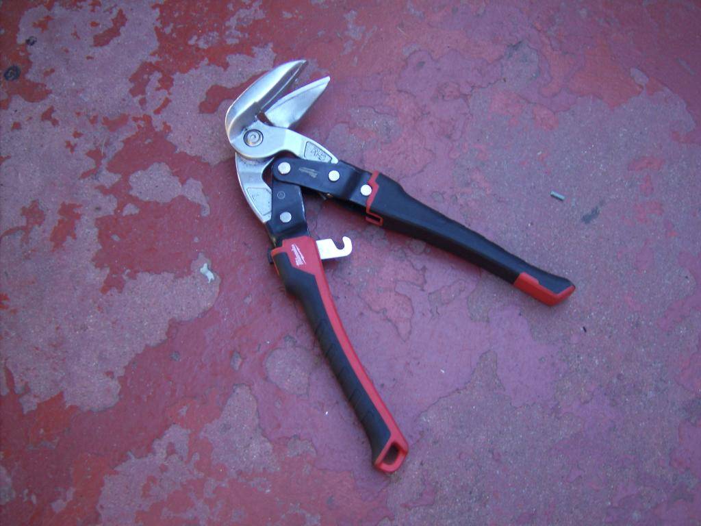

      you can see were it rubs or just measure the center of the fenderwell and measure 16" x 7" rectangle these are my favs for basic trimming
      drill a hole and start trimming,,,,,

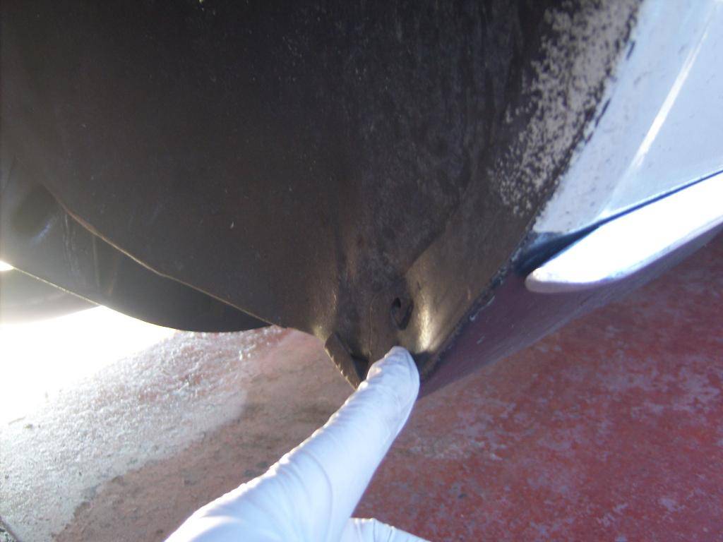

      instead of an empty hole I left half of the tin in place and bent it backwards to hold the wires and hoses between it and the fenders here is how the hole looks after trimming and rolling the fender edge, see 16 inches
      heres the 7 inch measurement

      Car looks great Rodney and congrats on the Hotchkis web site banner. I'm going to ask you alot of questions when I get started on my Camaro build.
